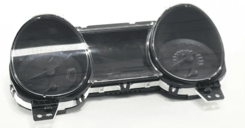

This is the replacement part. Not that expensive.
Analog Speedometer Cluster Lens

Its hard to tell from pics but is there actually a plastic lens that goes across the back of this in between this and the speedo? Or is it just the circle chrome bezel that you look through?
The lens is all one piece from side to side. It's actually a relatively easy process. Highly recommend having an interior panel trim tool set, I bought one for $8 on amazon and it was a life saver. I used this video and it walked me through step by step.

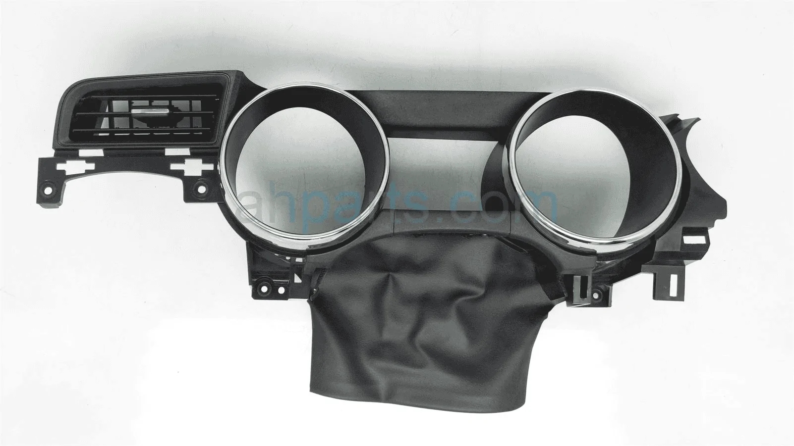

I agree, a little hard to see. But if you zoom in on the pic on Tasca's website you will see there is a clear acrylic lens on all three display pods. Here is a picture of the lens part FR3Z10890A attached to the speedo gauge:
This is the part that has the chrome rings and sits in front of the clear plastic (totally different parts):
Cluster Bezel
Cluster Bezel
Ah now i understand. Thanks. I ordered the trim removal kit and will get get that lens today.
