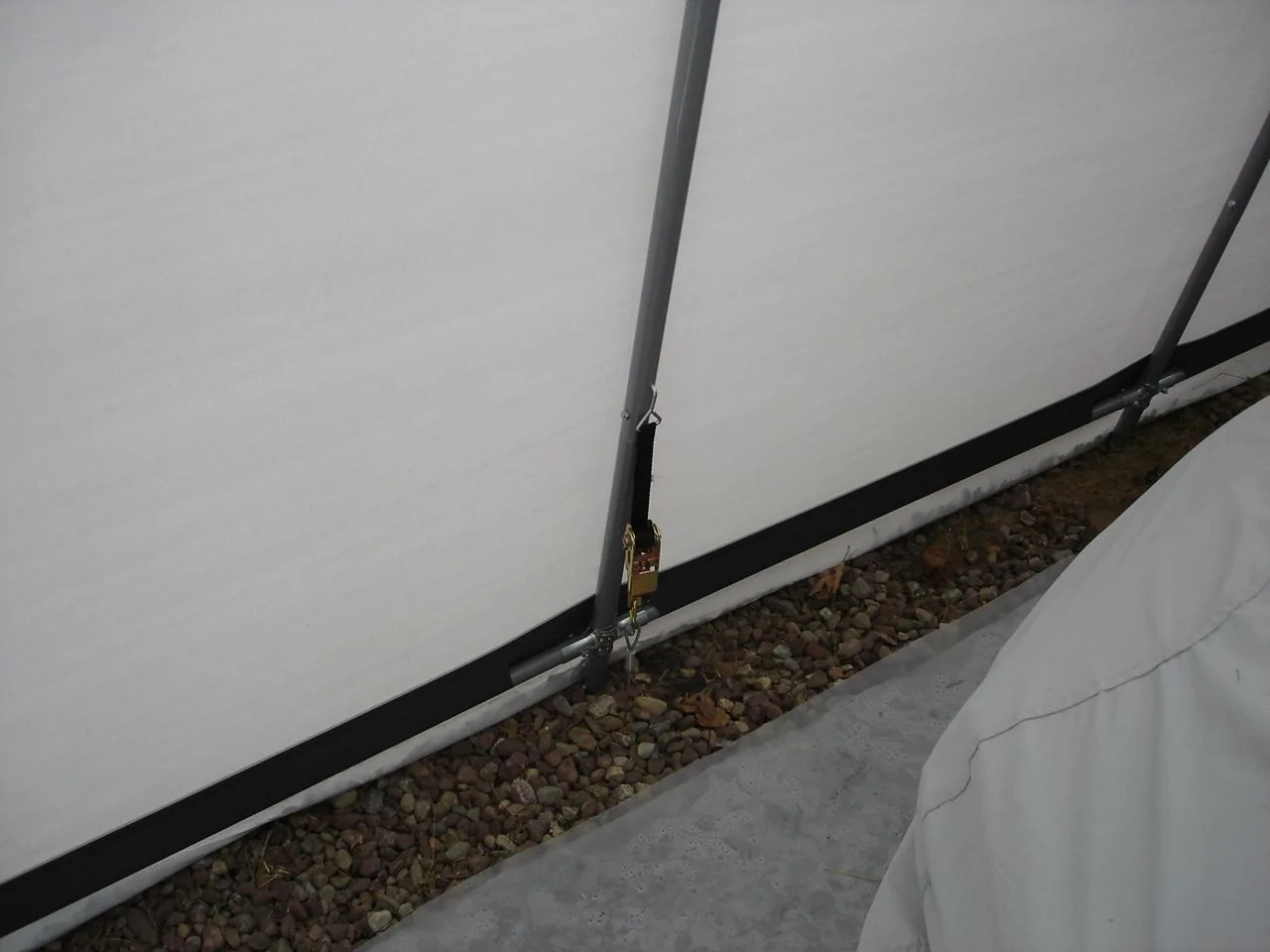

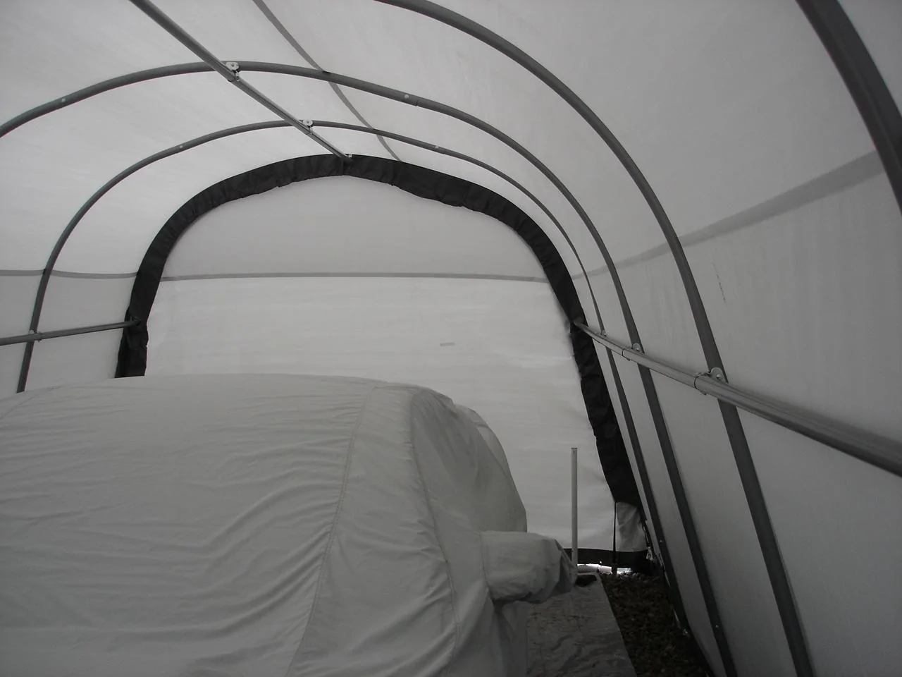

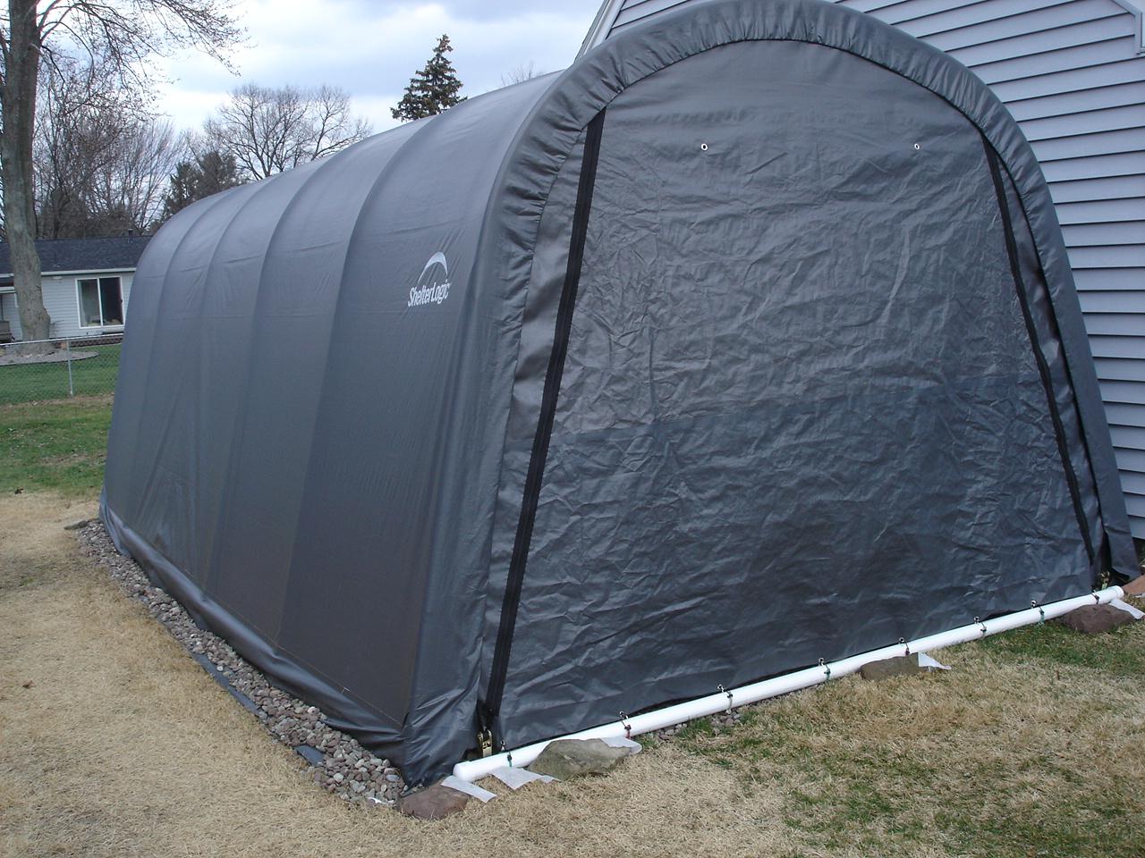

Do you have any pics, besides the one the manufacturer provides?
Here you go. I put crushed stone underneath. Very sturdy garage, ratchet ground anchors are shown in last pic, comes with 4, I bought additional for extra anchoring. I added PVC pipe (filled with stones & capped ends) along with grommets to garage to prevent front & rear from rubbing on stone floor & ripping due to high winds. For my winter setup put plastic sheet down first & bounce dryer sheets inside to deter rodents. Covercraft cover, crack window, pull battery, tinfoil in exhaust, stabil in fuel, good till spring.
