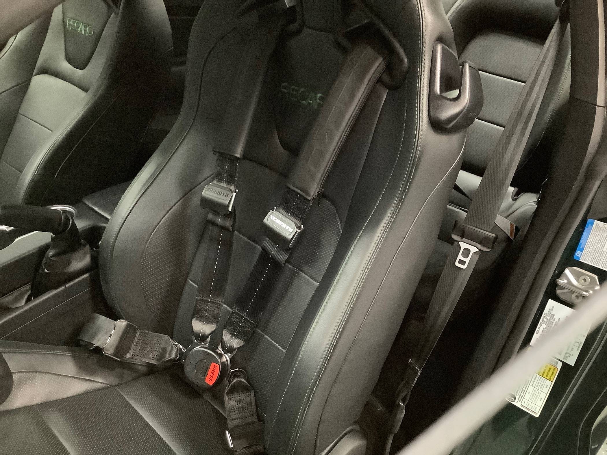

I know there are threads related to this, but was hoping some owners with Recaros (any model) can chime in. Schroth has an anti submarine harness that is safe in a crash without a hans because of the way the fabric tears away, so I'm told. I'm not installing a bar and these are to be bolted on a point somewhere behind the back seats. Anyone? Thanks for the feedback.

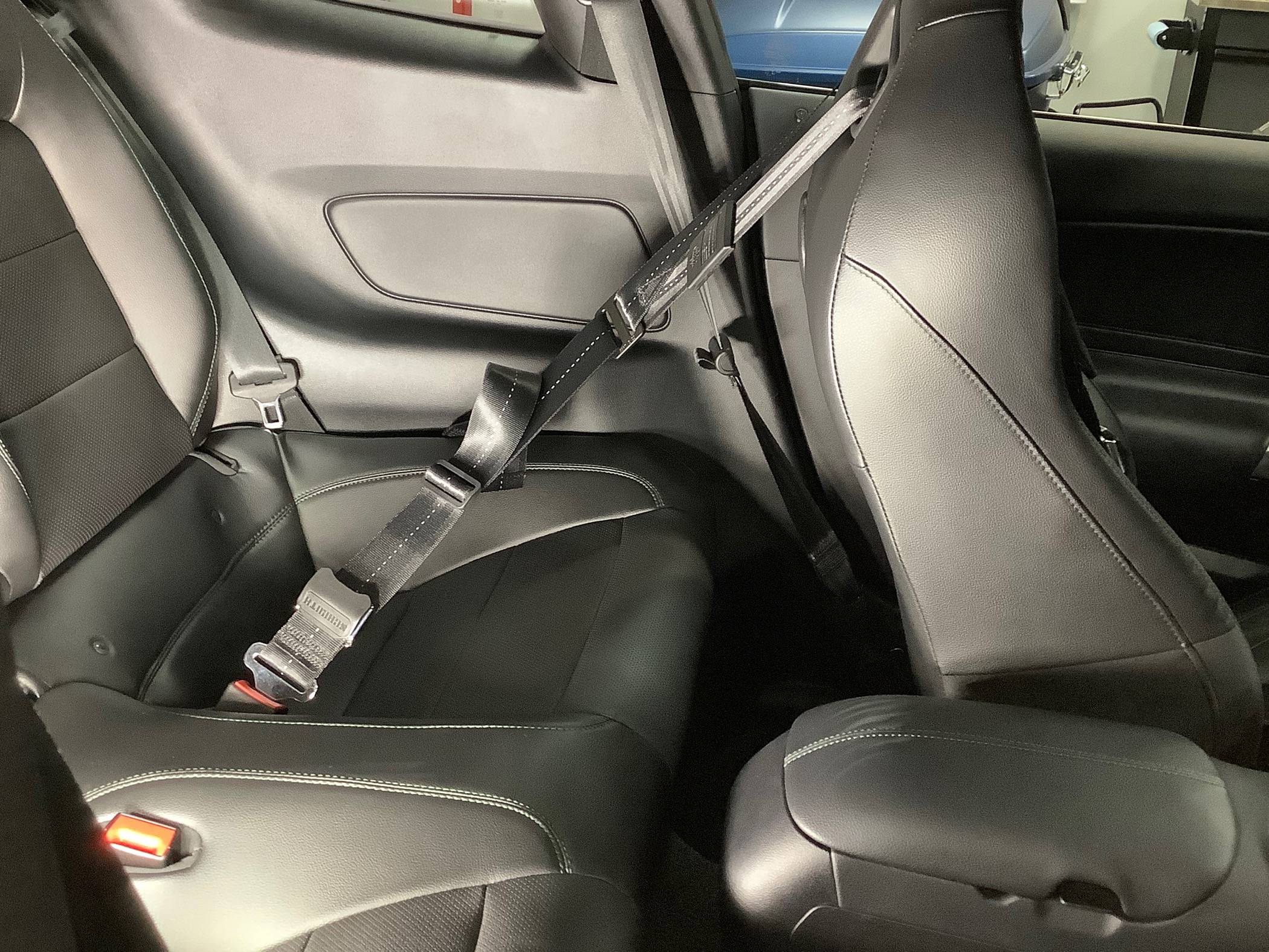

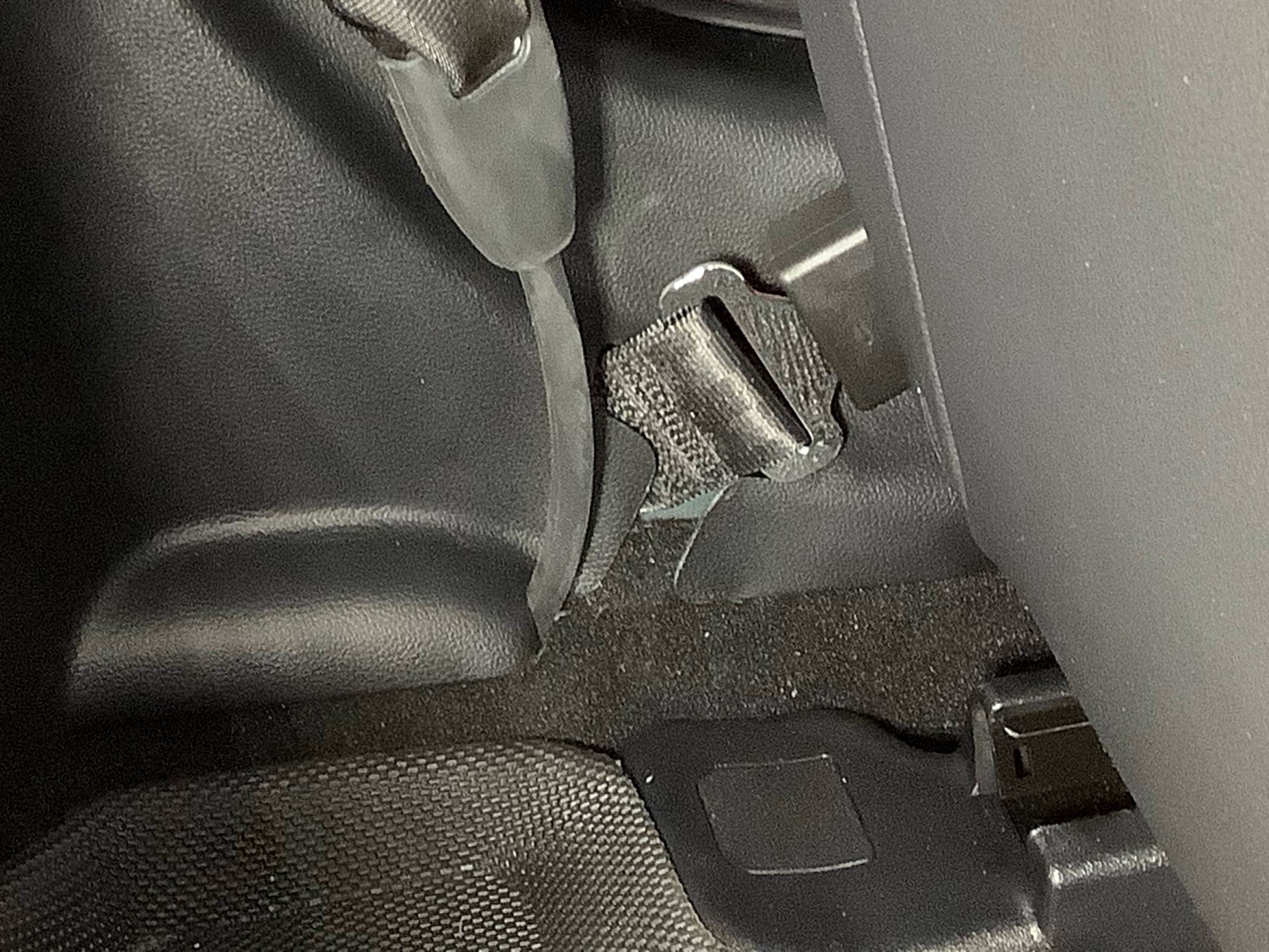

2 attachment in the rear. One uses the oem buckle. They provide the other buckle to place on the other side of the rear seat.
So for the rear you need to remove the seat (just lift it from the middle pushing the clip)
And an impact or to remove the T Bolt on the otherside and slide inside the shroth receiver.

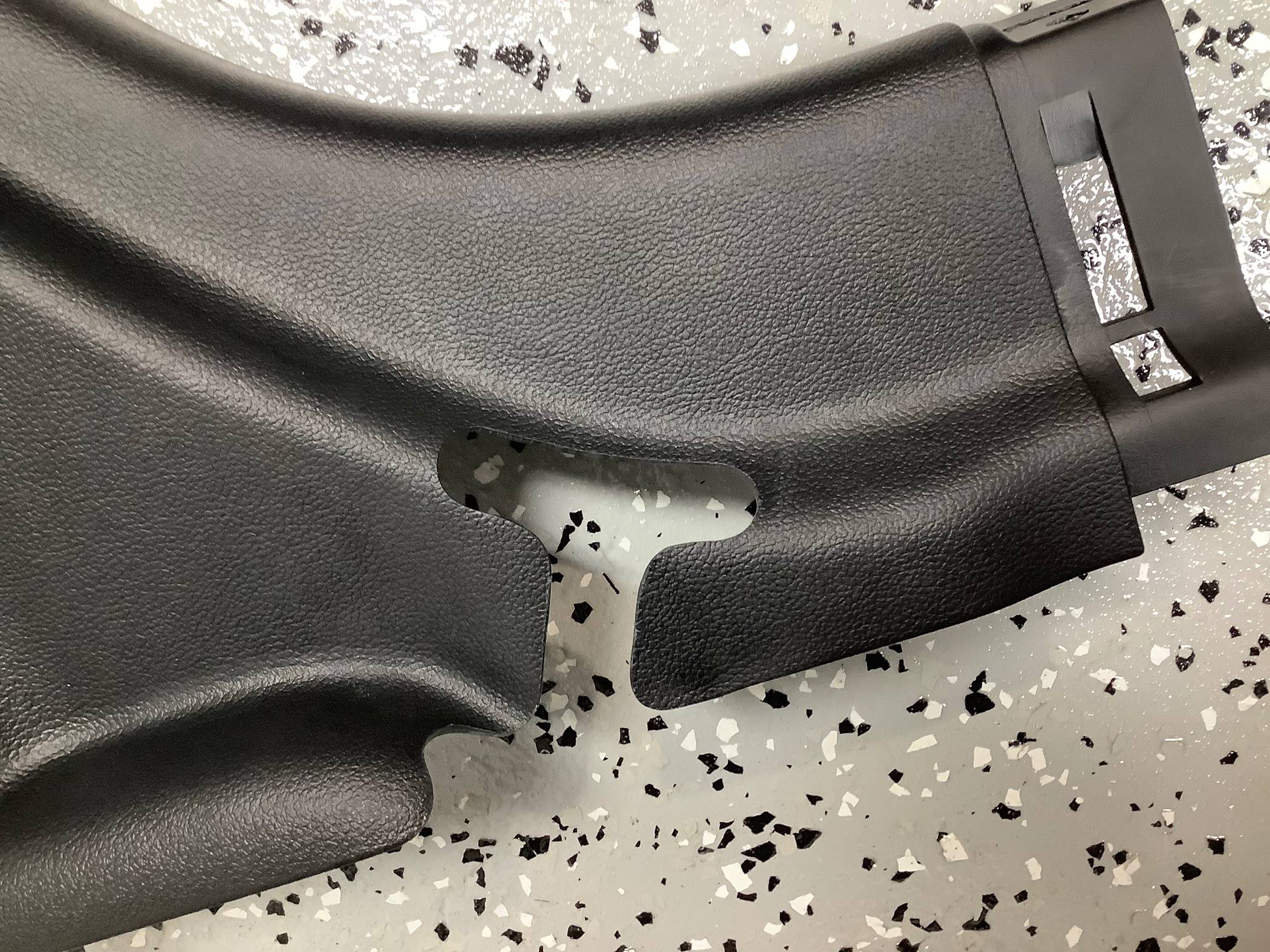

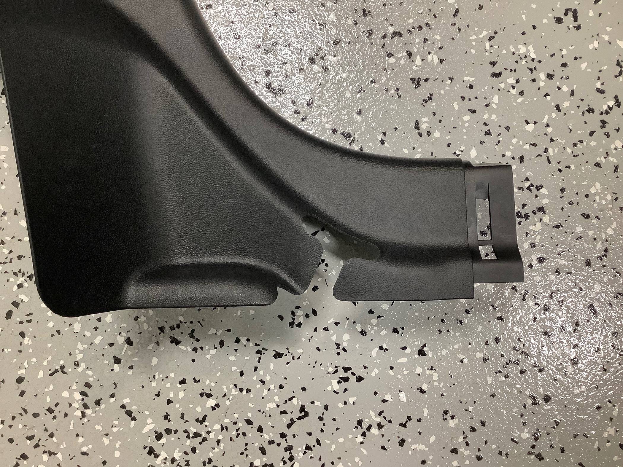

The left one require very small trimming of the plastic covers the lower t45(I believe t45 or t50) for the seat belt anchor. U remove the bolt slide in the seat bucket from schrot and bolt back. That's it.
