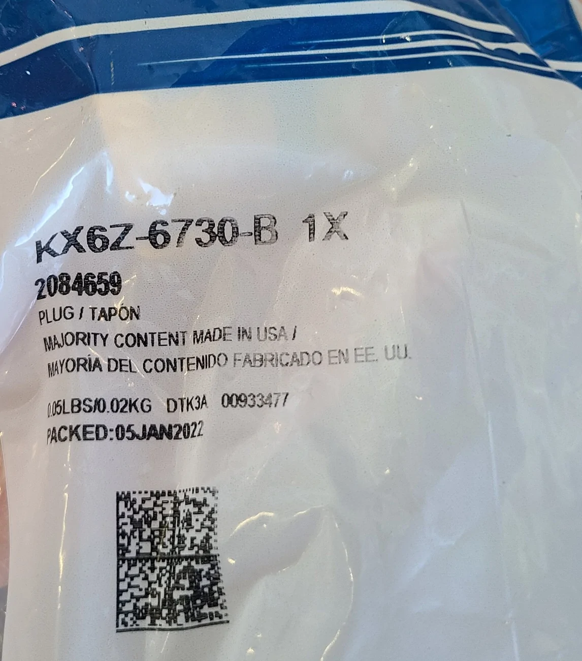

If you haven't changed your oil before, I'd look at at least one video. It's like unlatch, quarter turn and then it is free.
PN# for the factory yellow plug.
