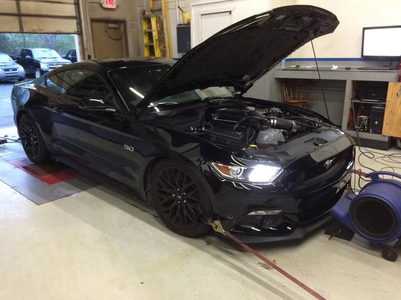

The car on dyno. There was more fans behind the blower focused on the heat exchanger
