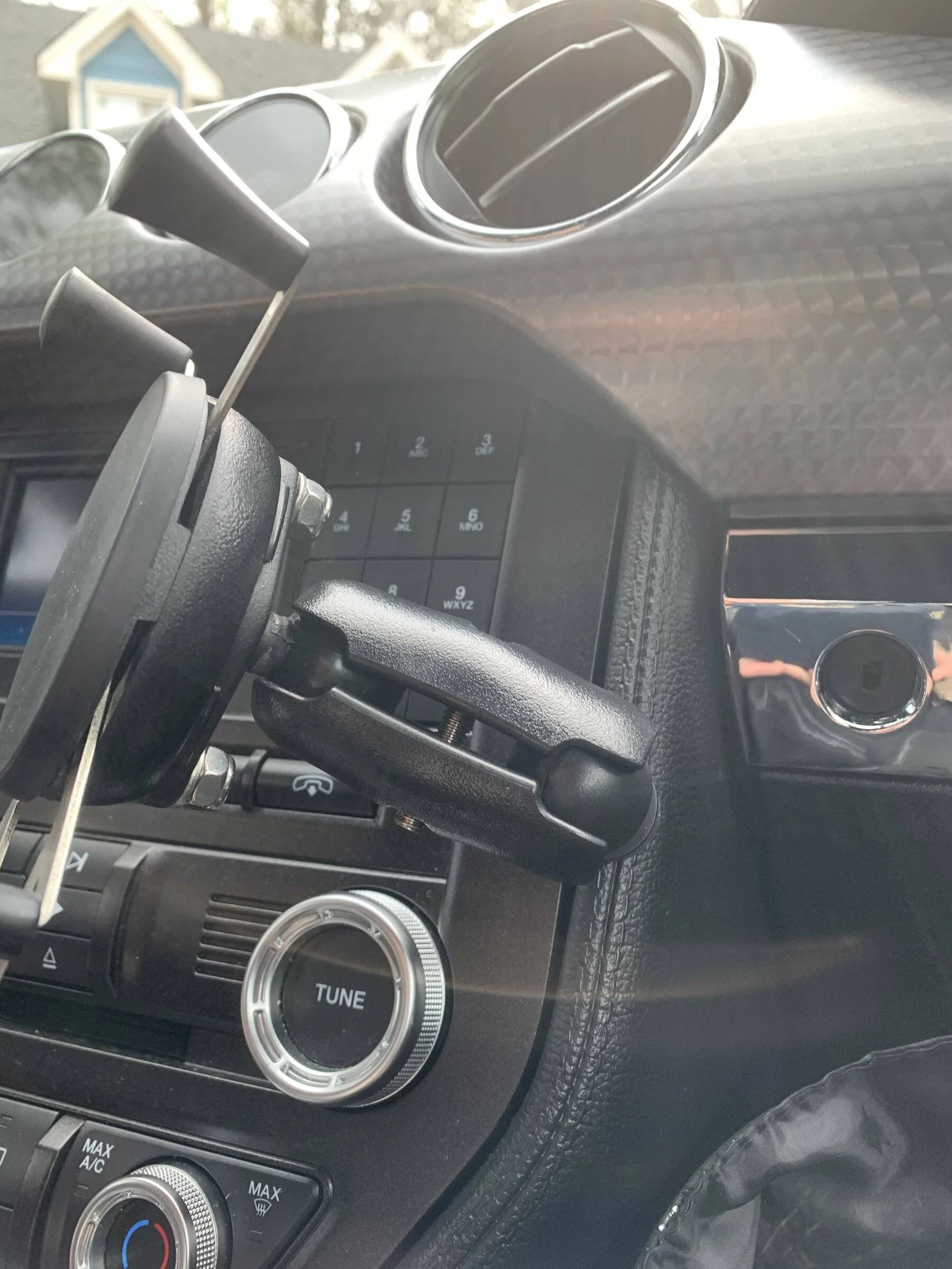

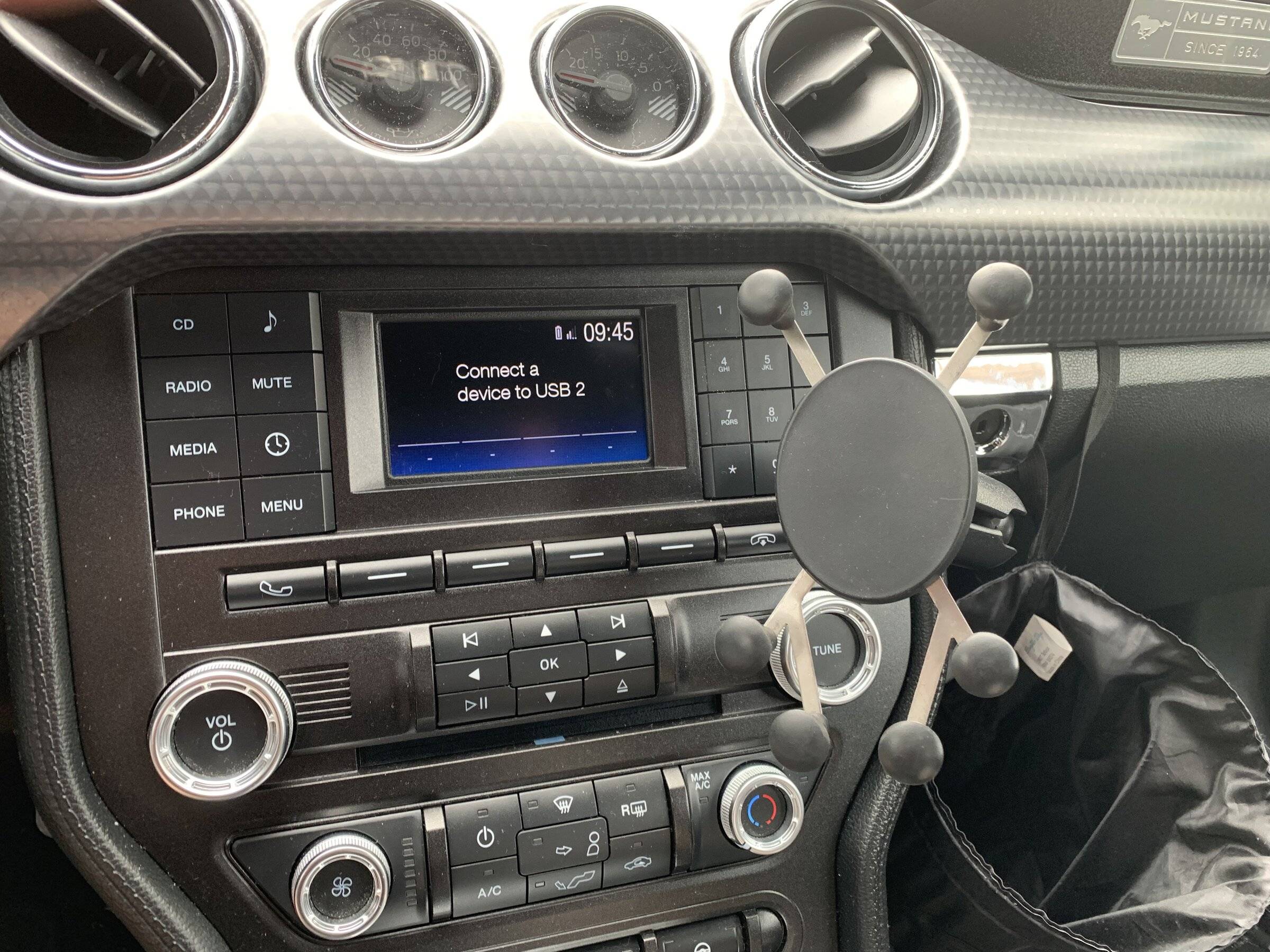

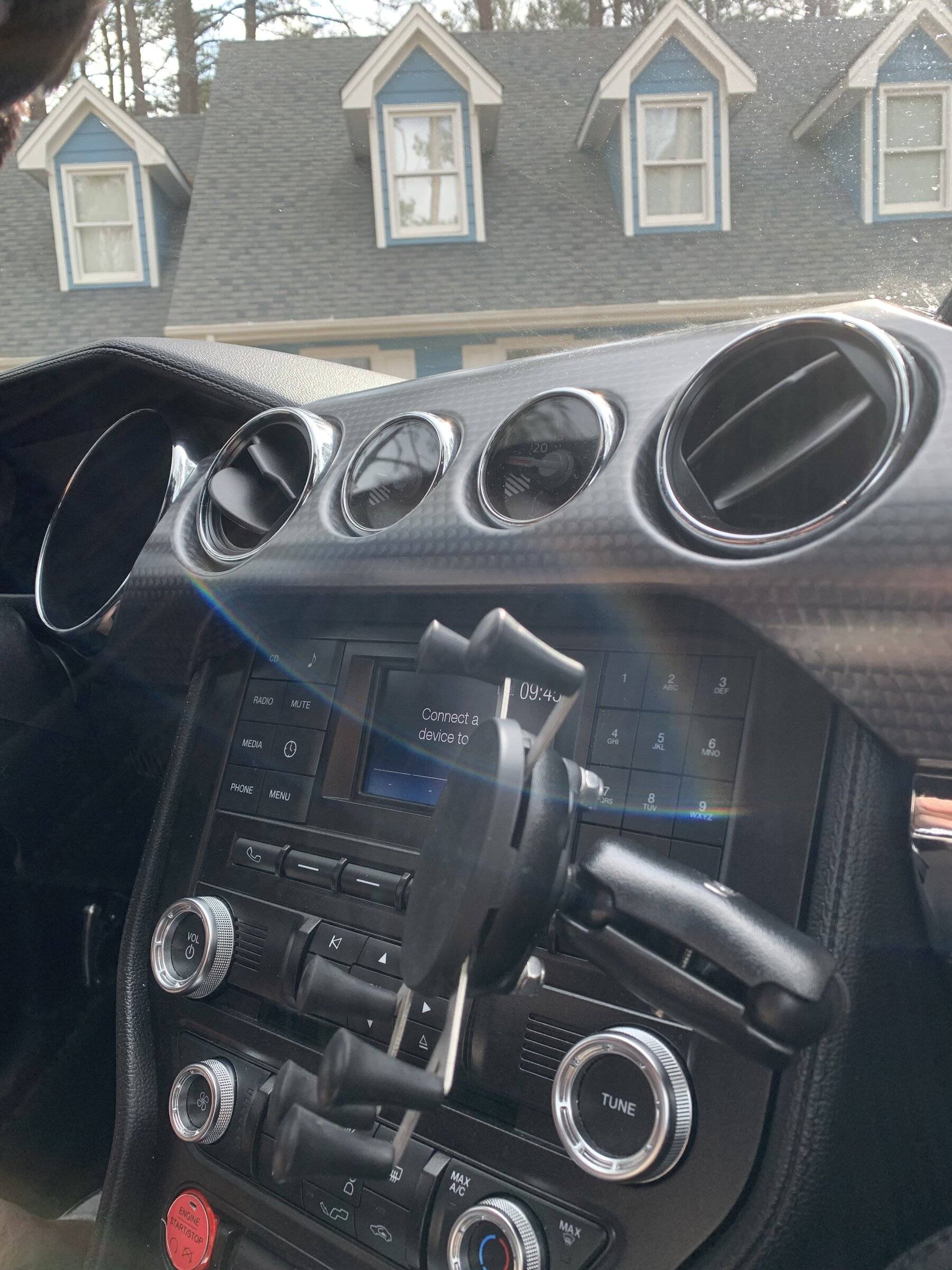

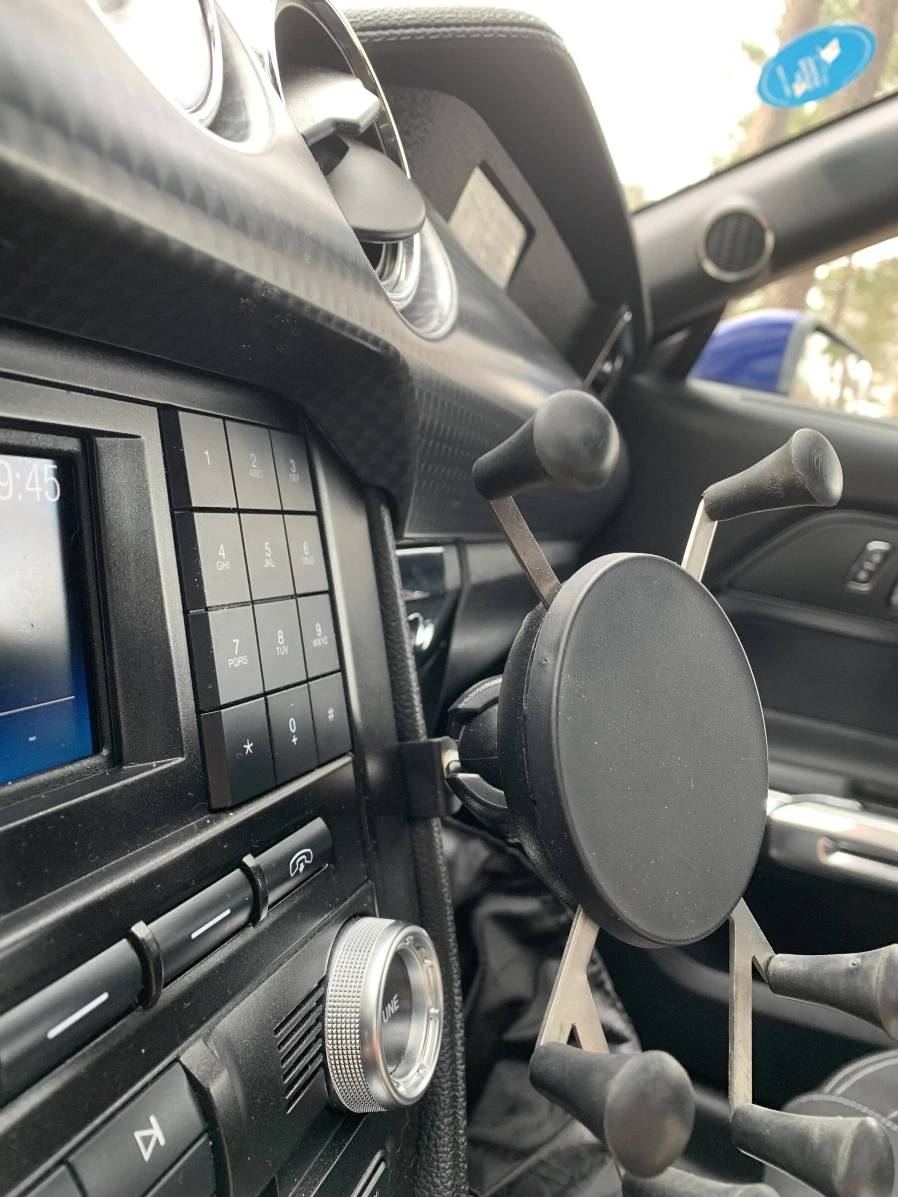

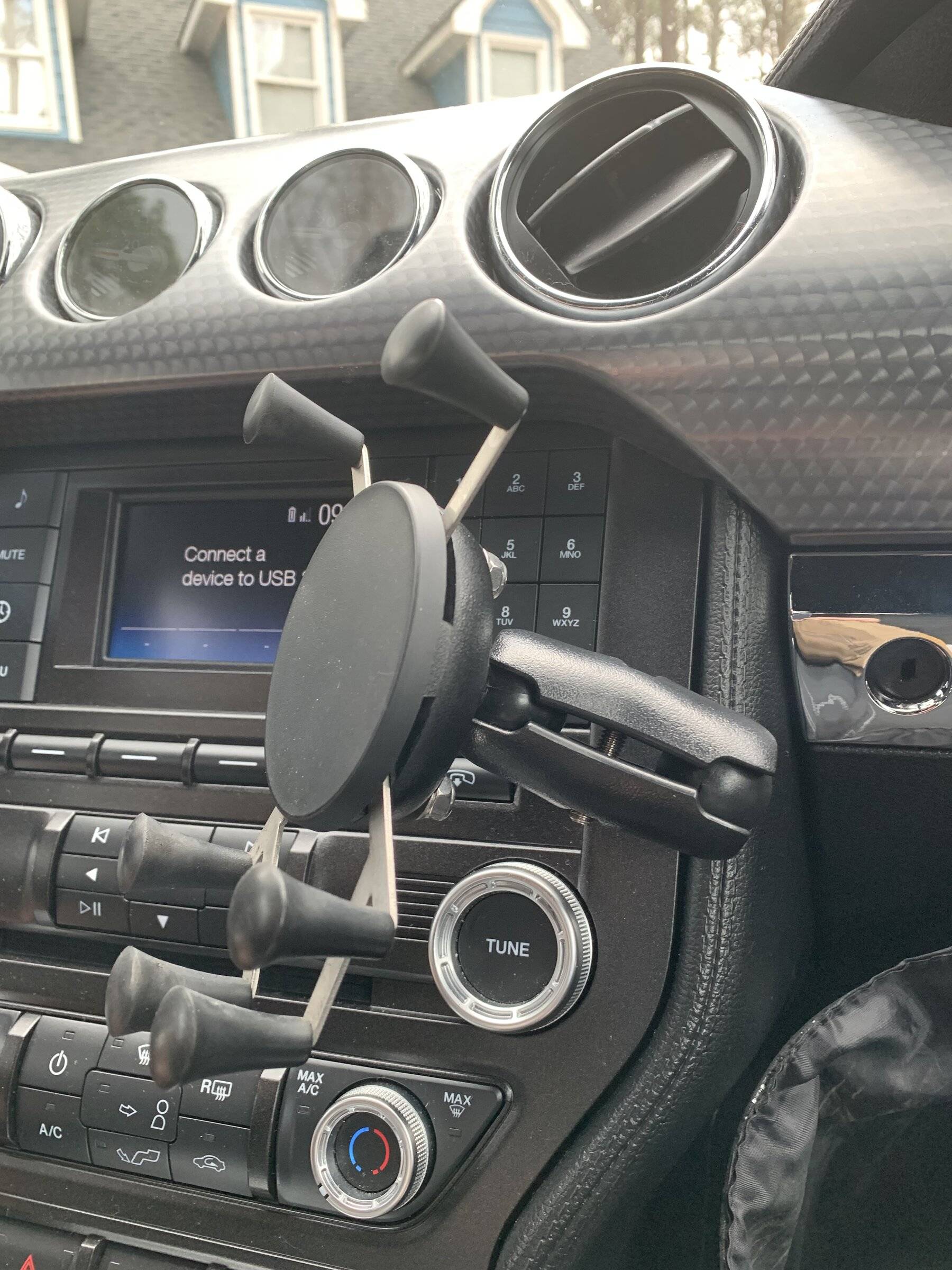

I recently bought a Course Motorsports phone mount. I got just the bracket and mounted a ram ball on it so i could use one of the many phone holders that I use on my motorcycles. This involved Getting a ram ball with mount stud, cutting off the stud and tapping a hole to fit the Course Motorsports bracket. I used a star lock washer to keep the ball from rotating. I have a Performance Pack car with the base stereo. I couldn’t see spending 1800 to upgrade my stereo to sync 3. So I replaced my speakers with Infinity Kappas and through Forscan took out the cutoff. Now with the Kappas the sound is pretty good, my phone is mounted where I can see it and I don’t need synch 3. The bracket does wiggle a little bit but that was kept to a minimum by using a shot ram arm.

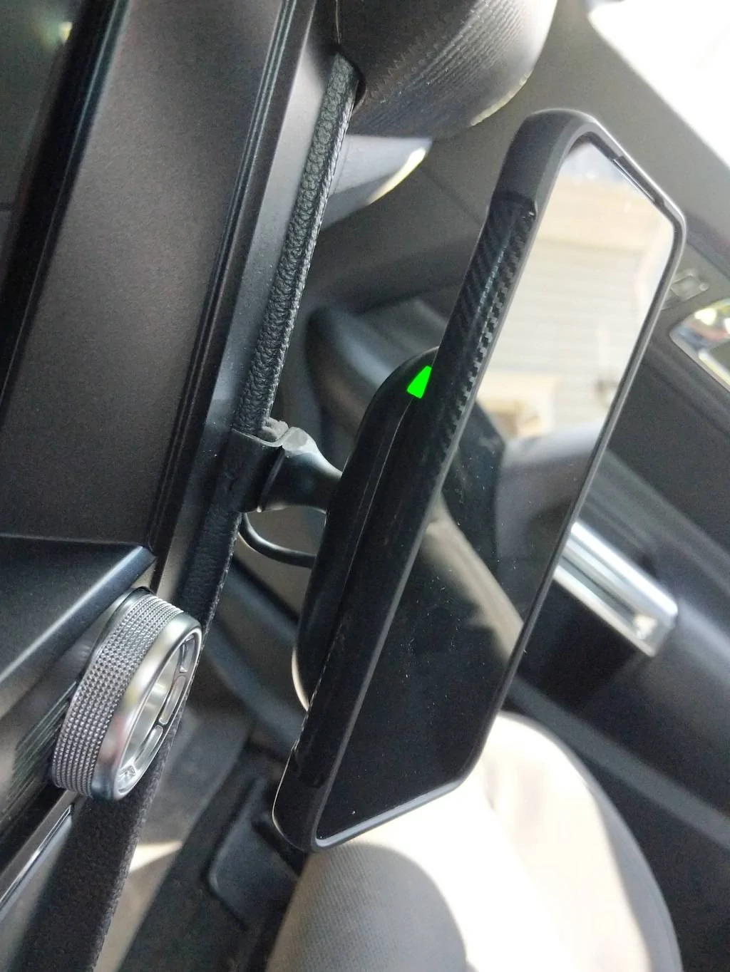

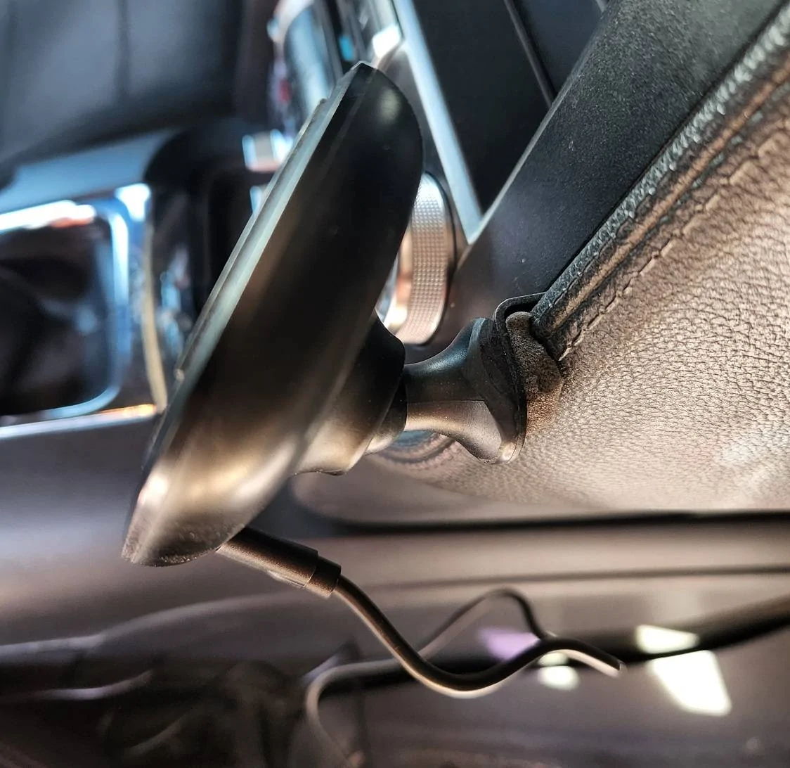

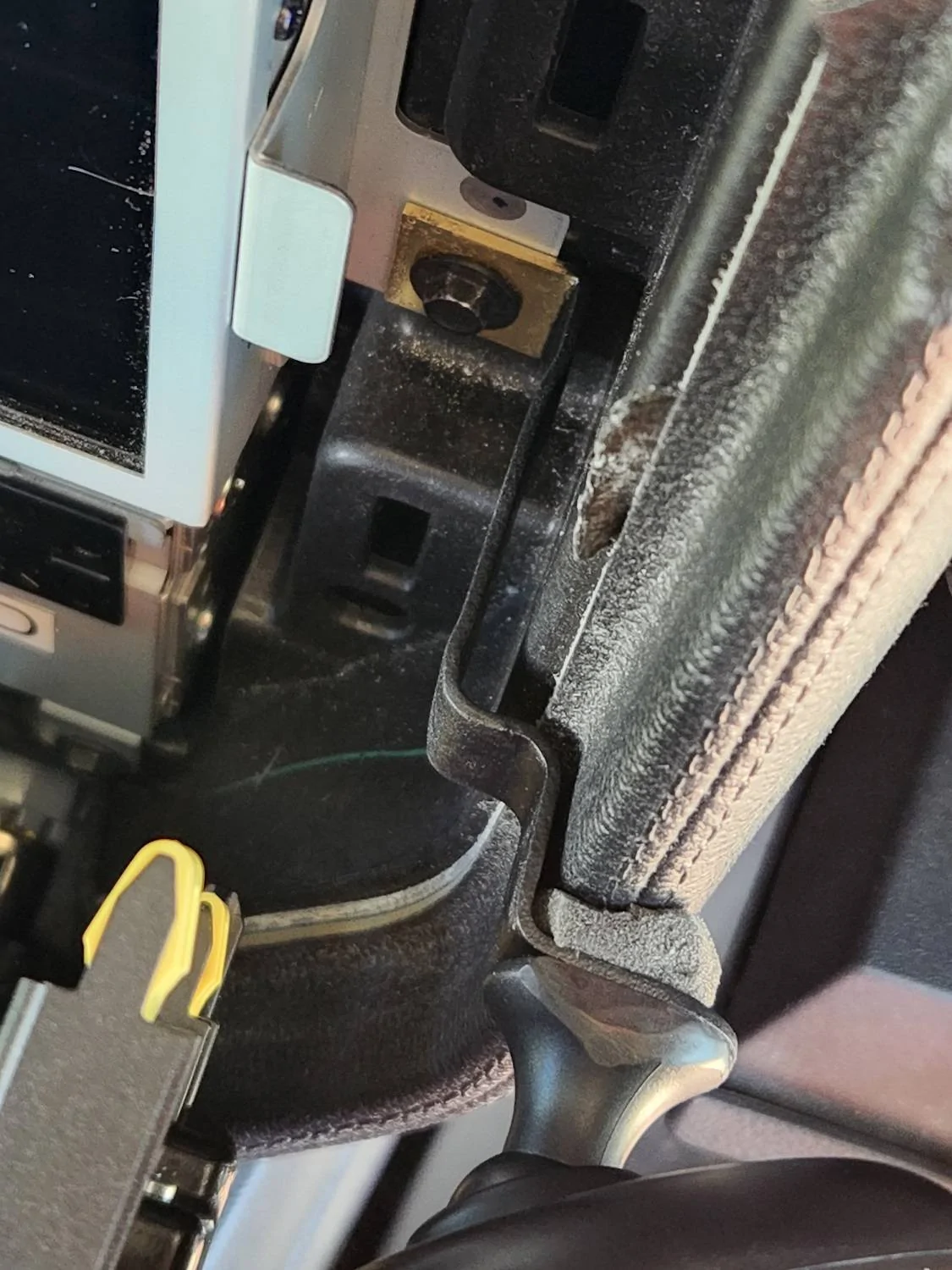

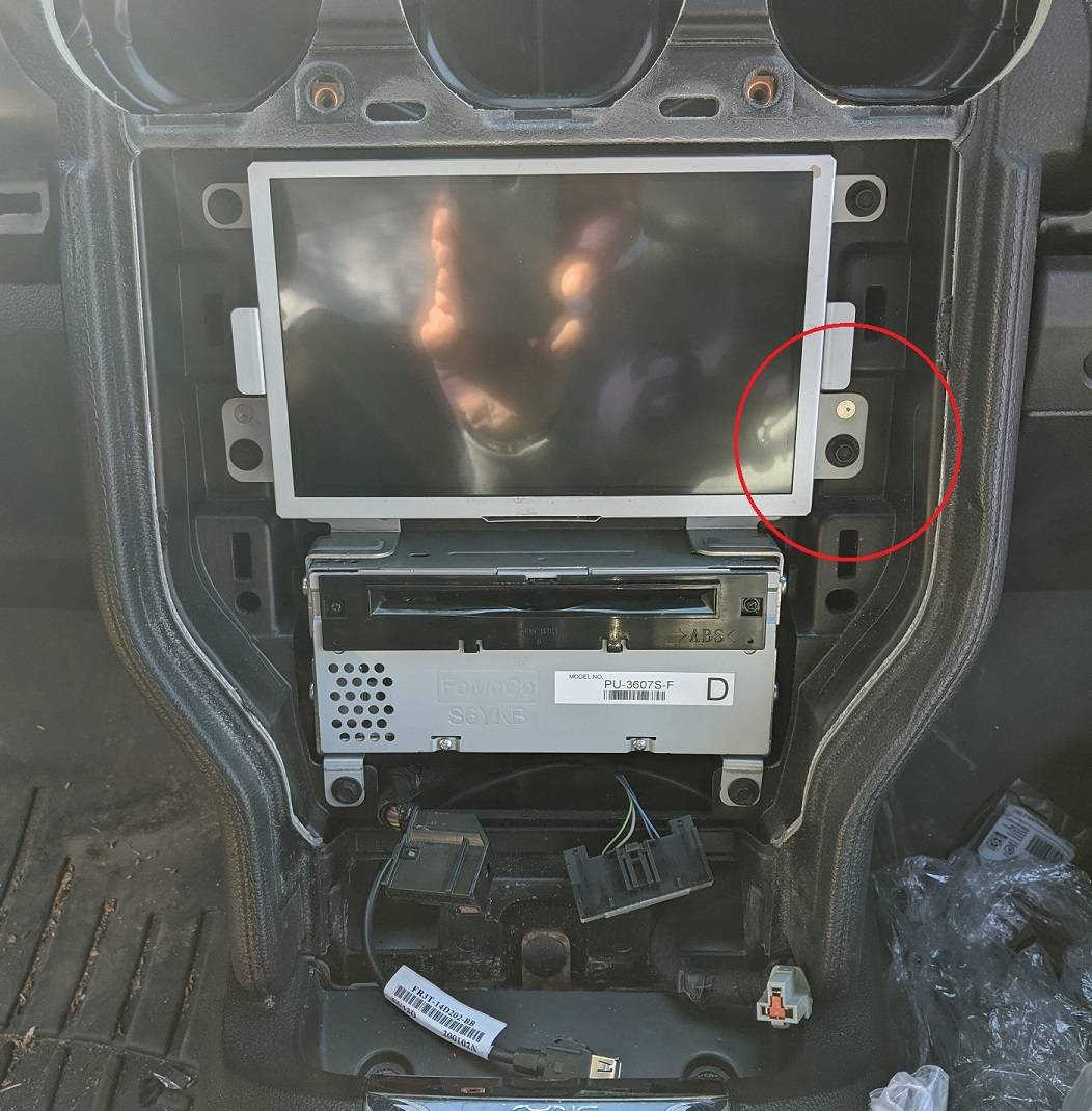

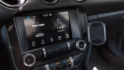

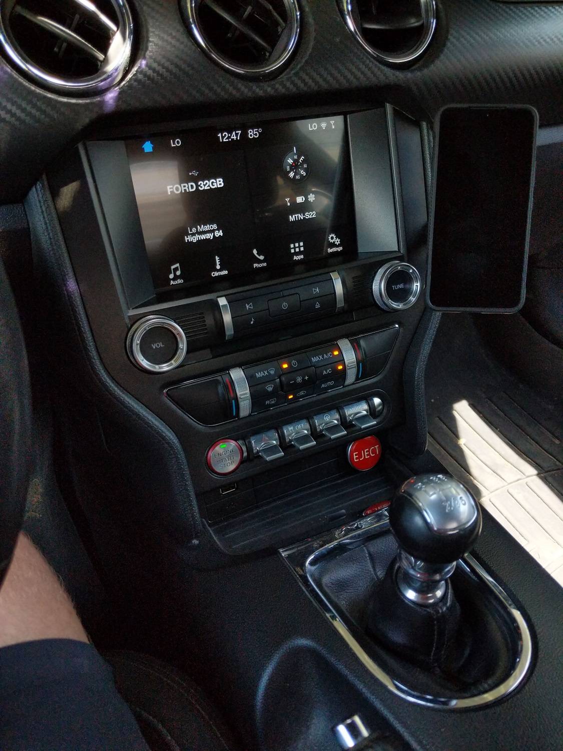

Recently completed my custom install (based on the "DirectFit" phone mount), and I gotta say..
Easily the sturdiest, cleanest, most-minimal phone mount I've ever had! Not bad for $10, and literally supports ANY mount or device you'd want.
Mine was made to work with the iOttie iTap2 wireless magnetic charger, and I couldn't be happier.
Happy to break down the materials ($5 brass billet + $5 universal 17mm GPS ball mount), but it's fairly straightforward / non-destructive, and uses only stock hardware. :blush:
Did I mention it's clean?
I'll do a full write-up if people are interested. I can probably draw up a template, as well.
