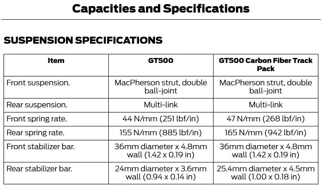

The factory CFTP (base is different)front is 36mm with 4.8mm wall, rear is 25.4mm with 4.5mm wall.
To clarify, the factory front bars on the Base and CFTP are identical. Only the rear bars are different.

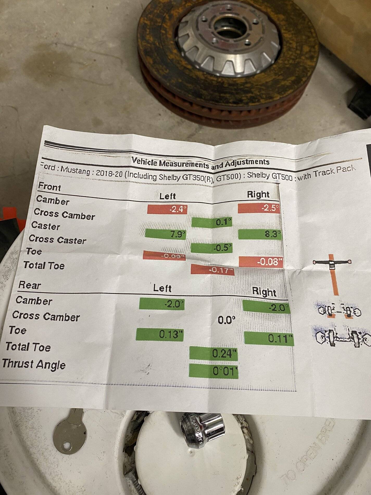

This is one of my alignment sheets. I believe I’m running more like 2.7 negative up front now. I was out changing brakes and flushing brake fluid and came across this.
I’m sure I’ll do another alignment here shortly to make sure everything stayed where it’s supposed to be after several track sessions.
