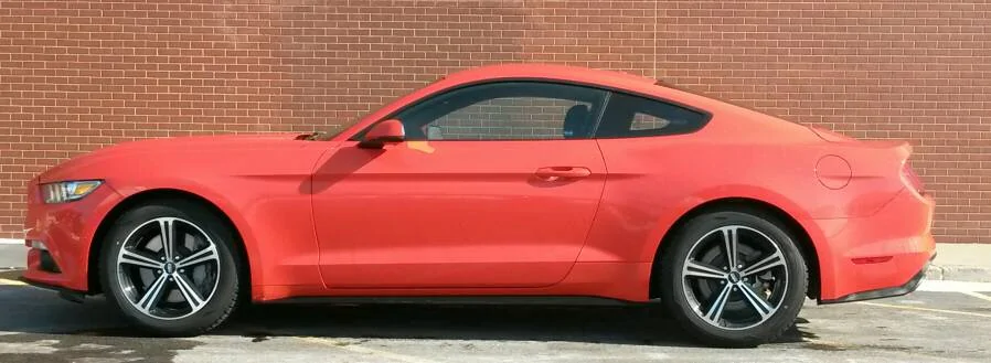

dgc333
Dec 6, 2014
1,637
461
MA
15 Mustang Ecoboost Premium
Sweet, so I can fit 18's over the EB PP rotor/caliper combo?
Here is my Ecoboost Performance Package with my 18" winter setup

Thank you very much for posting this. Any chance you could close up on the wheels showing the calipers?
I wonder if anyone has a set of PP calipers and rotors for sale?
