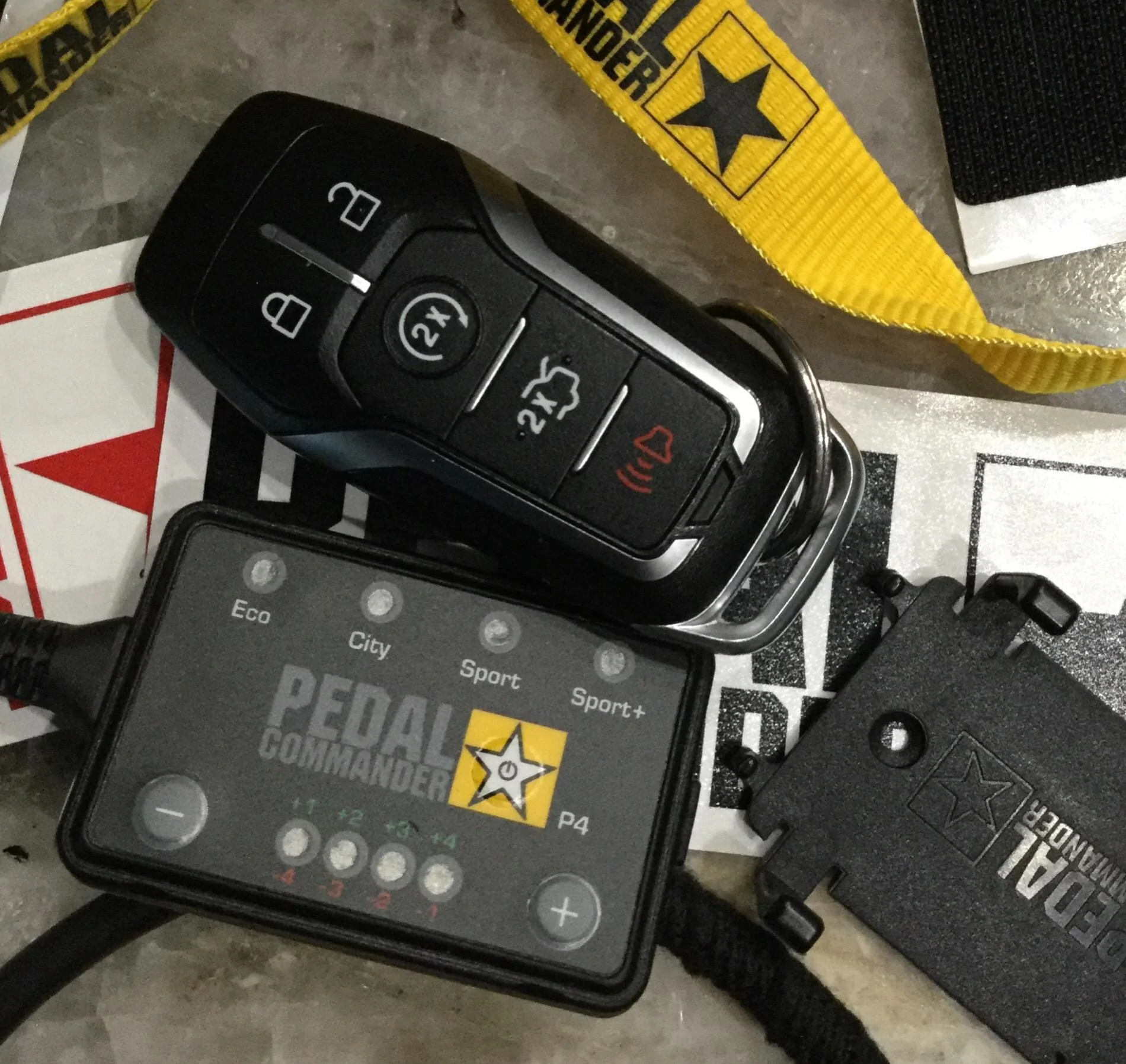

Selling my Pedal Commander if anyone is interested. $250 shipped. Going Whipple route.
