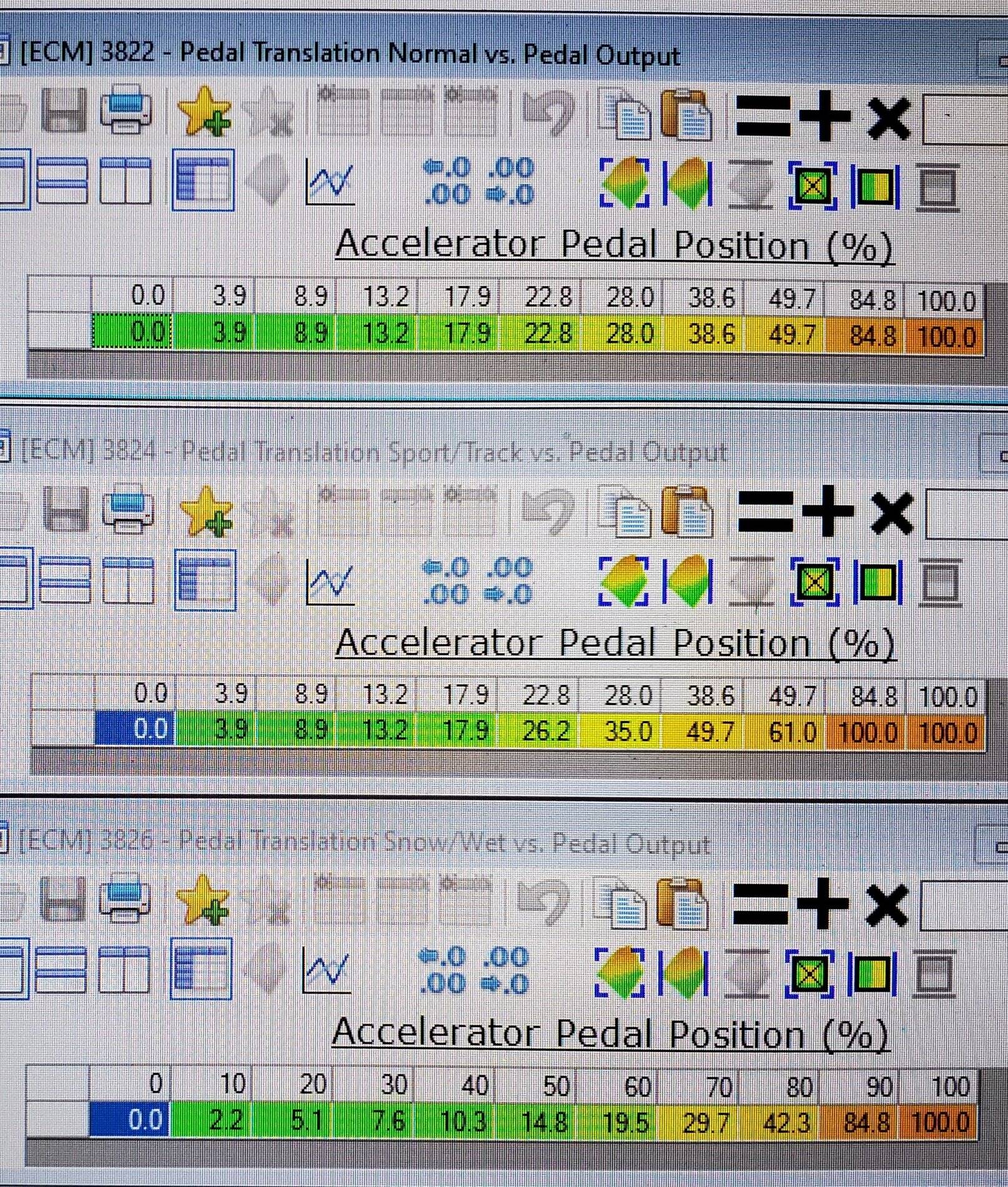

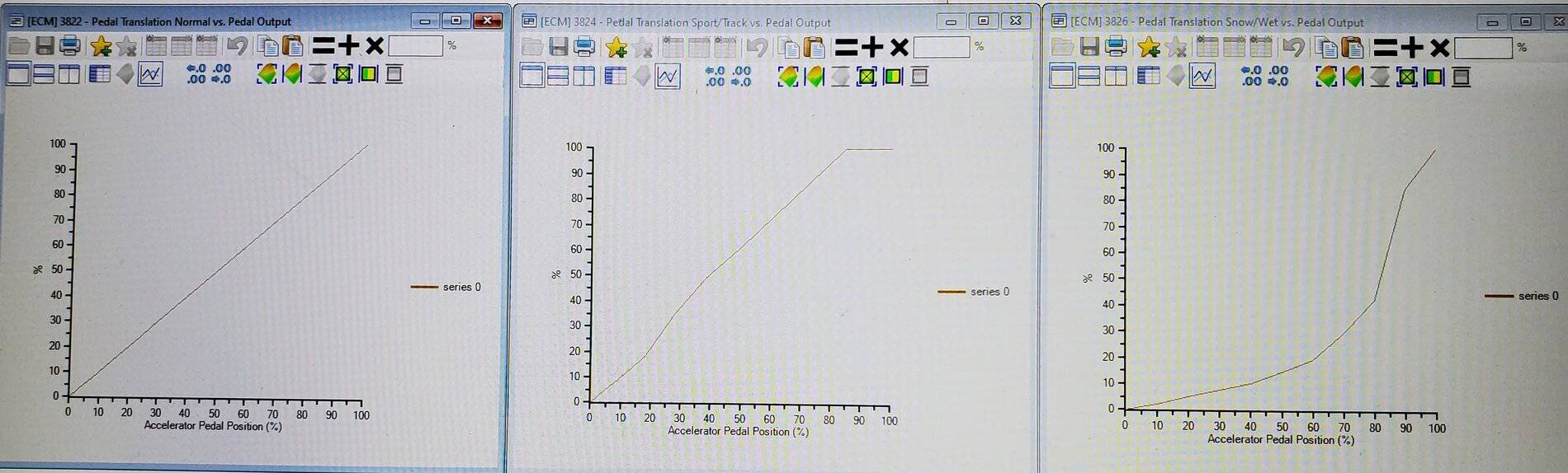

Standard pedal mapping :
Here you go!
Note that this is different to what I had seen previously though … ?
WD :like:
