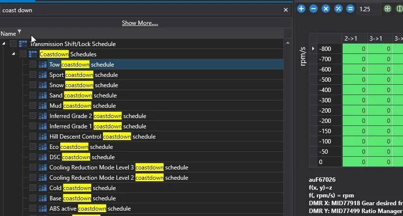

We have down our best to name columns/axis where possible, You should now see 2->1 3->1 etc in the axis opposed to 1,2,3 especially in the more common tables as seen below here. Most of the naming is based around the Mustang world, in the truck world some of these schedules are actually different as mentioned above, it also changes in different countries that don't have snow etc. However you'll find typically it's always the something similar eg snow/mud/sand etc are all going to have a loose converter and want to shift early.
Something that may assist you is the DMRX/DMRY descriptions that are listed in the table itself, these are available for many tables that have global loggable values.
Eg datalog MID77918 and you'll see what gear is desired.
Datalog MID77499 and you'll get the Y axis value. You can then map trace these back over the table to see exactly what happened.
