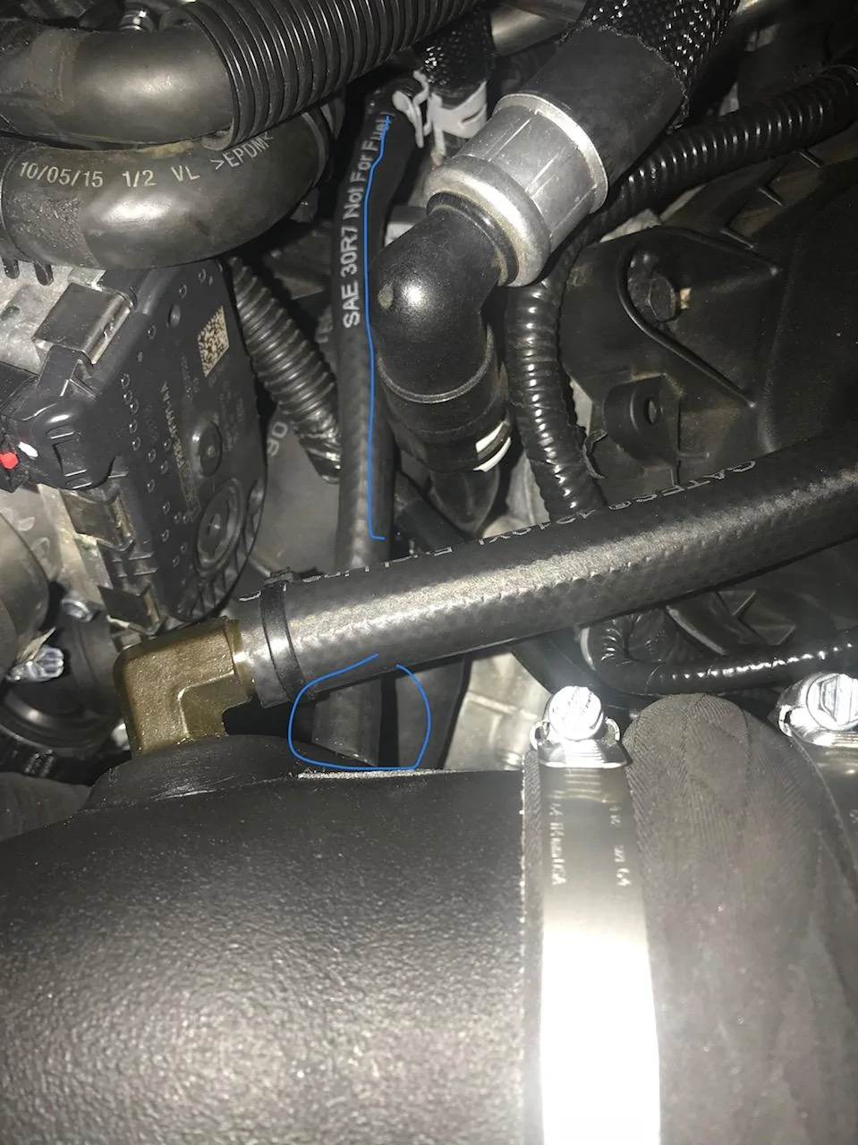

I’m wanting to run a filter directly on my blower and and wondering what to do with the the smaller of the 2 lines that run to the plastic Paxton inlet pipe. I know the bigger of the 2 is a vent line. It I can’t tell where the other goes. It appears to go back up towards the manifold and then from there I have no clue. I wasn’t sure if I could just vent it or if I need to put a breather filter on it too.

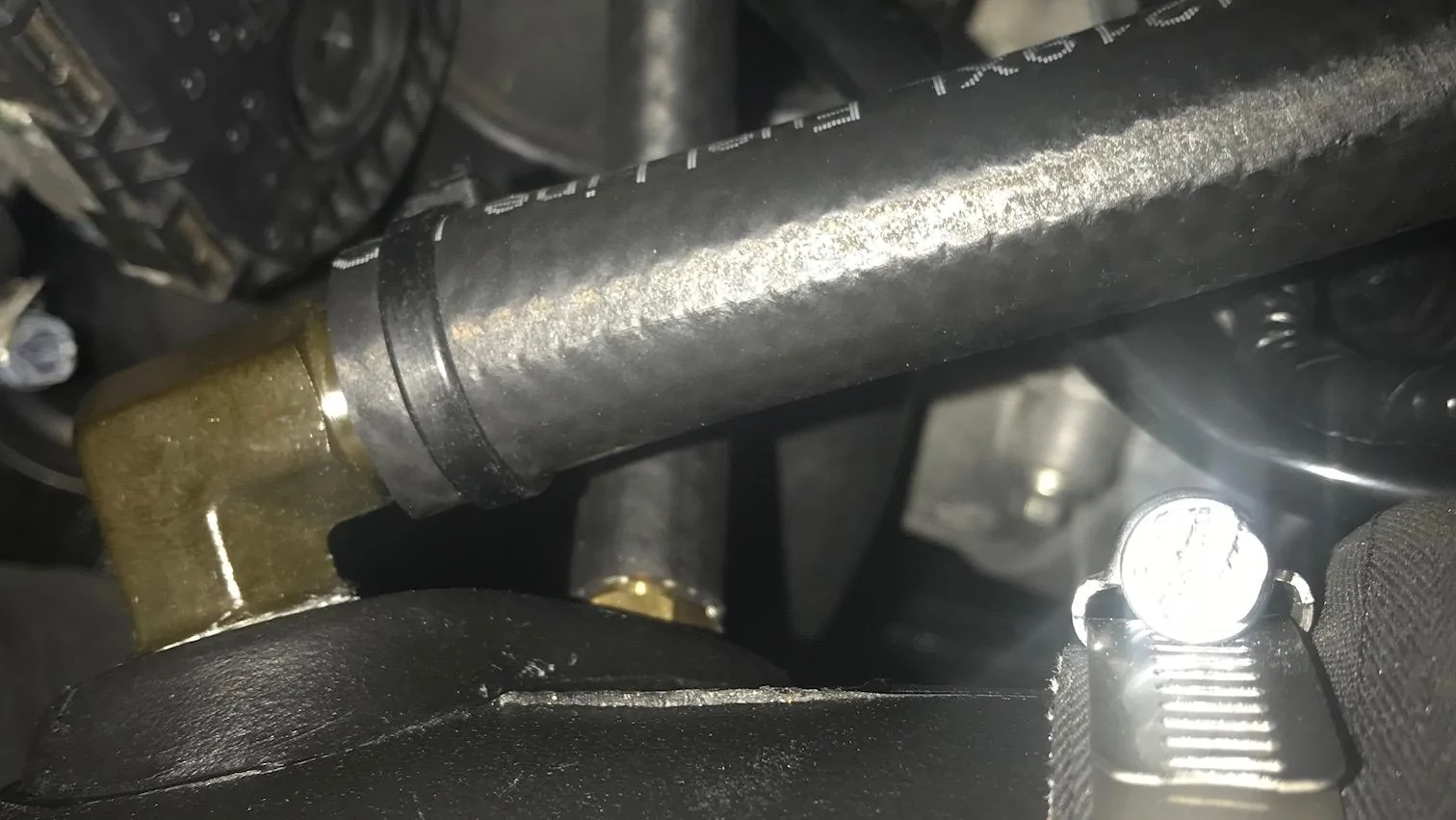

Here’s a better picture of which hose I am talking about.

Like I said on the facebook post, Leave the smaller one vented... The bigger 3/4 one coming off the valve cover to the intake pipe can be removed and just put a filter on the valve cover... If you run the intake pipe with the big line off and just a filter on the valve cover make sure you CAP off the 3/4 big barb on the intake pipe.
