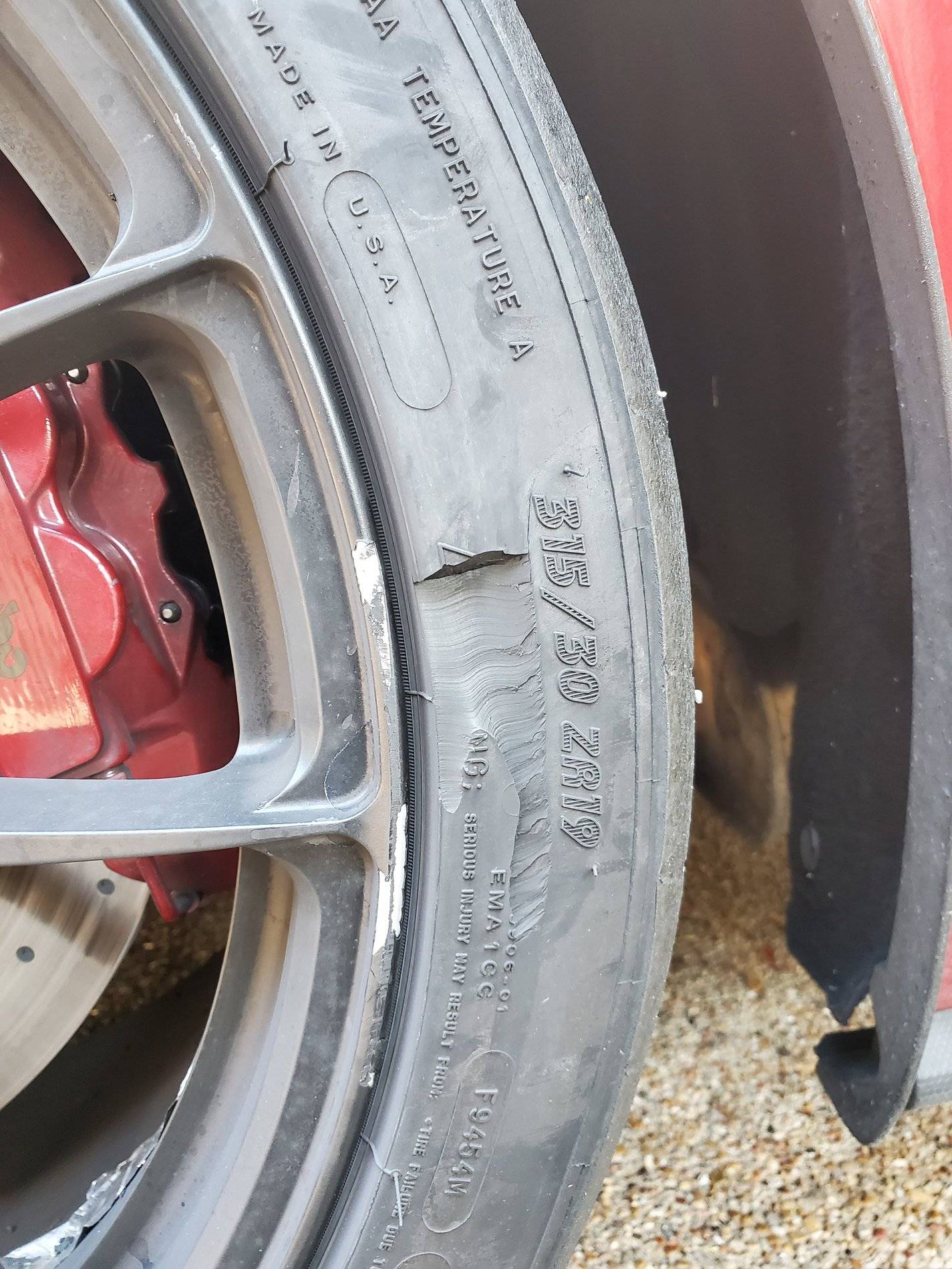

Coming out of the gas station earlier today I noticed what looked like a nail in my right front! Did a quick pressure check and all was good...nothing leaking yet. Ran by the closest Ford dealer to have them check it out. Keep in mind...as we all know Michelin Sport Cup 2 tread patterns. My car just hit 3,400 miles of all road driving. No track time yet.
View media item 16112
Service tech comes back to talk to me after taking a look. He proceeds to tell me how he can't patch the tire because I need 4 new tires! I was like what the heck?!? His logic...all 4 of my tires are bald! Not for safety reasons...bald tires. After a good LOL and a "you're kidding me right?" from me, he just stood there and was dead serious! I asked him if he realized what those tires are and the purpose and just got the response back again. "You're tires are worn out".
I left went went straight to a tire shop about 1/2 mile away. They pulled the tire off with intentions of patching it. Lucky day for me, this tiny screw was in it and had not penetrated the tire all the way thru.
View media item 16115
Needless to say, I know for a fact now that we know much more about these cars than many of the Ford Techs!

The red circle shows where the puncture was at. Unfortunately, didn't take a pic with it in.
View media item 16114
Looks like after measuring it with a standard tape, it went in roughly 1/4" or 6.35mm.
I was simply amazed the guy being a Ford Tech had not clue about the tire itself. After telling me I needed 4 new tires, I knew then it was time to check out and head down the road!
