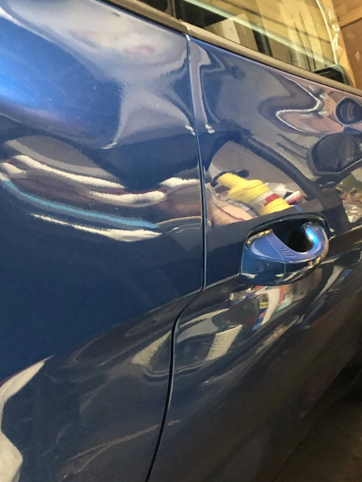

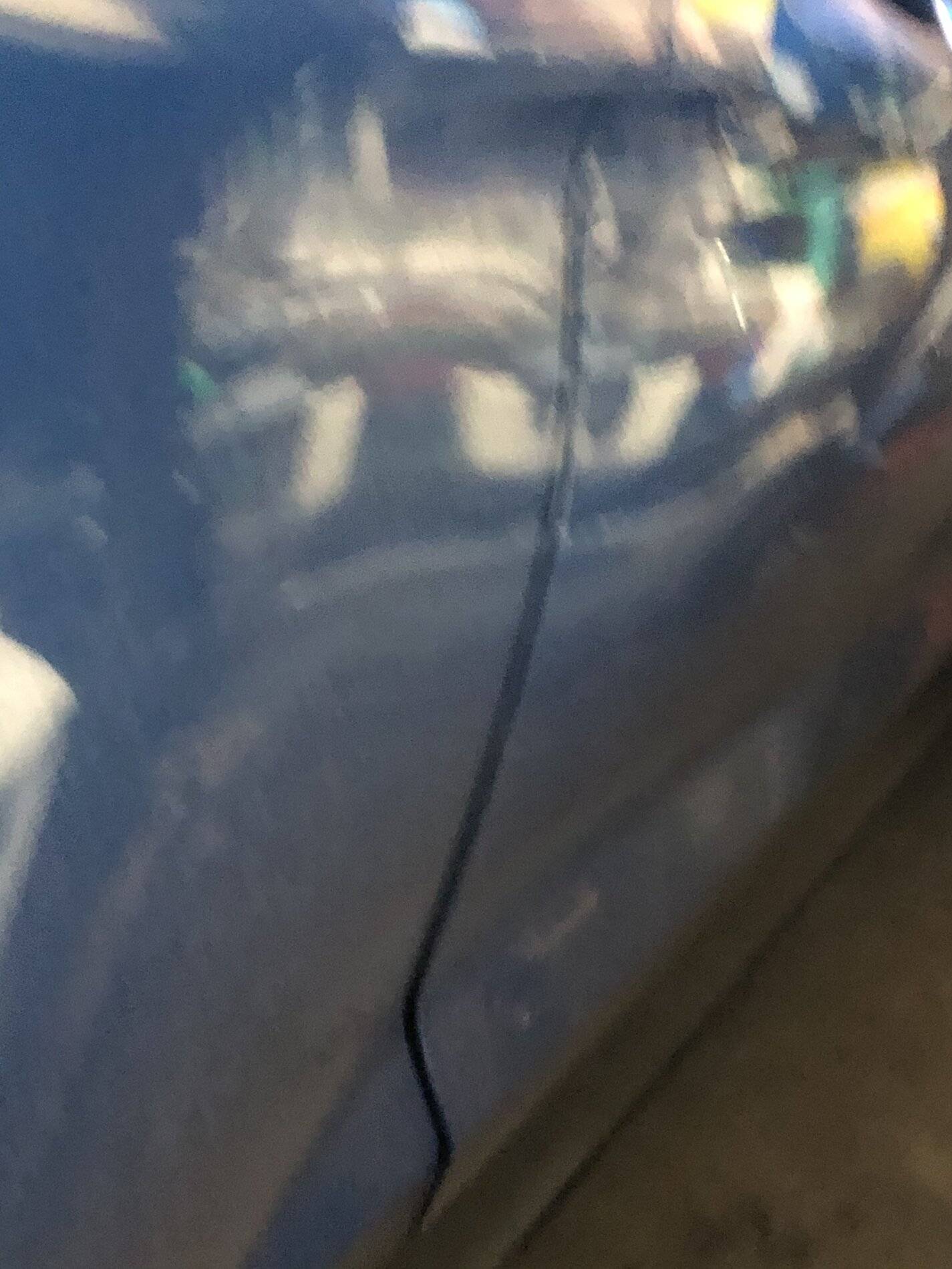

With passenger window up at about 30 mph I hear a wha wha wha noise - as if something is flapping in the wind but muffled. Will try to capture sound clip to post. Only occurs 28-32 mph. By the way passenger door is mis-aligned. About 1/8 th inch twisted outward on bottom edge. Plan to fix crappy Ford quality once we have some sunny days here in Seattle. Thanks for any input.

Both windows are rolled up. I will post pic of passenger side door. Maybe air flow around door - I can’t imagine wheel bearings or the like only 5k miles - new to Mustangs / Shelby and I tend to be over critical...

The images show typical Ford assembly body panel alignment issues. This below thread has all of the alignment specs attached within it if you want to try and adjust yourself (as others have), or a Dealer can do it.
https://www.mustang6g.com/forums/th...watch-out-for-tips-with-a-happy-ending.19261/
