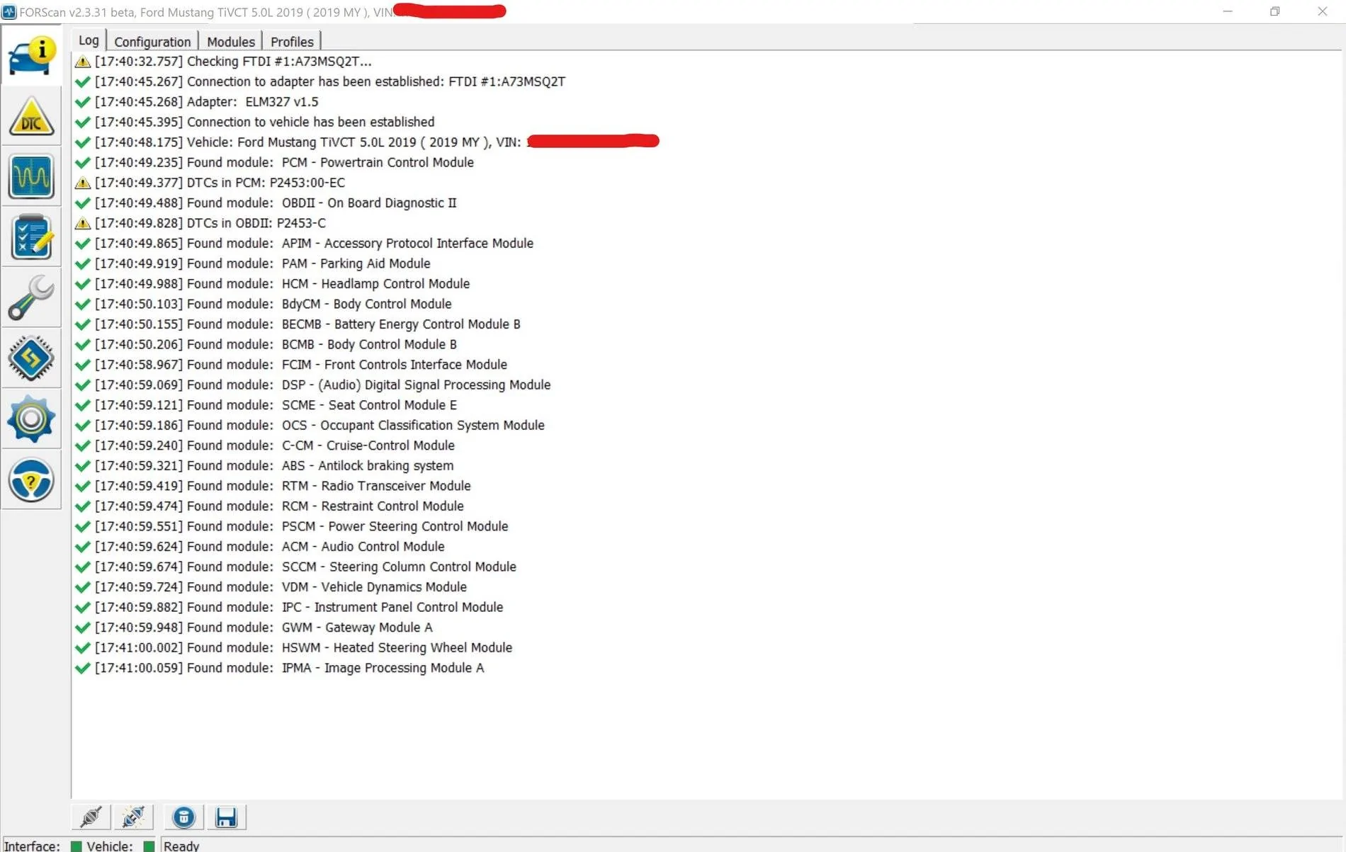

Seems like I got an issue on my '19 Mustang GT 5.0 (EU Spec). I got an orange check engine light.

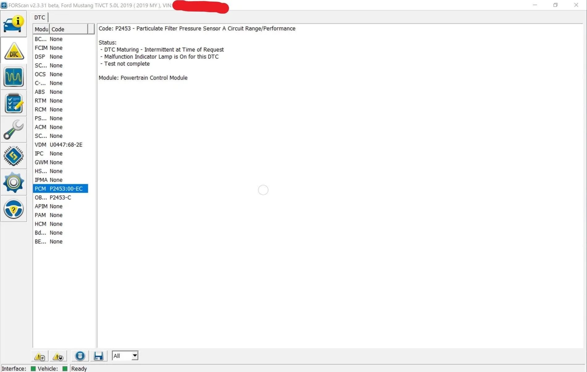

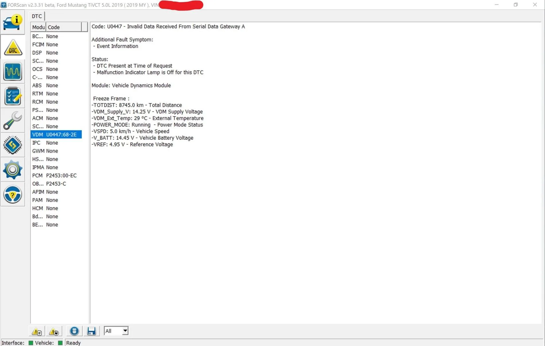

Does anyone have experience with the following codes:

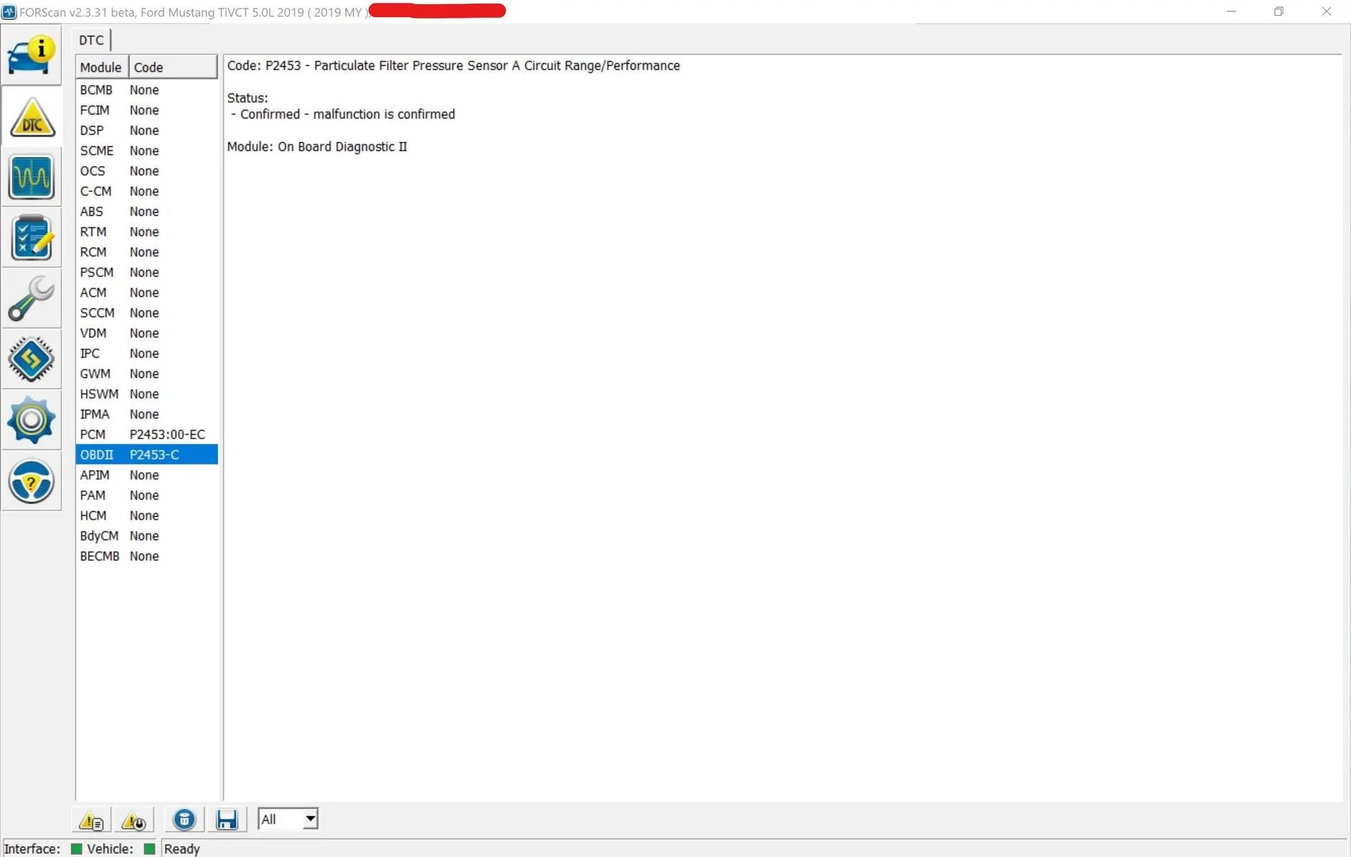

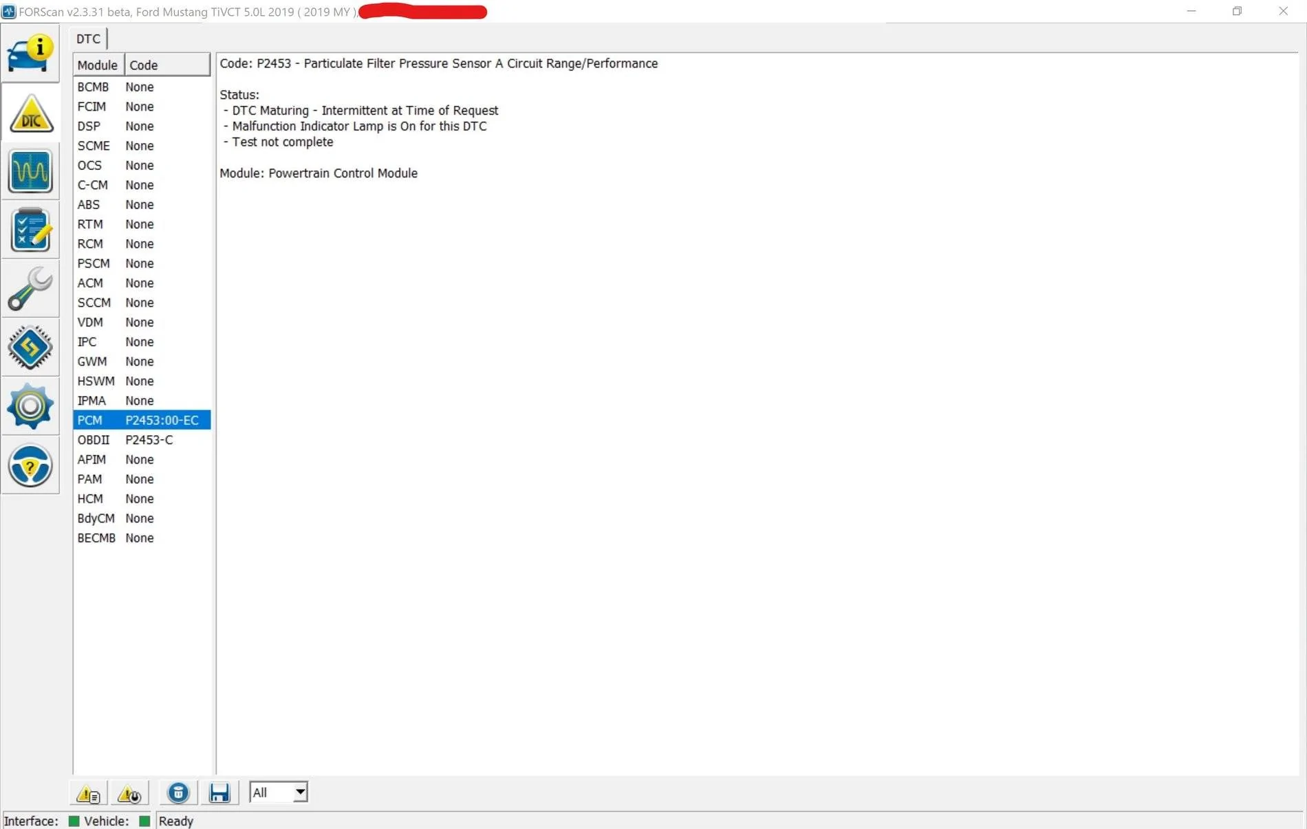

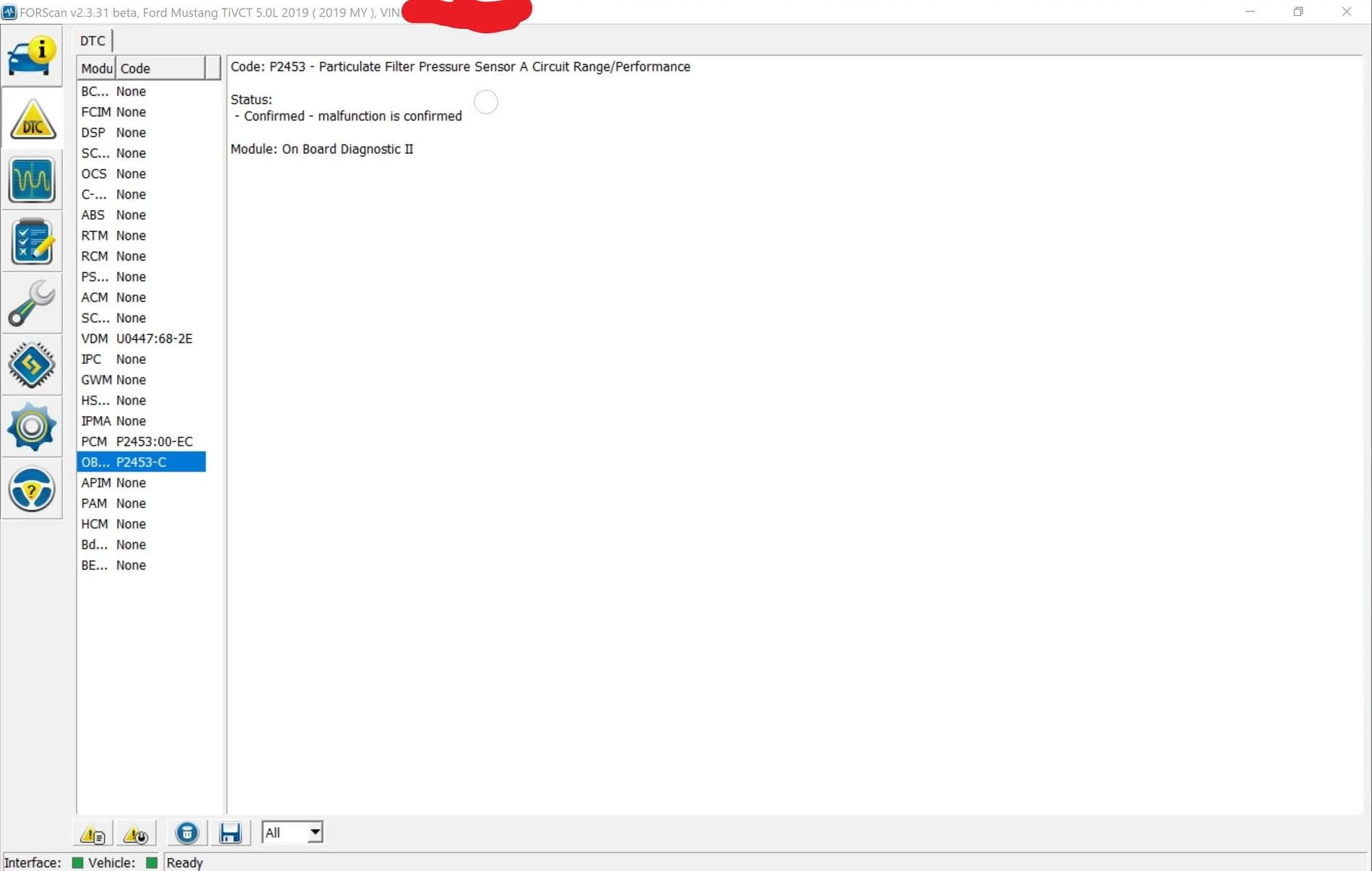

Code: P2453 - Particulate Filter Pressure Sensor A Circuit Range/Performance
Code: U0447 - Invalid Data Received From Serial Data Gateway A
Please check the screenshots from ForScan for the details.
The car runs fine. There seems not to be any issues with performance or any engine/transmission related behavior. Car is acting normal. I checked the GPF's (gas particulate filter's) sensor. By checked, I mean I wiggled the connection, but there seems to be no issues with the connections coming loose.

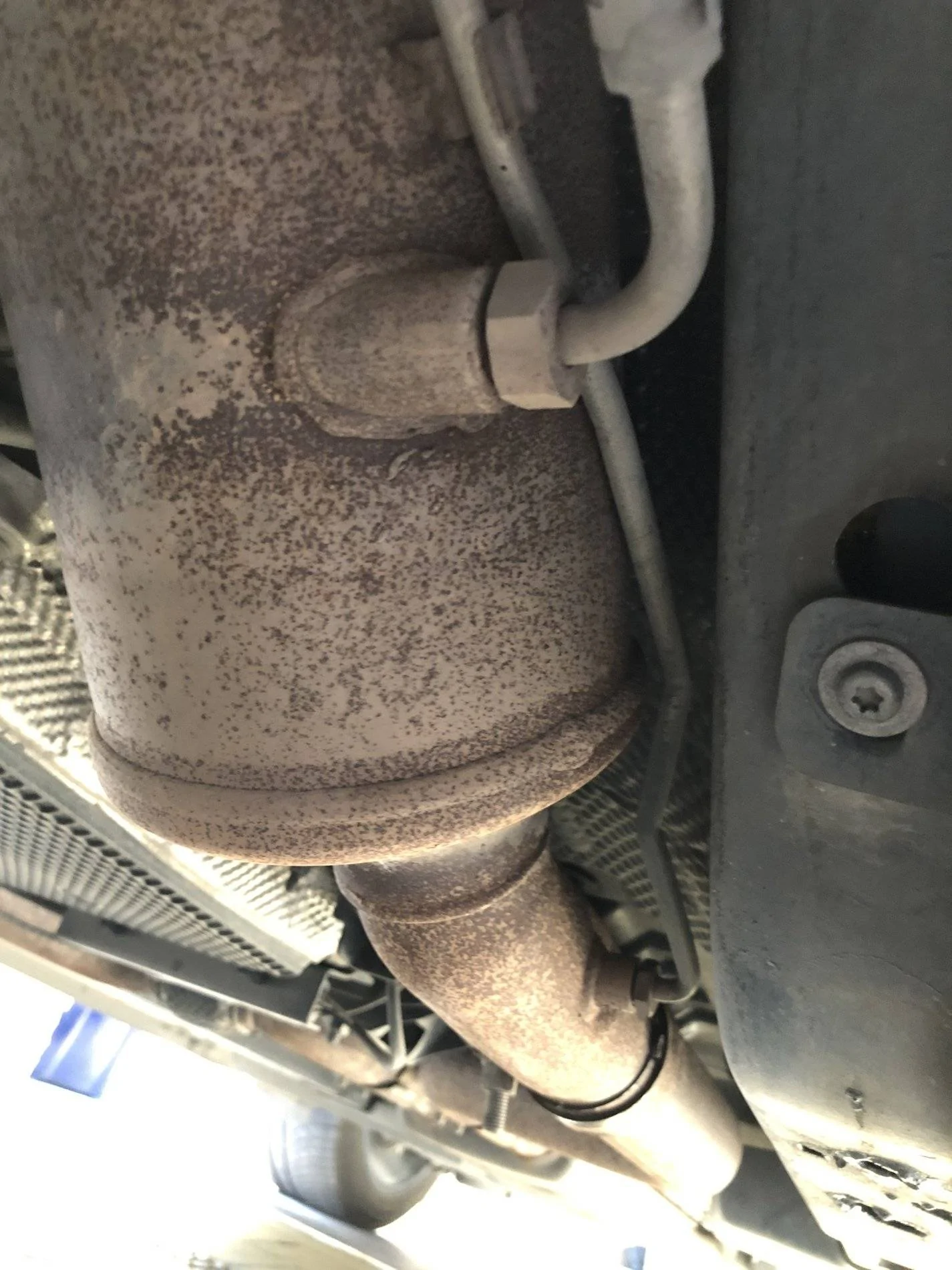

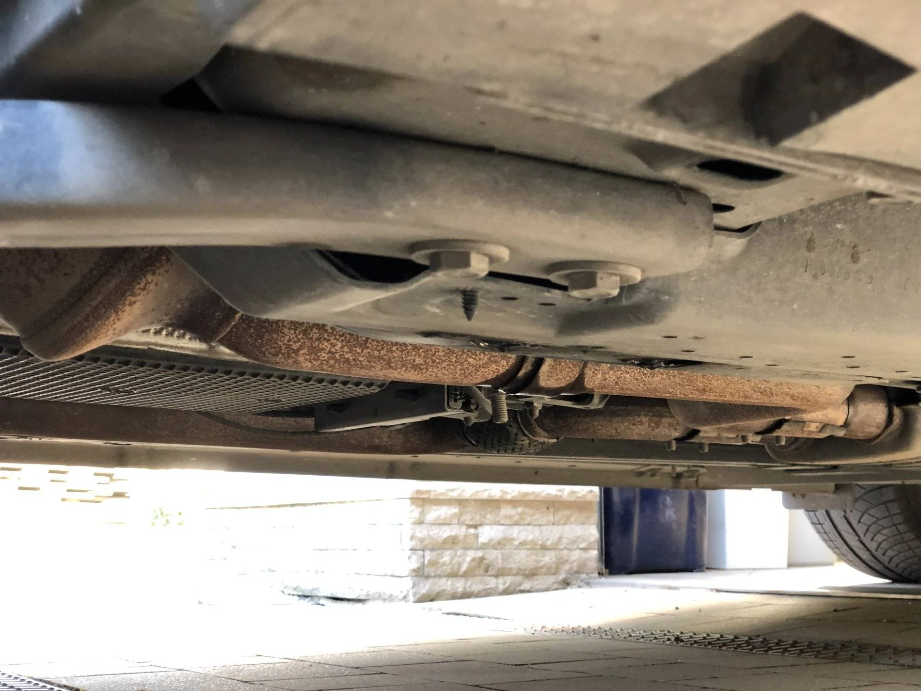

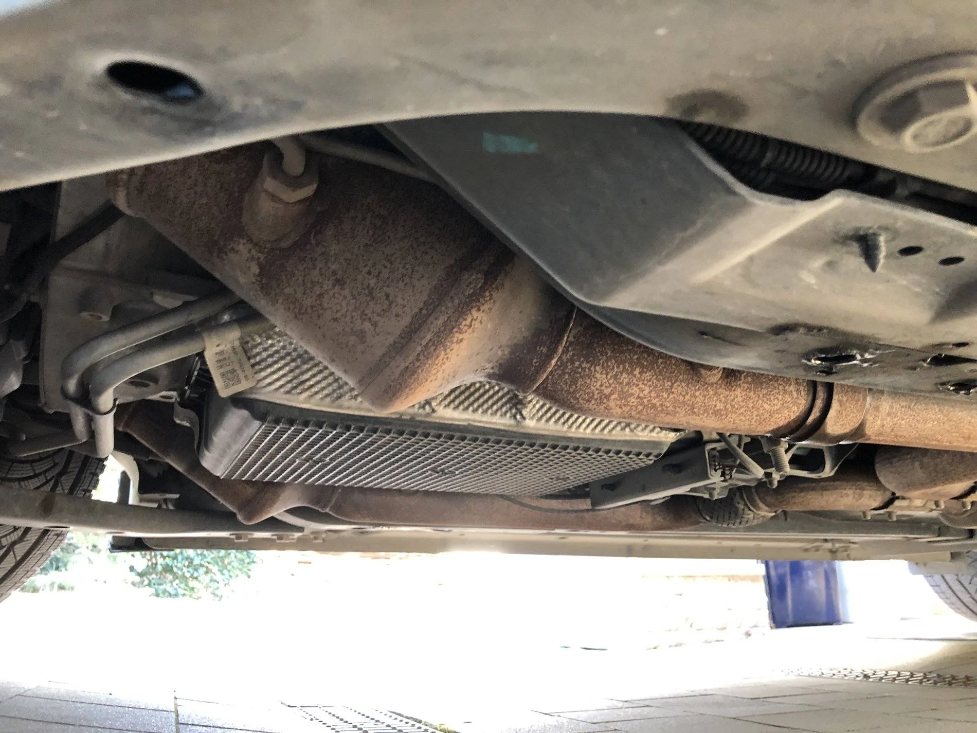

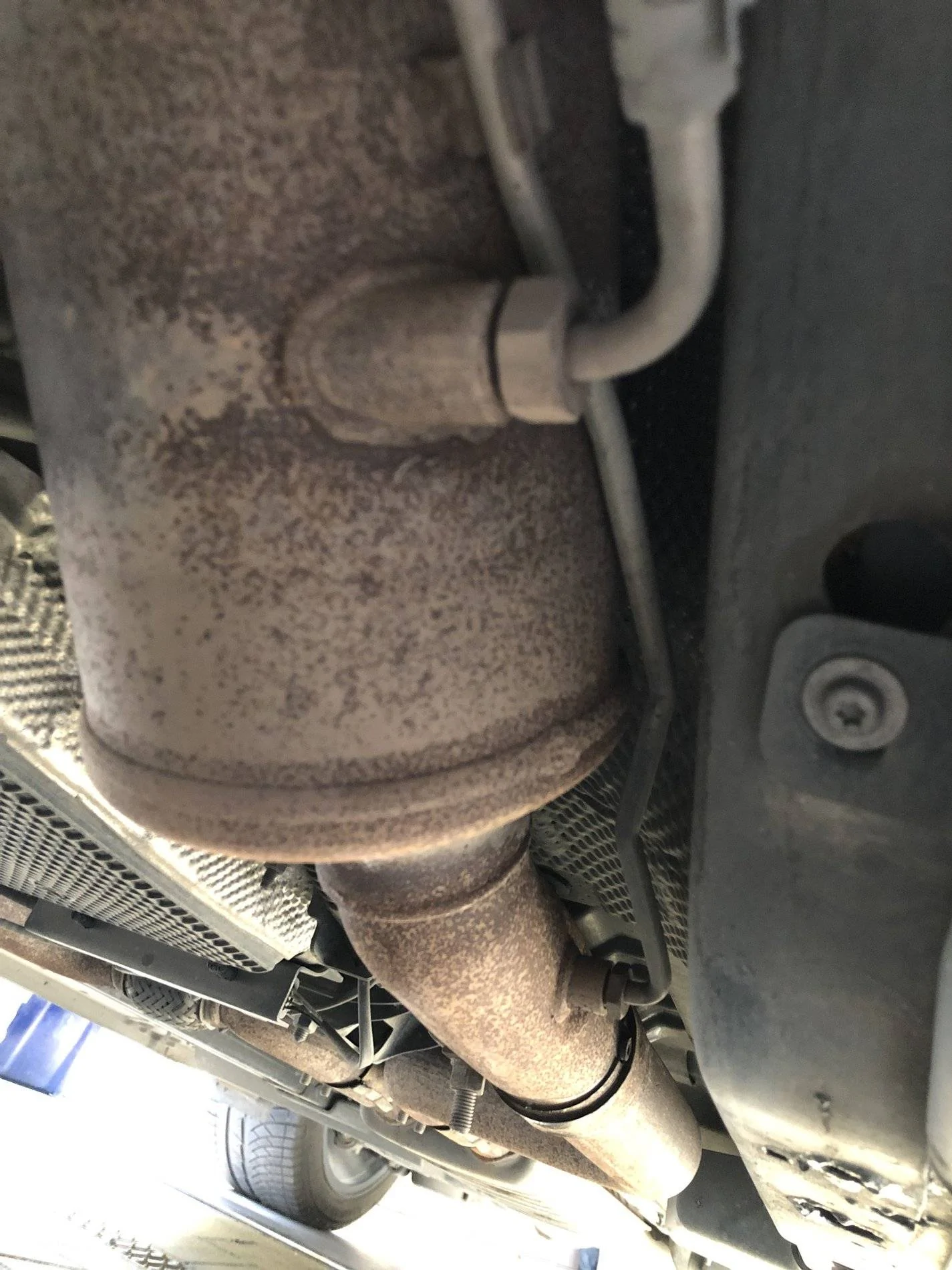

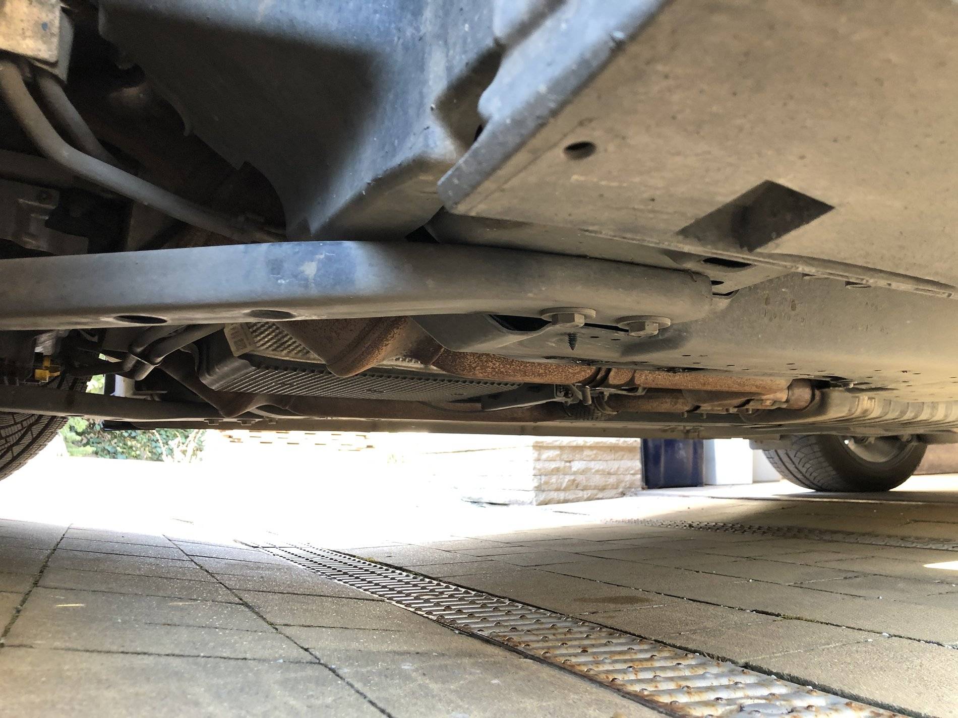

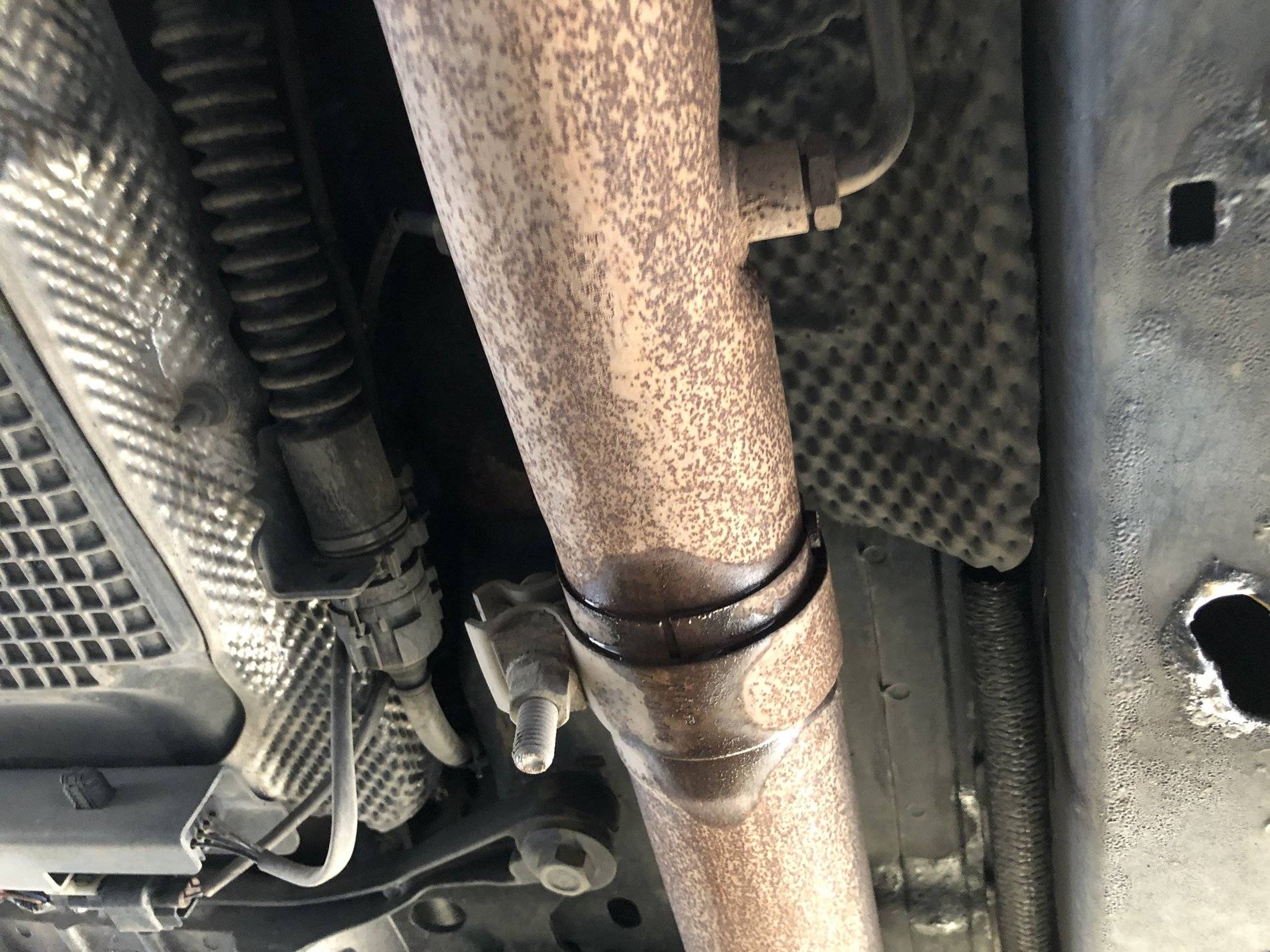

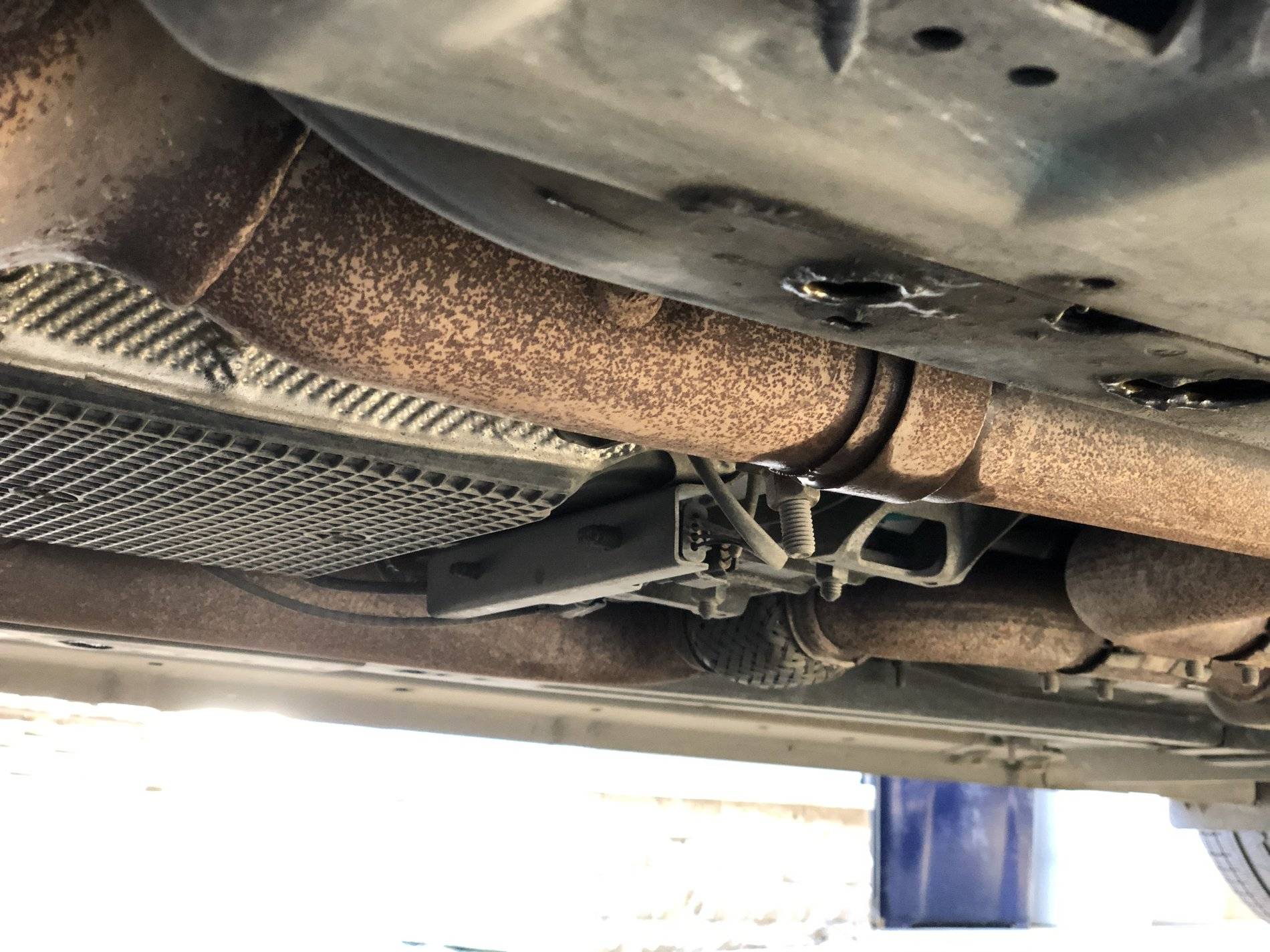

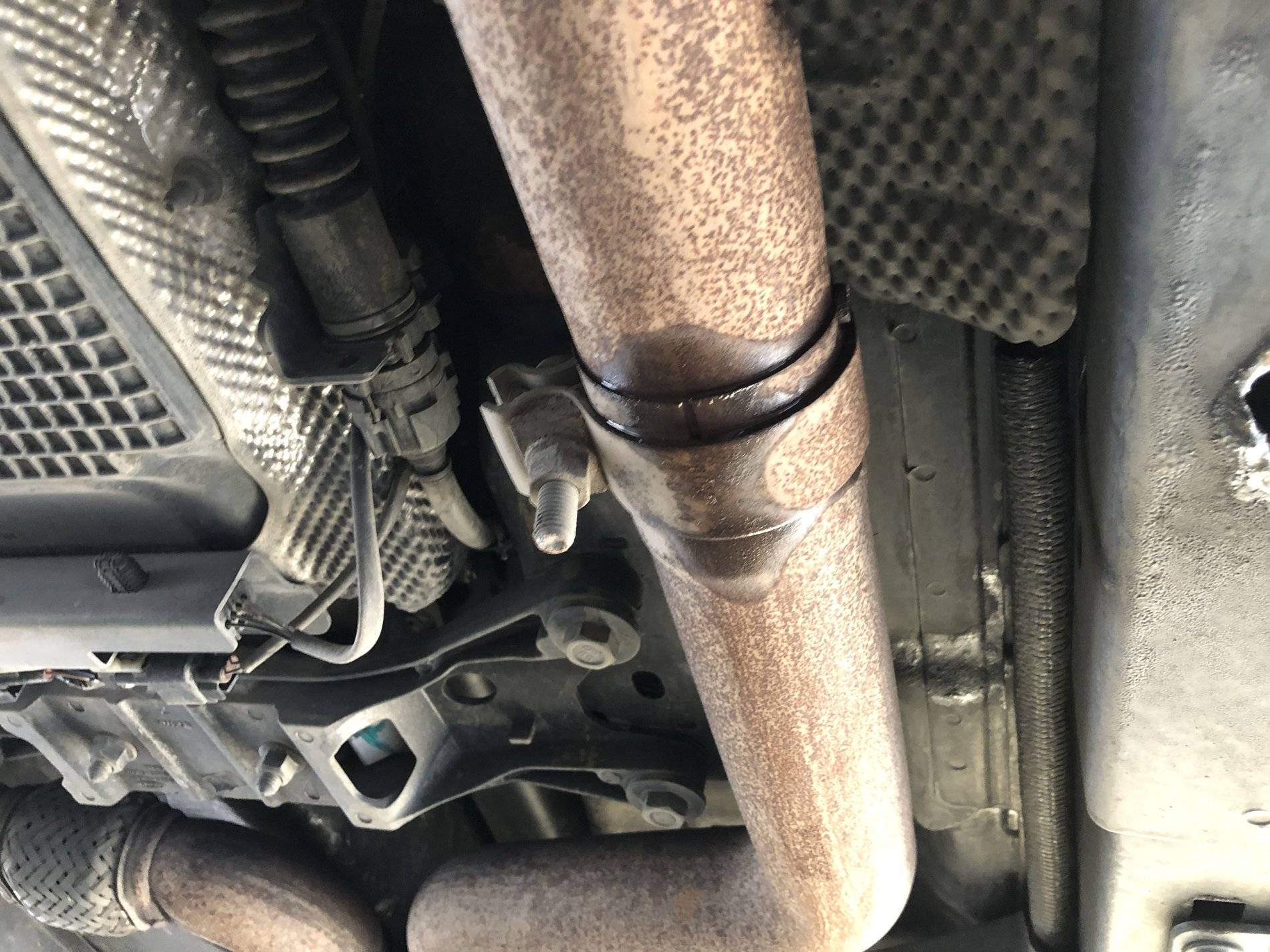

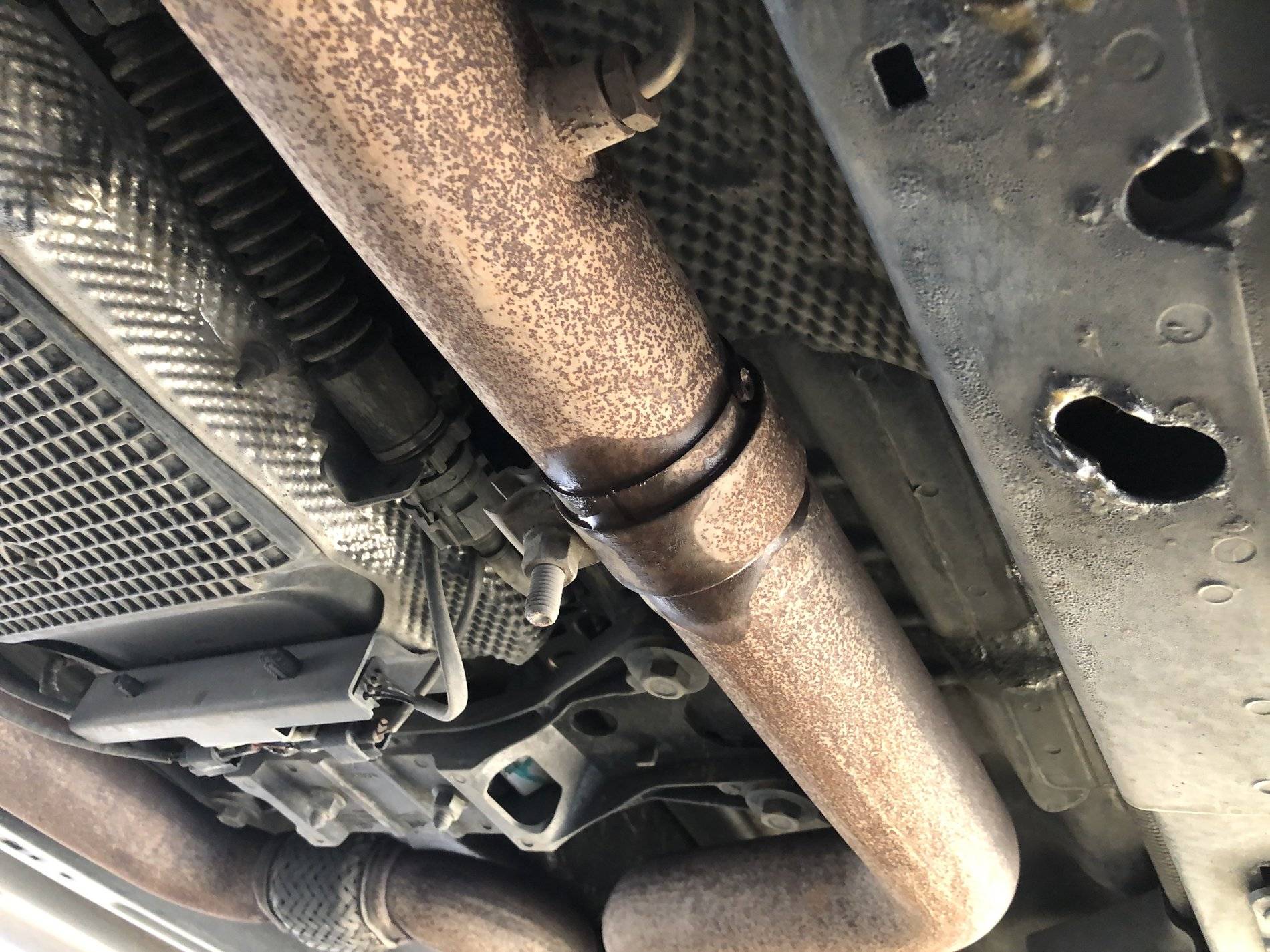

On the left side exhaust pipe (after the GPF) I noticed some droplets of petrol. I was parked on an incline so that I could reach under the car and it was right after startup. Nothing excessive, just a couple of drops.

ForScan Screenshots:
Pictures from underneath the car:

The images of the exhaust pipe where it shows moisture is that what you are referring to as the petrol leak? If so, that does not look like oil or gasoline, the moisture looks like it is due to an exhaust leak at that juncture. The exhaust pipe needs to be closed up more; you can do that by loosening the clamp, nudge the pipe forward and then tighten the clamp.

Ok. I'll try that. Do you think that could result in the check engine light going off?

UPDATE: I looked under the car again. Tried to tighten down that clamp, it was basically as tight as anything can get, so didn't do much with that. I decided to clear the code and run the diagnostic over it to scan for codes again. Nothing popped up. Check engine light is off. Couldn't find any diagnostic value that would even indicate that any sensor would be bad, so we will see in a couple of days if the error code pops back up. Until then, maybe a false alarm?

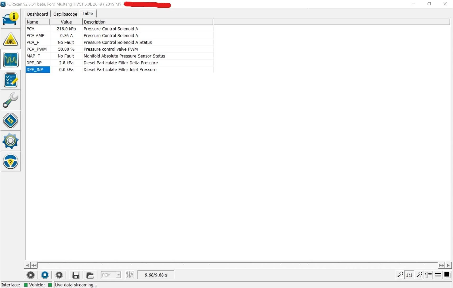

I tried to read out all the live data that contained the phrase "Pressure". I found that the DPF_Delta is reading 2.8 kPa . I read on some other forums that if the pressure goes above 2.7 kPa it triggers a engine warning light and a DTC. Interestingly the DPF_INT is reading "0". I wonder whether this should be the case?
I also attached a bunch of other screenshots with the DTCs. I am kinda lost for what to do...
