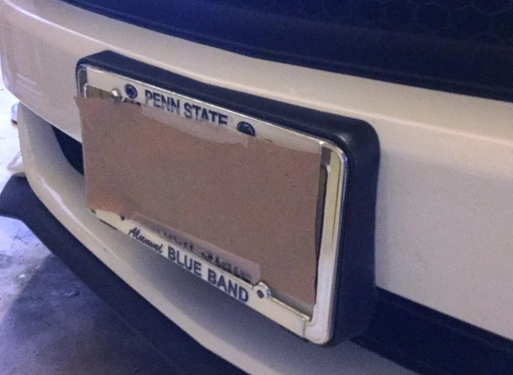

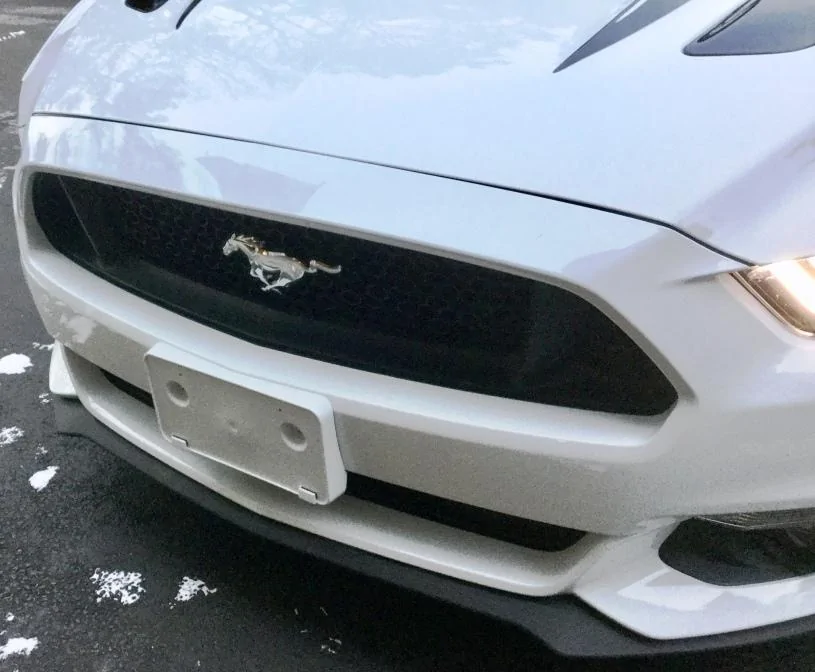

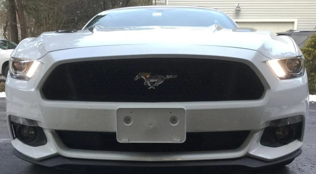

My Mustang came with a pre-attached Ford front bracket. Having a black bracket on a white bumper was bothersome.
I purchased 1 spray can each of Oxford White paint and flexible plastic primer from Automotive Touchup Inc. Using the enclosed scotchbrite pad, I sanded down the plastic then applied liberal coats of plastic primer (used mostly on bumpers) and white paint. Please ignore the black spots on the pictures-for some reason, they appeared. They are not there in real life.
Then, I used a can of their clear coat, applied several coats, and lightly buffed with a polishing compound.
For someone with zero bodywork training, I like the results.

Looks good. Never thought of doing that.
