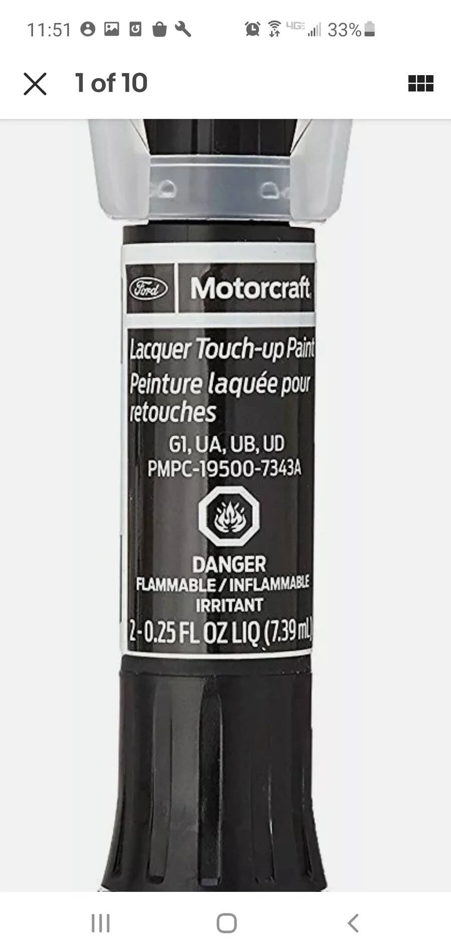

2018 Black Shelby GT350. No stripes.
For touch up.
Anyone know?
Thanks.

ebony black. One of the R wheels that i bought for repair needed a minor touch up. This worked perfectly.

I'll give it a try. But is the paint for a non-R the same?

Yes, ebony black as shown above. Also code M6373 if having it made up. These colors btw, are the 2015 Mustang black color.

Also, if you are touching up an aluminum wheel that is down to the bare aluminum, you really should use an etching primer. Otherwise, the paint will not stick to the wheel very well. Etching primer is usually green in color and can be bought at any automotive paint supply.
If you are just touching up a (very) small area, then I might skip the etching primer, but understand the paint may not bond very well to the aluminum.
