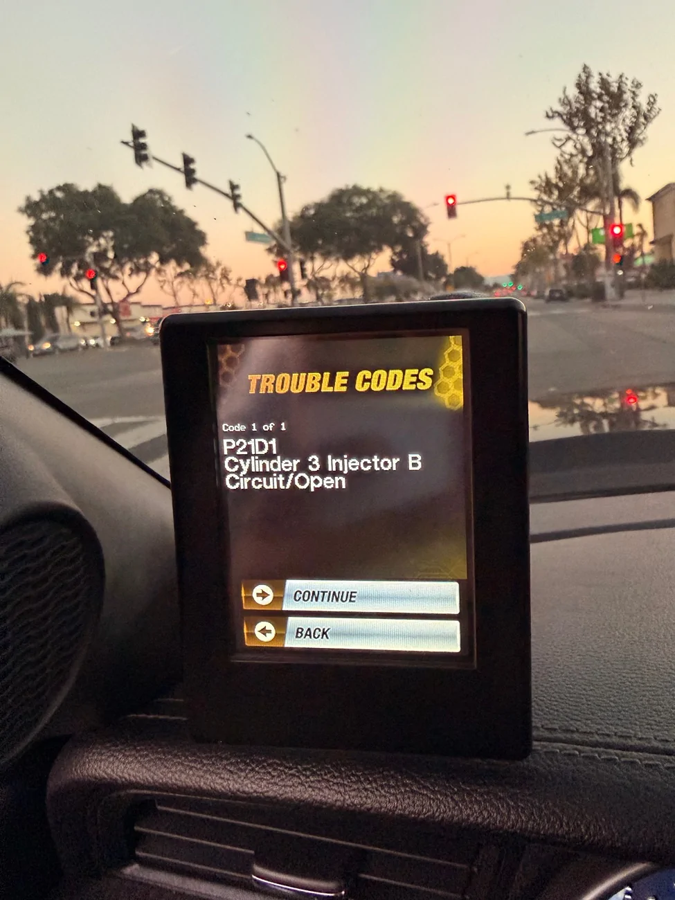

P21D1 Cylinder 3 Injector B Circuit/Open

One day on my way home from work, the car threw a cylinder 4 PI injector code. I bought a new set, installed them, and the car ran fine for an hour or two — then it threw a P21D1 code.
I pulled all 7 DI injectors, had them cleaned and flow-tested, and replaced the #8 injector with a new one. Put everything back in, and the same code came back. The car idles horribly, sounds like it’s down a cylinder, and makes a weird pinging noise. It sputters badly from 1500–3000 RPM.
