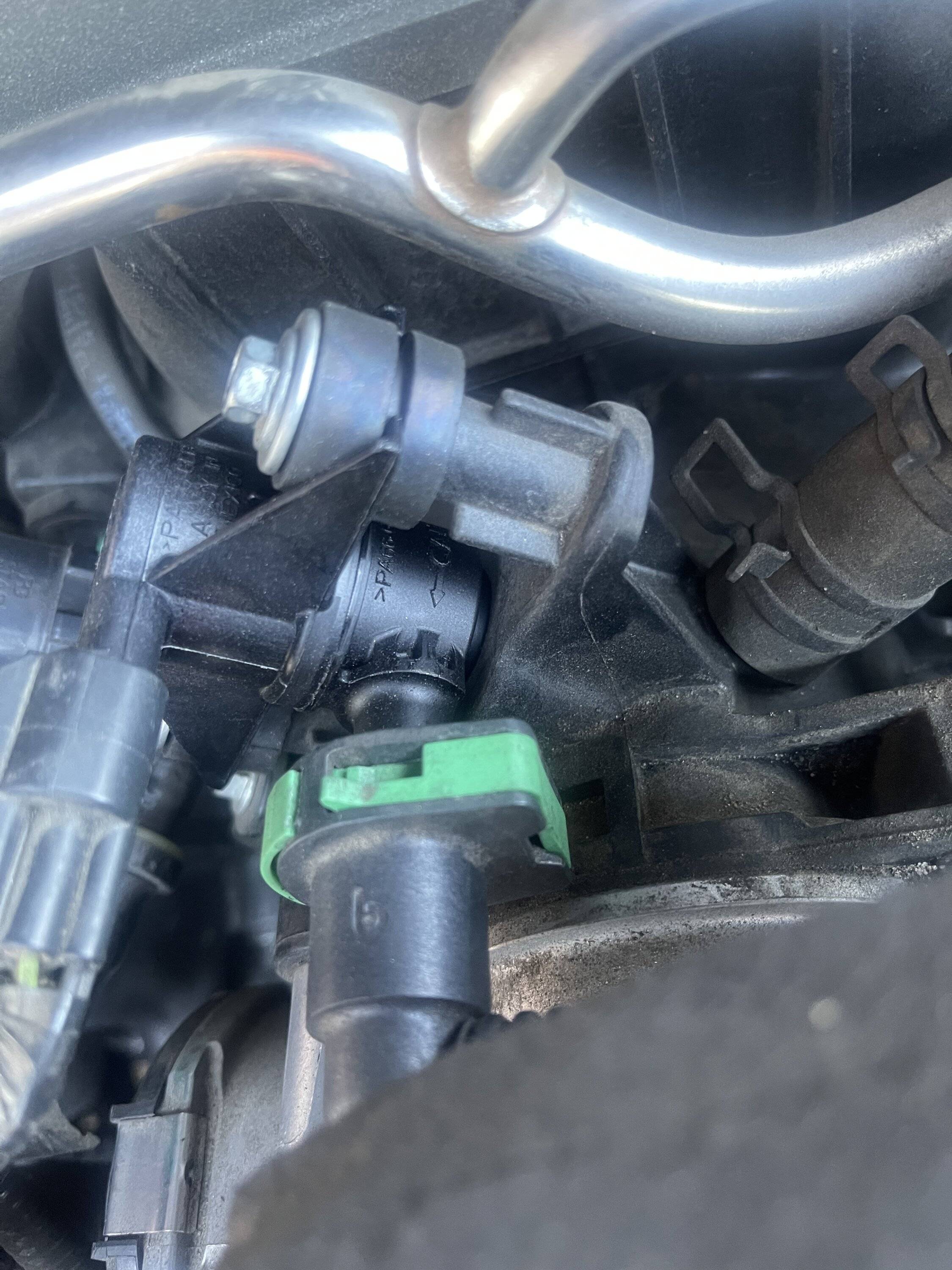

I installed that one i had installed another one prior that also didnt work. The DTC was cleared after each install. I noticed no matter how hard i pushed down the area that screws on had a slight gap. Since Ive changed it once before it came back on and now with this new one in the pic below and the light came back in again figured has to be something else.

Took a pic of it on the car.

Check for continuity at the harness connector and also check the same at the sensor pins where the harness plugs in.
I mean it's possible you're getting a bad part, but to get a bad new part 2x, it's either coincidental, bad quality part, or the problem is with the vac line, electrical connector or harness.
The other thing you can try too:
With the car running, spray some carb cleaner or EFI cleaner around the vac line connection to the sensor - if the car idle changes, there's a breach with the line (hairline cracks) or where it connects isn't sealing properly.

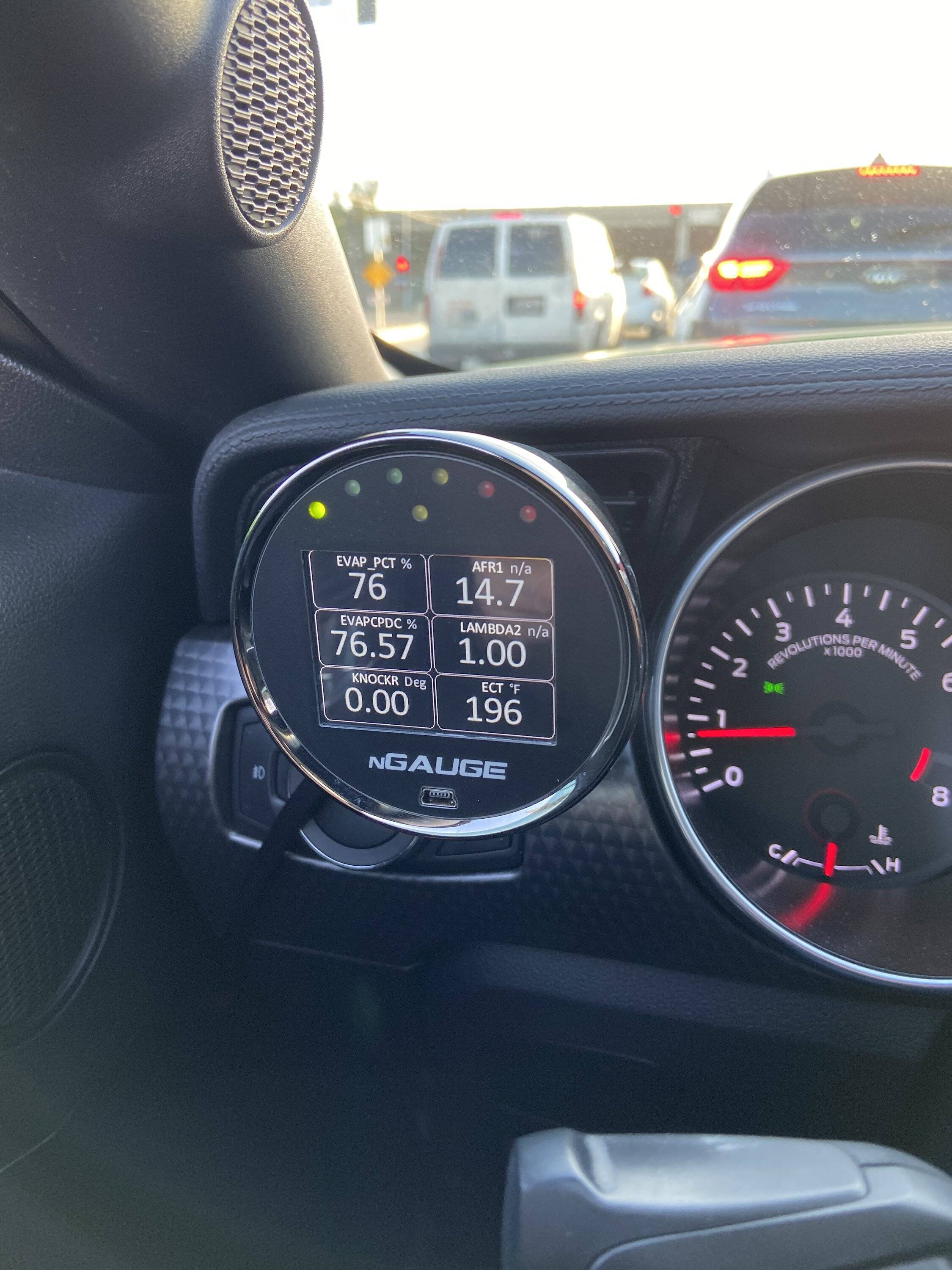

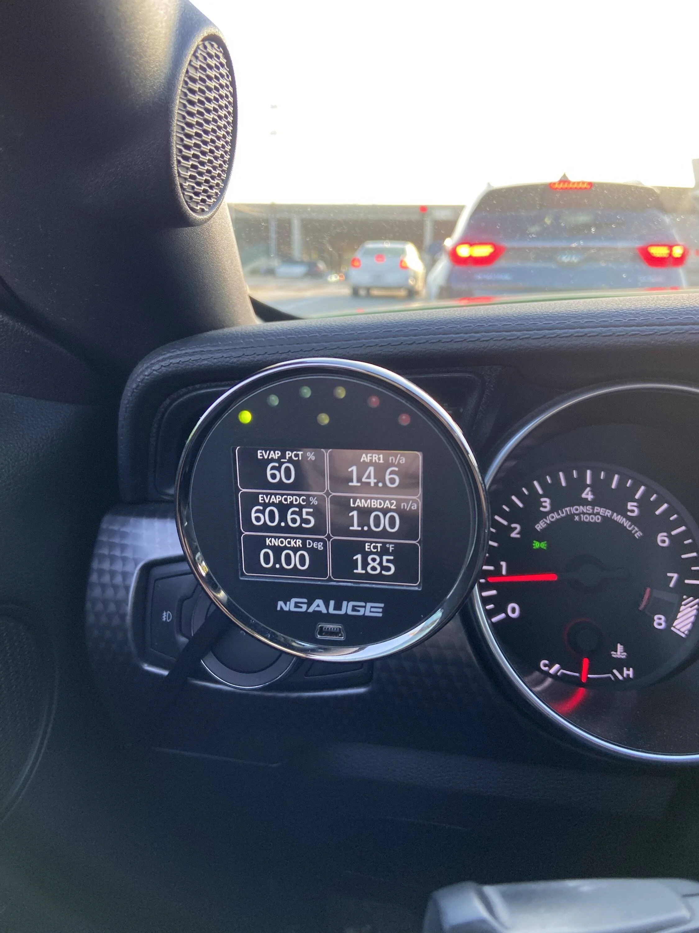

there are two values I’ve been paying attention to since I recent my codes… EVAP_VP and EVAP Purge %
if you could tell me what a cold start idle number go that is and how much gas you had when you checked it, it would help determine if we either have the same or differing issues.
im going on a more ā€œstraightā€ friendly cruise today since my cruise yesterday was a canyon run. Hopefully whatever it is rears it head so I can knock it out and stop thinking about this crap until the next tshoot adventure.

Also if you could monitor evap VP value as you drive (look ahead of you first of course haha) that would give me a baseline to reference.
min kPa I am seeing a -7 value, until some time idling or being on the accelerator consistently and then it’ll hit 8 kPa and the purge will start opening to adjust pressure.

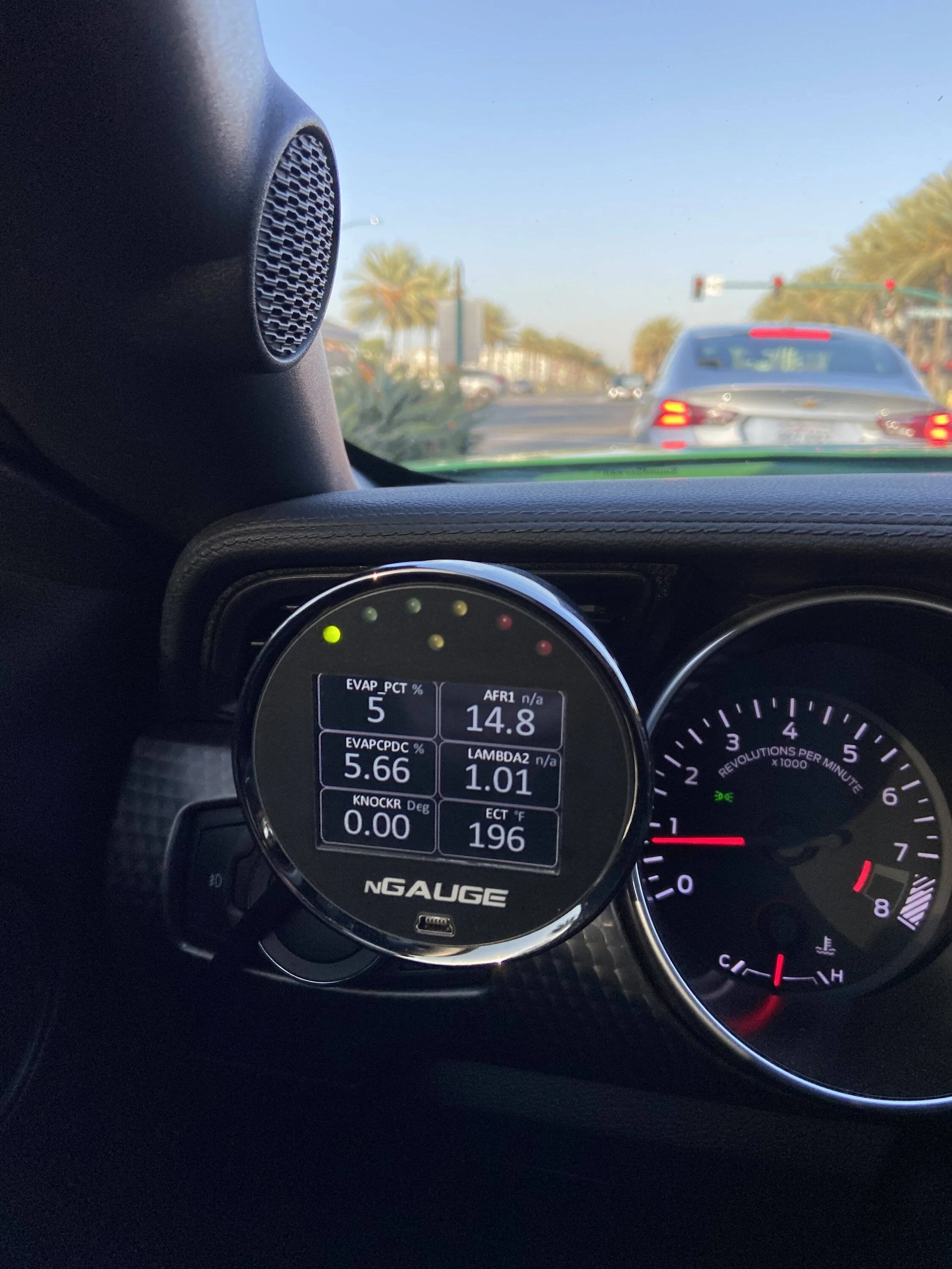

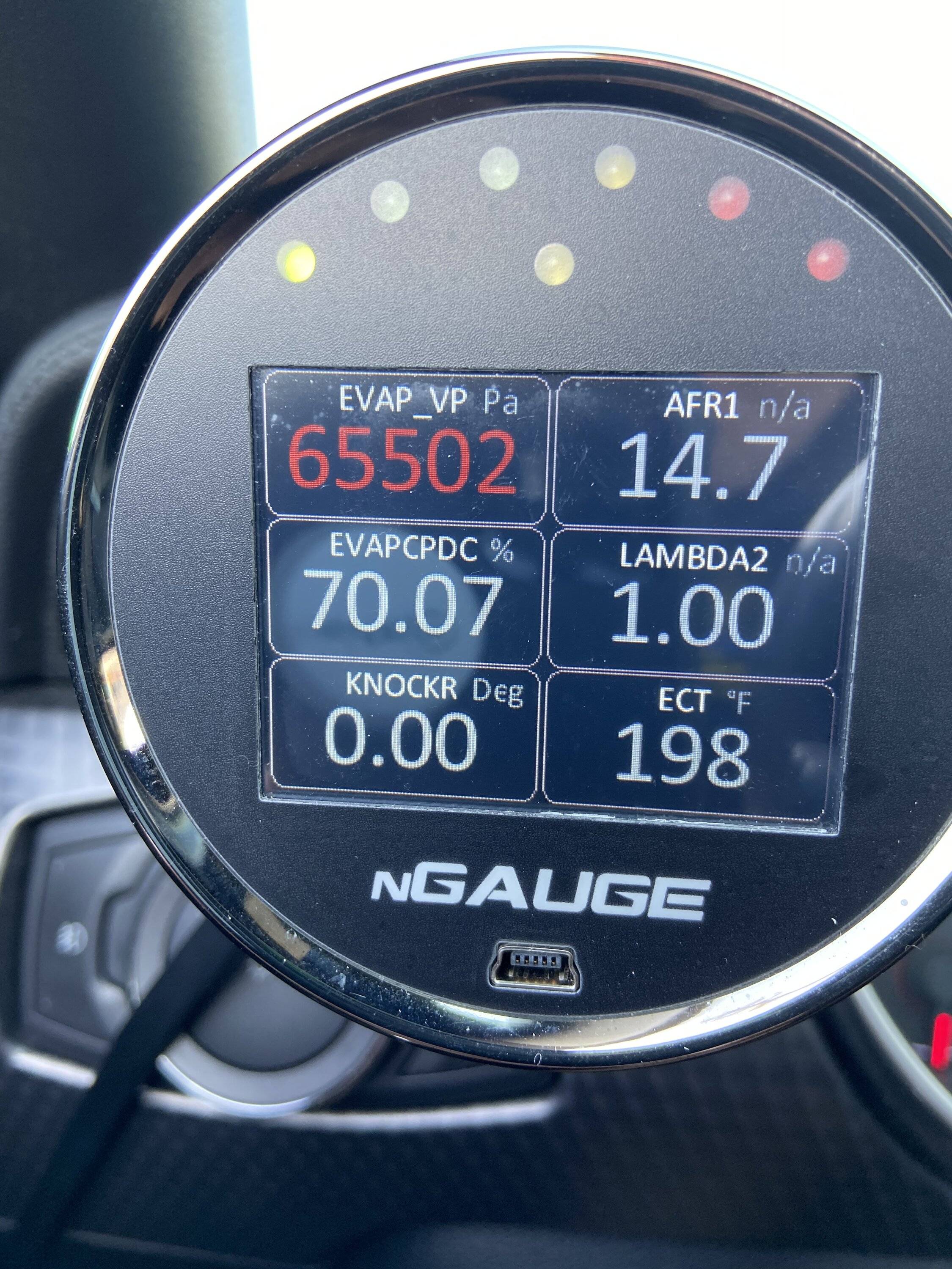

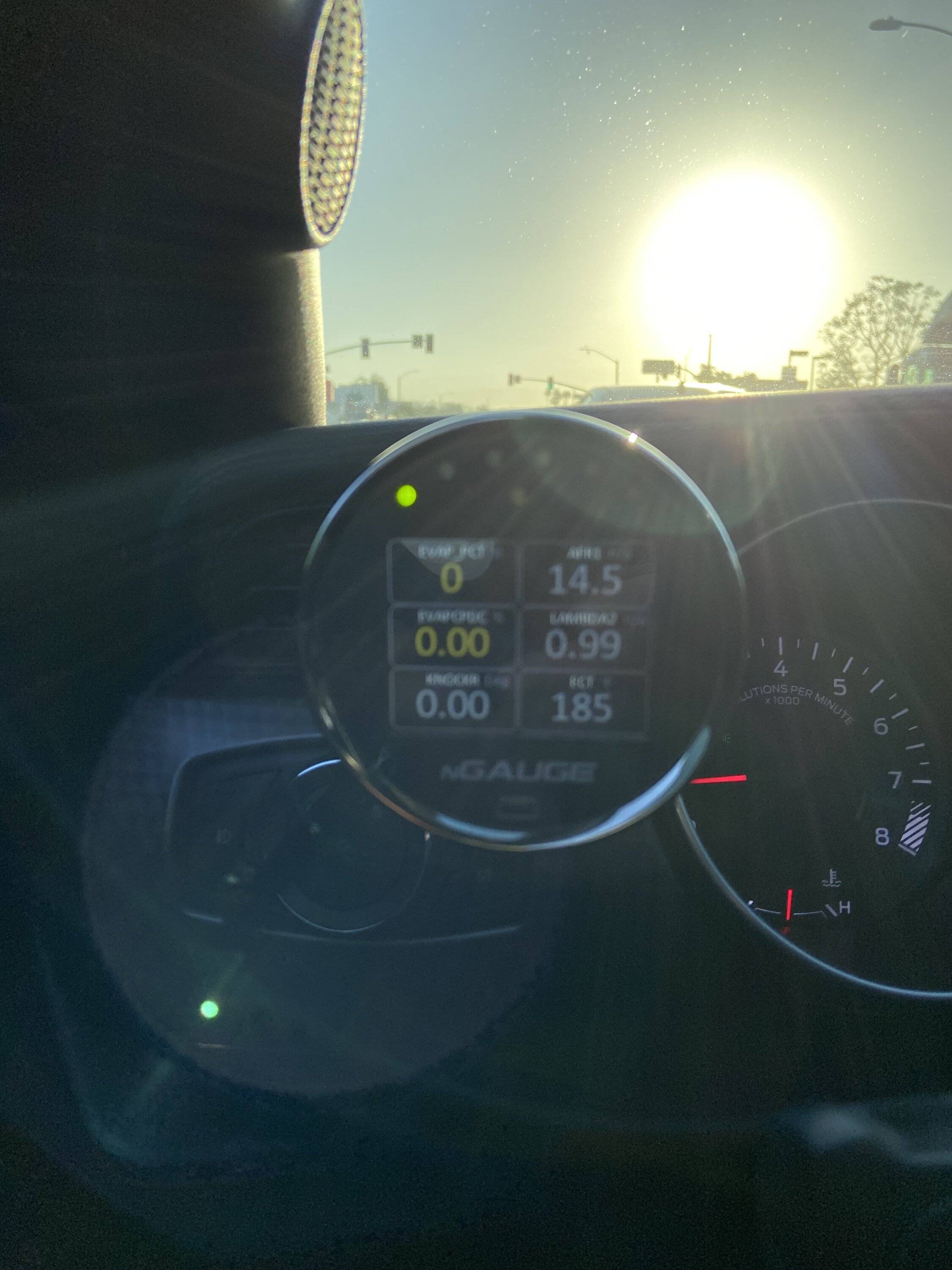

I am not really sure what I’m looking at here. The EVAP_CPDC and EVAP PCT fluctuates like crazy. Basically from 0% all the way up to 95% depending on how much I’m throttling it. Sometimes when I’m driving 60 miles an hour it’s sitting at 0%. I don’t know if that’s good or not. The VP is always looking like 65502 or so.
