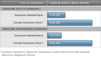

I just looked up the emissions warranty and I don't think it covers the canister purge valve
EMISSIONS DEFECTS WARRANTY COVERAGE
During the warranty coverage period, Ford Motor Company warrants that:
  • Each vehicle or engine is designed, built, and equipped to meet – at the time it is sold - the emissions regulations of the U.S. Environmental Protection Agency (EPA).
  • Each vehicle or engine is free from defects in factory-supplied materials or workmanship that could prevent it from conforming with applicable EPA regulations.
  • There are no charges for diagnosis, repair, replacement, or adjustment of defective emissions-related parts listed under What is Covered? by downloading the Warranty pdf.
The warranty coverage period for the following parts is 8 years or 80,000 miles (whichever occurs first):
  • Catalytic Converter
  • Electronic Emissions Control Unit (ECU)
  • Onboard Emissions Diagnostic Device
For all other covered parts, it is 3 years or 36,000 miles (whichever occurs first).
