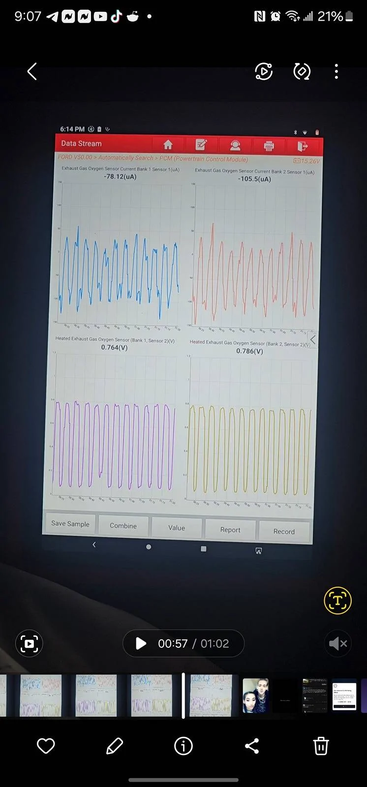

Okay so im having trouble uploading the video. I took a video at idle of the 02 sensor graphs. Is the sensor 1 in amperage and sensor 2 in voltage? I think that's what I'm seeing. Any website I can use for uploading the video like imgur but for videos. Otherwise I can clip it smaller I tried cutting it in half to 30 seconds but that didn't work rither

This is basically what it was doing for the idle for a minute

Did the rear O2 sensors switch like the upstream ones while driving as well?
If that screenshot was taken at idle after a drive, things don't look good for the cats.

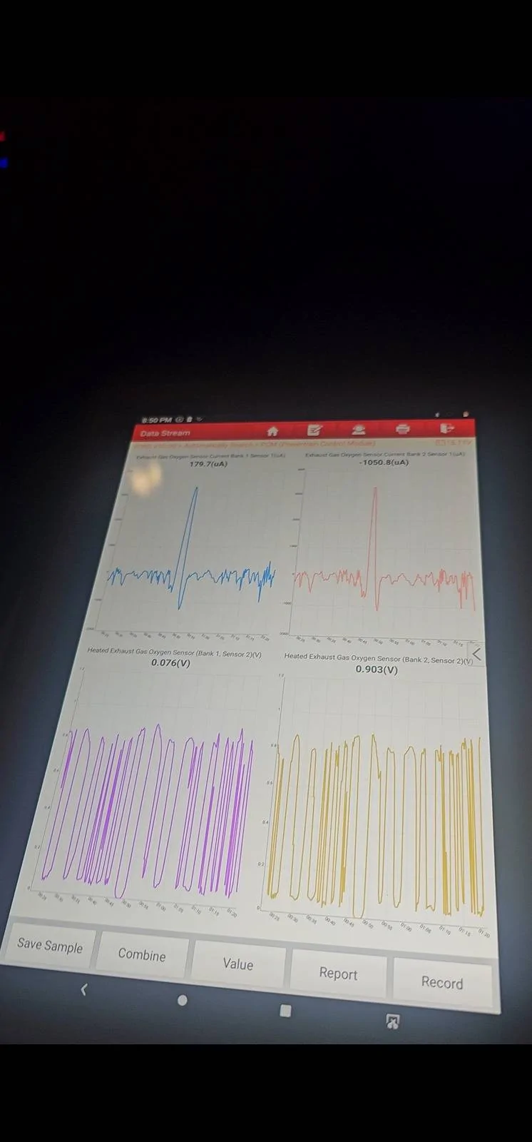

But a screenshot of all 4 at a steady speed with moderate load would help diagnose.
Here's a pic from the video when driving. I was going about 40 mph I'd say. engine was nice and hot. When it spikes up is when I let off the gas. Also no they stayed as (v)

Thanks, yeah, the back HO2S mirroring the front when at operating temp amd under light load shows that the cats are bad.
Since they are mirror images of each other, no catalytic action is taking place. The rears should normally be steady, and slightly high.
Any gas additives used or anything? Really kind of rare to have them both go South at the same time.
