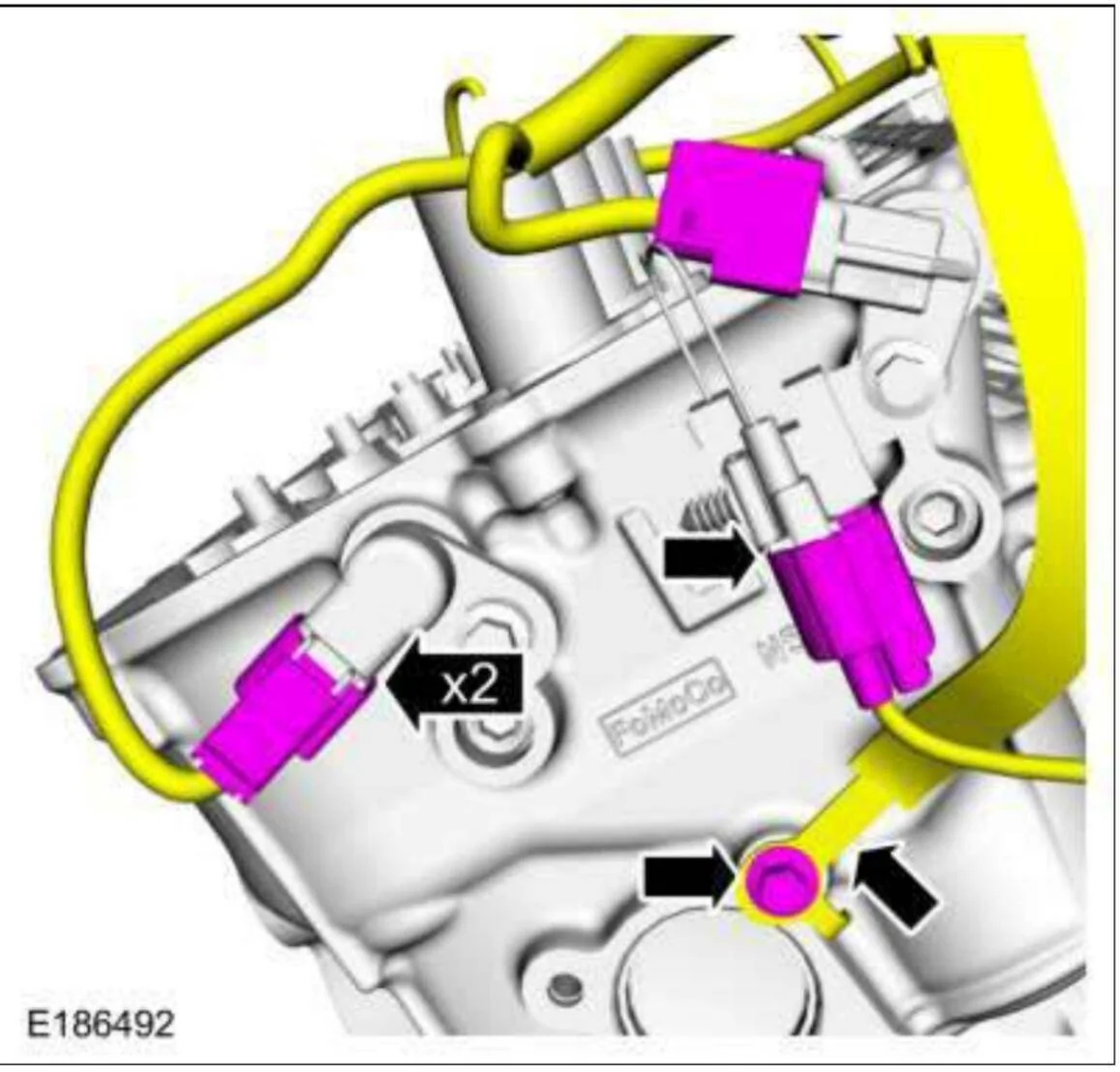

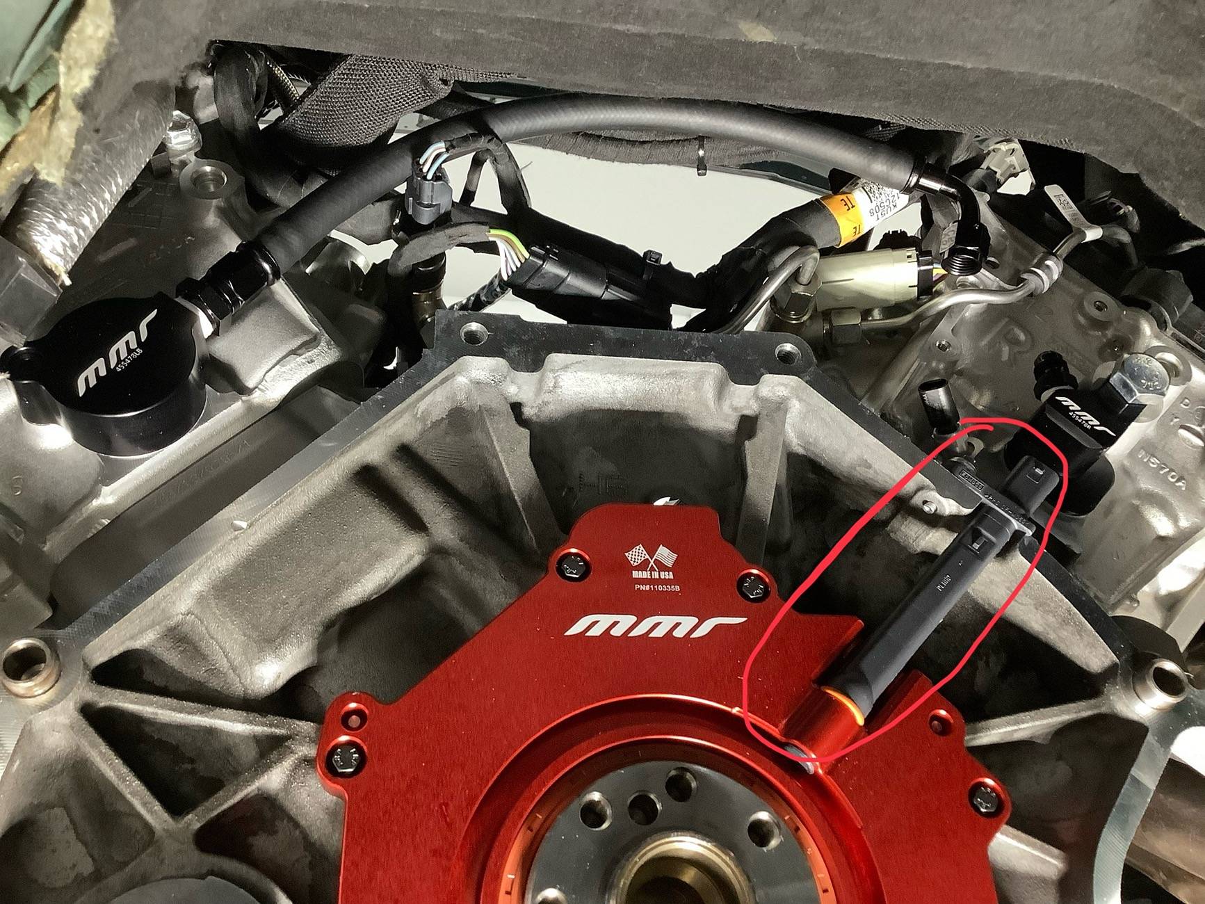

My car has been idling a bit rough and will randomly cut the engine when putting clutch well coming to a stop. My thought is the cam shaft position sensor, but I can’t find anything online telling me where this sensor is so I can replace it. Does anyone know need help fast

Disregard, you said cam position sensor. I can get that for you too. Stby.
