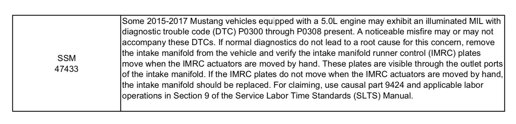

This may help you also:

Yes. The Intake Manifold Runner Controls can be checked without intake manifold removal. You will need the Ford IDS to be able to do this with activating IMRC and monitoring fuel controls for both banks. The fuel trim will change (or dip) if the IMRC are operating correctly. If no change is noted or only on one bank you have found the a bad IMRC requiring manifold replacement
