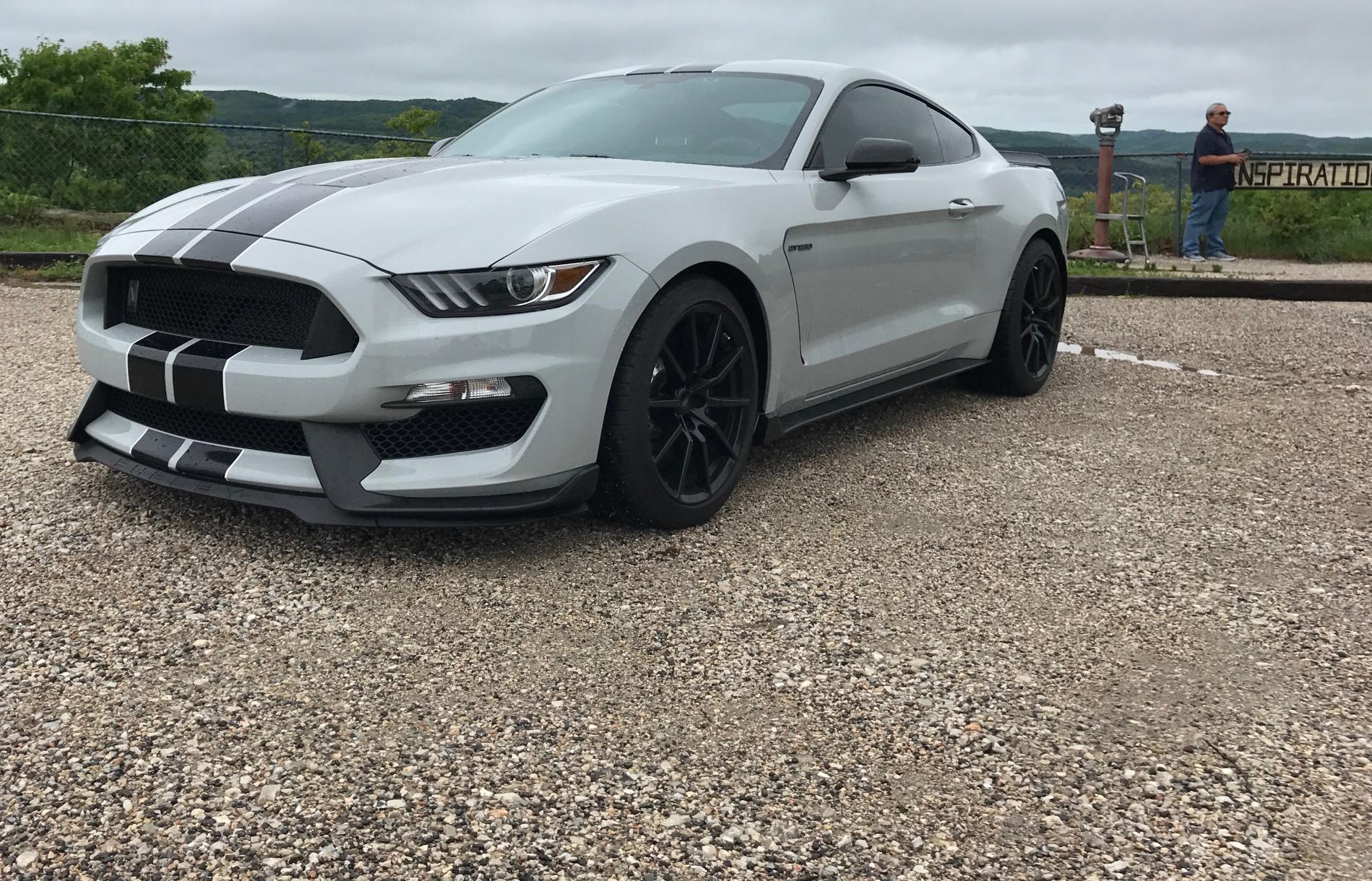

...obligatory first post photo attached!:)
