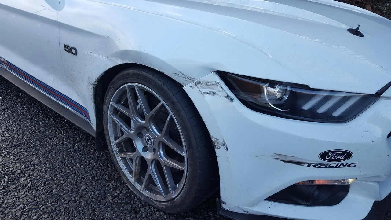

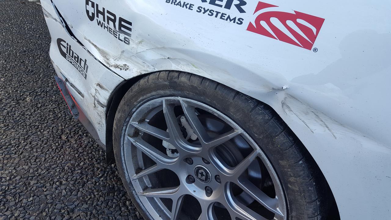

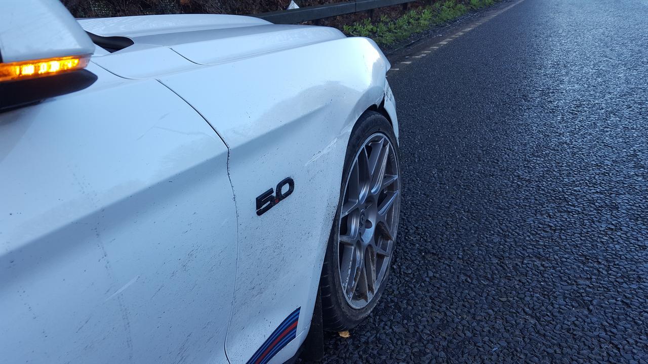

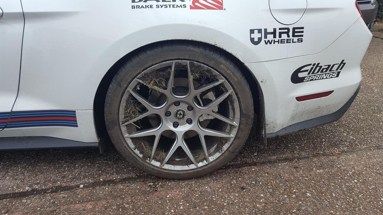

As some of you will know this thread is here to serve as complete a history of my car as possible.
With that in mind it's been a while since my last post and annoyingly this latest entry is something I'd rather not be posting, but...it finally happened. :crying::headbang:
100% driver error and I can't even blame Pirelli as I'm on Michelin's finest. :crackup:
Little bit sideways exiting a roundabout onto a curved entry slip, bit sideways, corrected, didn't realise wheels were still slipping so as soon as I put a bit more steering lock on it broke away again and after a couple of fishtails I was beyond the point of no return and went into the central armco. OSF went flat immediately, NSR went flat after a few mins and then, lucky for me, the police just happened to come past. :crackup: Policewoman was very sympathetic and bullied the recovery firm into turning up ASAP due to the location of the car.
After some to-ing and fro-ing between A-Plan, the recovery firm and the bodyshop, (accident was 19th Dec, perfect timing!) I finally got the car back from some random compound near Fleet services and have started to make some in-roads on the repairs. A-Plan said as I have a modified policy I get to choose where it goes for repair which on the one hand is great as I get the choice (although you legally have the choice with any policy) and on the other is a pain in the arse as I have to do all the running around with it.
I swapped the original wheels (knew it was a good idea to keep them!) back on to find the car was driveable although pulling to the left a tad. I've dropped the HRE's off at my local refurb place to be told they're all buckled, I've had one quote from a Ford bodyshop of ÂŁ7.5K and that was just a walkaround visual inspection so there could be more to come.
It's off for a 4-wheel alignment tomorrow on a Hunter at an accident repair place so hopefully they'll be able to confirm what I suspect which is that there is nothing more serious going on than the bodywork issues.
Onwards and upwards so I will be taking this opportunity to make a few changes, some minor and some pretty major. :sunglasses:

Gutted mate, absolutely gutted for you :(! But atleast you are fine and the car is fixable.
having had an issue with my rear 1/4 it's hollow inside (Two pieces of metal welded on flanges together, so if needs be those can be pressed out and beaten back into shape with minimal filler. Ford will always quote for a new rear 1/4 which is ÂŁ1500 on it's own (Cut old one off weld a new one off, grind the welds flat and paint it) However, everyone i spoke to said this did more harm than good due to alignment of the panels (albeit i had a comparatively small dent from a gate rather than a whole arch buckled in.
Also looking at it there's a new rear and front bumper, new front fender, new alloys, New lower splitter/spoiler (front) - looks like it's broken off to me. and rear arch guards. That's all 'without' looking into the actual components underneath, as you're driving but pulling sounds like the suspension components are 'ok' just check the hub-bearings for any play as that's highly probable. (And possibly a drivers side headlight). But i'm probably waffling shit you already know lol!
If i was you, and as it's an insurance job, cut no corners, get it done whatever the cost is, if it's over a few 000's it's always gonna add a chunk onto your insurance regardless, but moneys the least of the worries at the minute, as long as the car is ok and back in perfect martini order :p

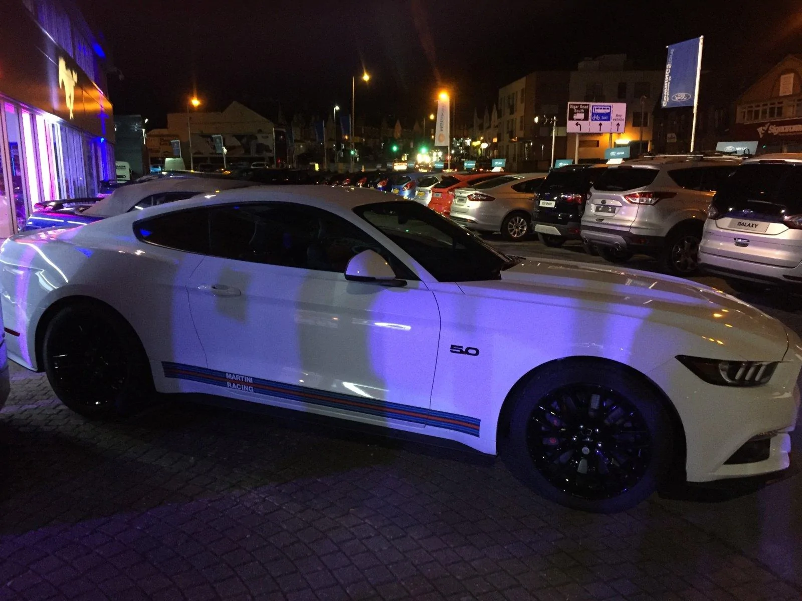

Centurion is this your car
Reading few years ago
Yup, that was the evening where Andy Barratt was supposed to come to! :D
