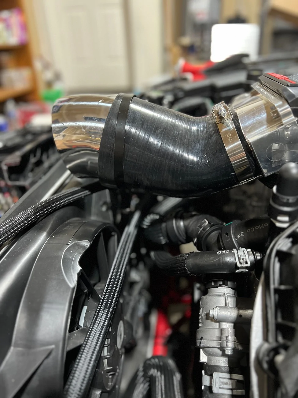

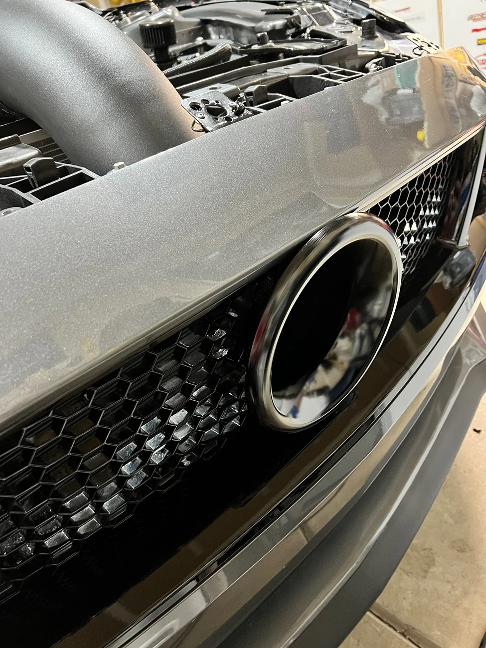

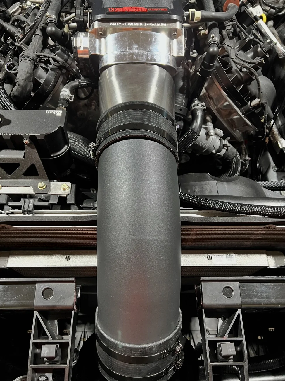

I finally decided to try and make my own OTR intake. I didn‘t have to use the Ecoboost radiator to gain clearance because of the Kaenen “Bubble” hood I run(No hinges or latch, it uses Dzus fasteners). I ended up buying tubing bends that I didn’t use trying to figure out the correct bends I needed. After I was done I found out that Airaid sells a 5” tube with 5 different bends on it….this would have saved me time and money. The velocity stack can be found on Amazon for about $30. Headed to the track on Saturday to see how it runs.
