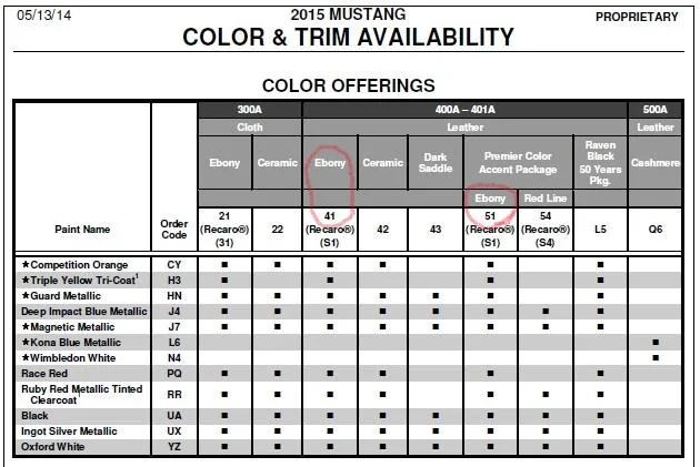

It doesn't sound like they are coding something correctly, 68B uses it's own trim color codes 51 vs 41 for Ebony. I don't know how dumb the system is if automatically assigns the correct code for the the package. I assume that if they enter your trim color as 51 you automatically get the 68B package added. Spare tire should be non issue as well. Available on any car except PP and 20" wheels.

I guess that's the question, i didn't get the performance pack (auto) so does that knock out the possibility of getting 68B (seats coded as 51) just on a regular premium GT? Even the order guide you attached doesnt really say how/on what packages you get the premier accent trim. He didn't say it doens't exist, but was only with a more expensive seat upgrade package (which didnt sound right after reading here). Does the premium trim package cost more? I don't see any indication anywhere it does.

It's pretty clear, the ordering guide is really clear. Unless you ordered the 50th Appearance package (which includes premier trim-soft touch) it is available. Again, I haven't seen anyone get a spare tire, so it may be getting kicked out. There have been constraints on certain parts which is what your dealership is saying.
I attached the entire order guide, it's not real complicated. I think you need to ask better questions. Is it a parts constraint or a coding issue.

Ask your dealer if they are ordering in the WBDO system. If so, they simply need to click on the interior trim box of your order (not the options box), and select the premium ebony leather instead of the ebony leather. That will automatically assign the right codes. Ford recently rolled out a new ordering system that did away with the three digit option codes.
Some dealers still use the old CONCEPS ordering system and that relies on the three digit order codes.

Thanks. I already called this morning and said tell your manager to code it as 51 ebony seats instead of 41 as it was coded. I dont know why Ford makes you choose 41 vs 51 on a premium GT anyway...
I assume that they are using the old system as the printout (vehicle report) I got has the 3 digit codes, so I think my instruction to code the seats as 51 instead of 41 will work (hopefully). My seats were definitely coded as 41 in my order which you could not add the 68B to.

I believe it. Im not budging on the 68B now. I know he coded it wrong at 41 seats instead of 51 which they should have been to add 68B.

Dealership investigated and said can only get the 68B with the 401A trimline. There is no other way to input 68B without upgrading to the 401A. Maybe that is why- mine is a 400A premium GT. I don't know the true answers, could be a part constraint as per below.
At the end of the day it is not much different and no one can even explain completely what is different except perforated/better quality leather on the upper door insert and dash.
http://www.mustang6g.com/forums/show...date-5919.html Looks like the part needed for 68B is constrained too if I am reading it correctly- "Soft Rollover & I/P Stitch." Could be part of the cannot get with a 400A right now (or maybe at all unless you want to wait for your build).
Looks like its been since early October too http://www.mustang6g.com/forums/show...g-10-4428.html
Perhaps there really is a block-out of ordering 68B right now? Not going to wait months extra to get perforated leather inserts on the door and some contrast stitching on the dash. Not worth it.
