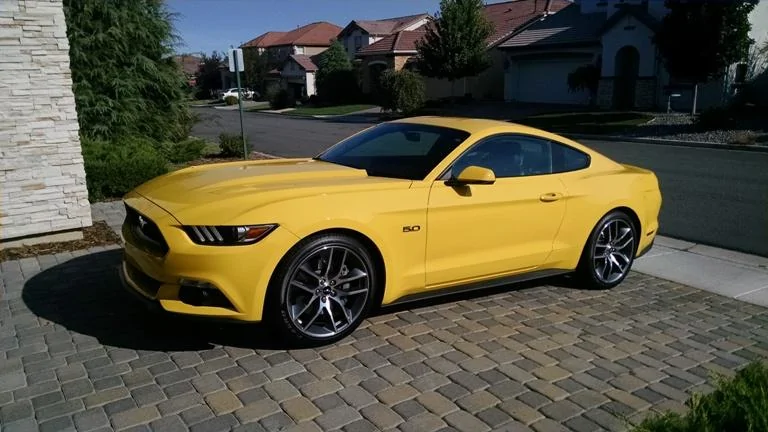

My car came with factory 20's and I switched to the DWS 06's in 275/35/20 square set-up. I then went with some SVE Series 3 wheels 20x8.5 front and 20x10 rear, and still using the same 275/35/20 tires. Car rides and handles just like when it was stock, just way better wet/snow traction than the P-Zero's.

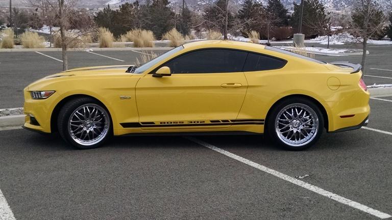

I'm running a 275/35/20 on an 8.5" wheel in the front and the fit is just fine. The sidewall on both front and rear look about the same, the rear wheel just has a much wider looking lip. Tires have performed well and I have no adverse effects of the wider tire on the narrower rim.
