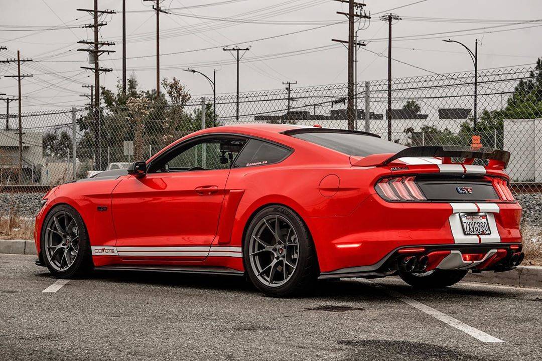

Hey this is Junior from Project 6GR, regardless if it's a ecoboost or GT the body is the same. We have found for S550 mustang nice flush fitment with no rubbing would be a 20x10 +35 275/35/20, 20x11 +50 305/35/20. Same exact wheel and tire specs are applied to 19" wheels as well. If you have any other fitment questions feel free to give me a call, I would be glad to help!
Here is a photo example of our 19" wheel setup.
