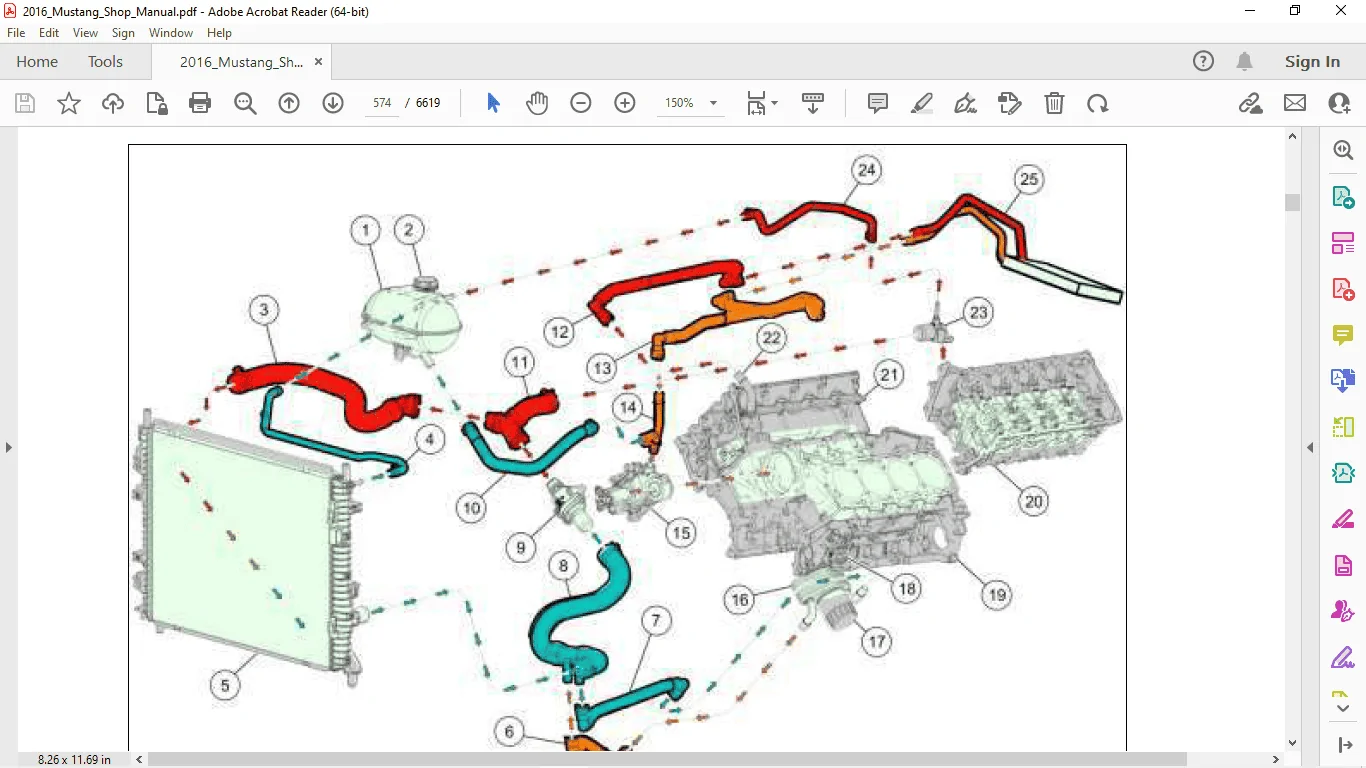

Looking at the System Operation page of the cooling system. The engine and heater coolant are separete. The quote below is from the Service Manual. Like SK47 stated, the heater is getting warmer coolant before the rest of the cooling system does.
"Engine coolant flows primarily from the engine to the radiator circuit and back to the coolant pump. Coolant is sent
from the coolant pump through the engine block and cylinder heads. A separate circuit from the engine also feeds
the heater core with coolant"
Yeah, AFAIK they're always separate. The question is if the coolant in the main radiator and the heater core are temperature regulated differently, and I don't think they are.
I think they're the same temp all the time, especially since there's only one thermostat.
Hello; Yes two somewhat separate circuits of coolant flow. They do share some common components such as the water pump and coolant.
It is my understanding the thermostat is the gateway between the two circuits as both circuits share the same coolant. On a hot summer day the thermostat will be wide open, and both the radiator and the heater core will be doing the same job of shunting excess heat to the outside air.
My guess is engineering for hot weather with the added load of an AC is the harder thing to do. So, taking longer to warm up in winter may be a partial price to pay in order to have decent cooling during hot weather?
Looking at the diagram, it seems as though the heater core gets coolant directly from the R/H cylinder head. So, I would assume that the heater core would get warmer coolant faster than the normal cooling system. The diagram is from a PDF copy and doesn't show the fine lines connecting the arrows. Heater hose 12 gets coolant from 22, which is the discharge from the R/H cylinder head.
