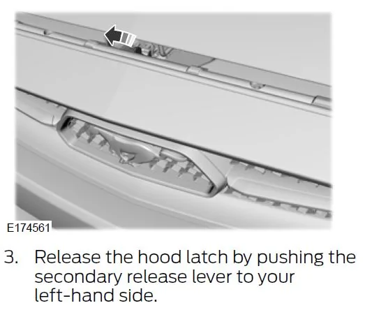

I'm trying to check the oil and I can't open the #%^#| hood! Yeah, I read the manual. I pulled the latch down by my left foot, and the hood popped up about an inch. Stuck my hand in to move the secondary level to the left, and the only thing I can find is a single vertical bar that simply won't budge! I am sooooo frystrated right now! Am I doing something wrong? Is there some sort of trick involved? :frusty::headbonk:

YOu can't lift the hood but an inch up to get your hand in there, if you push the hood up that inch as far as it'll go, you'll put enough tension on the latch it wont budge.

Turn your hand to face down. There is a little yellow lever.
Got it! Thank you SO freaking much! :hail: Now why in the heck couldn't Ford have put that simple little statement in the manual??

Had the same thing happen the first time I opened it, guess all my other cars have had the latches that stick up a bit more.

Yeah, palm down, who would have though. I'm hoping I'm past the learning curve.
