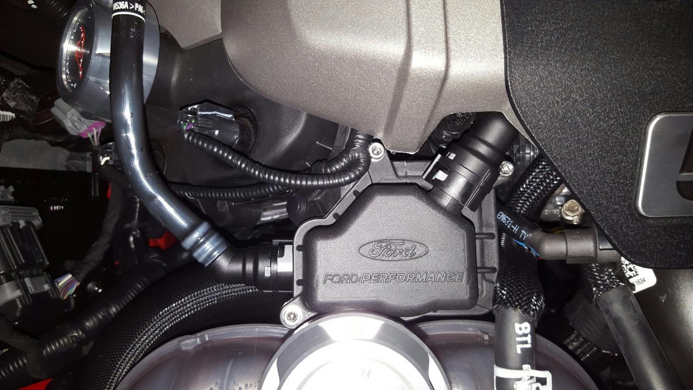

Anyone work out if the Ford Racing Oil Separator fits RHD?
Here is photo of my one fitted. Super easy to install. Just need to take off the cowling cover on top of the engine. It clips off.
Is that installed on the driver's side of our RHD cars?
In other words, is this the "(M-6766-A50) Ford Racing Passenger Side Oil-Air Separator Kit"?
EDIT: I've now read the whole thread, learnt Port vs. Starboard, etc, etc, and concluded that this is the part I need...
Looks good, how easy is it to empty. The UPR one I've seen in real life is easy.
Yep spot on. Because we are buying items from the USA and they make mention of passenger side it means the drivers side of us for a lot of items.

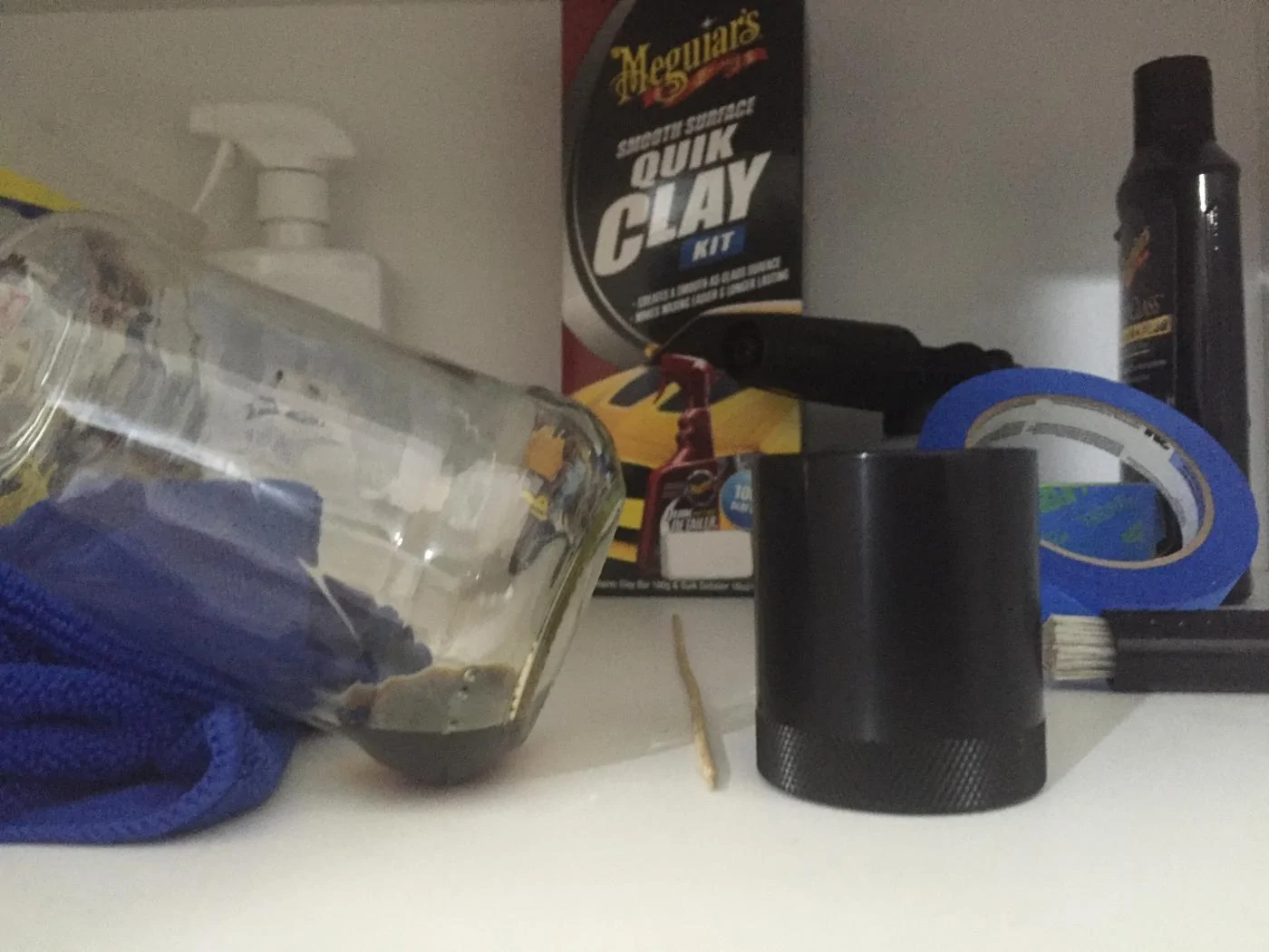

picture of oil from Catch Can (JLT) installed from new to 1005km.
Definitely agree.
Ordered mine - JLT - from CJPony last Wednesday night and got it delivered yesterday. Great service.
