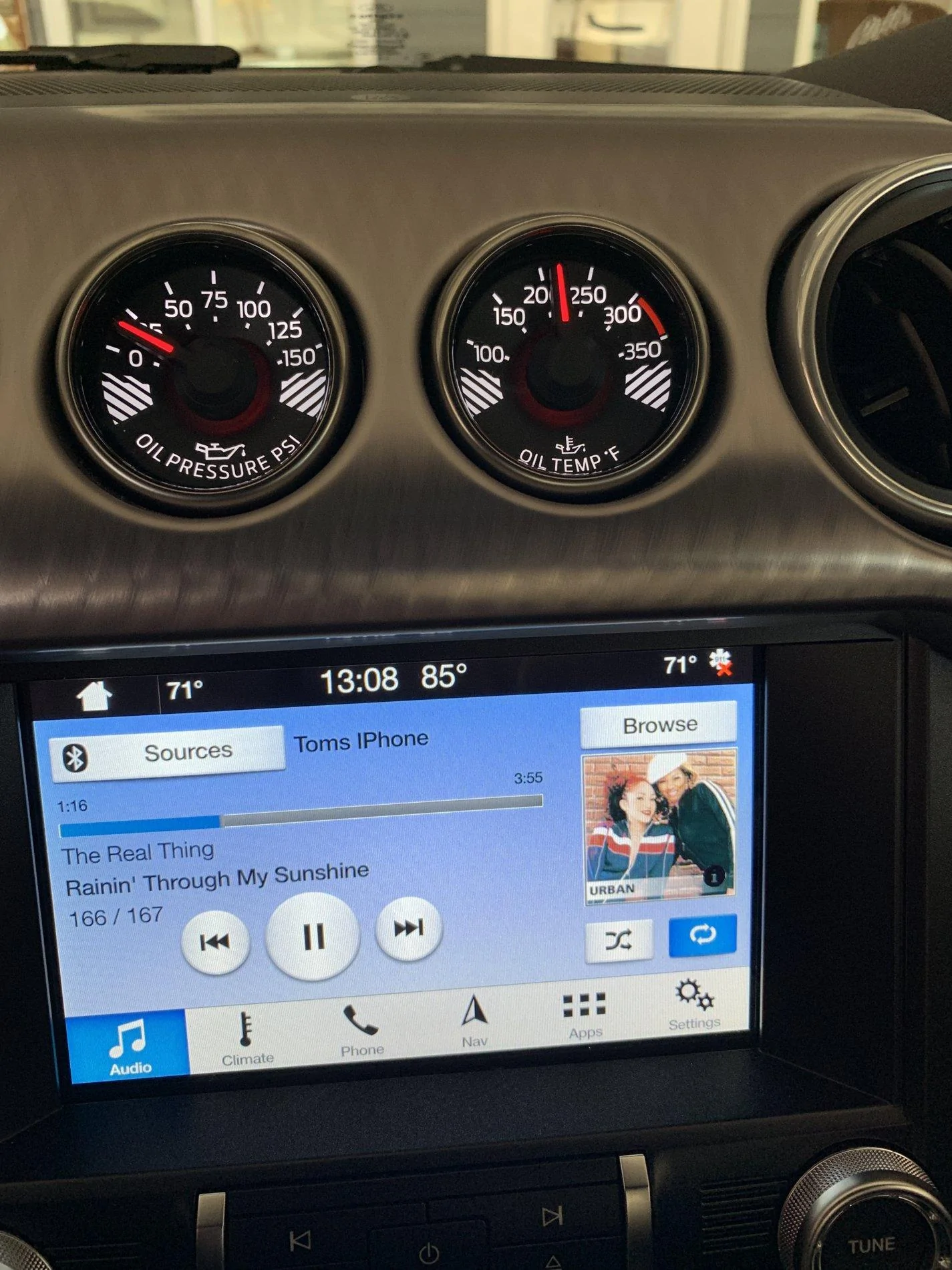

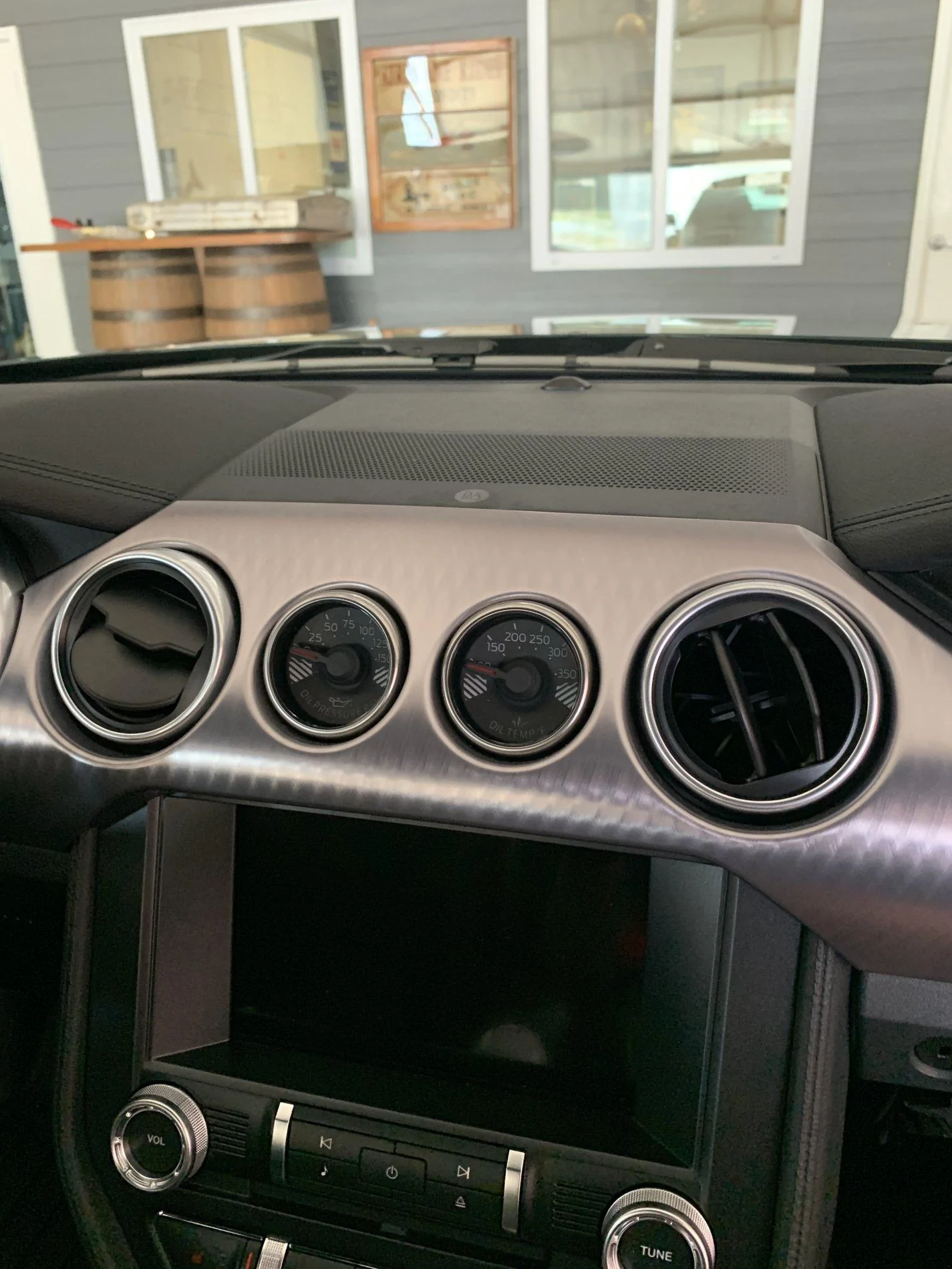

Just buy the center gauge cluster from a GT350. Less than $250, pops right in, plug and play on the connectors, has oil pressure and oil temperature. Only thing it doesn't have is that MyColor isn't supported. It stays white-on-black all the time.
As far as I can tell, my center gauges stay white-on-black all the time in my Bullitt. Dunno if this is typical of 'later' cars--mine is Bullitt# 2937--or maybe I'm missing something?
Have you set a custom gauge color using MyColor? And, granted, they only change at night even with MyColor active.

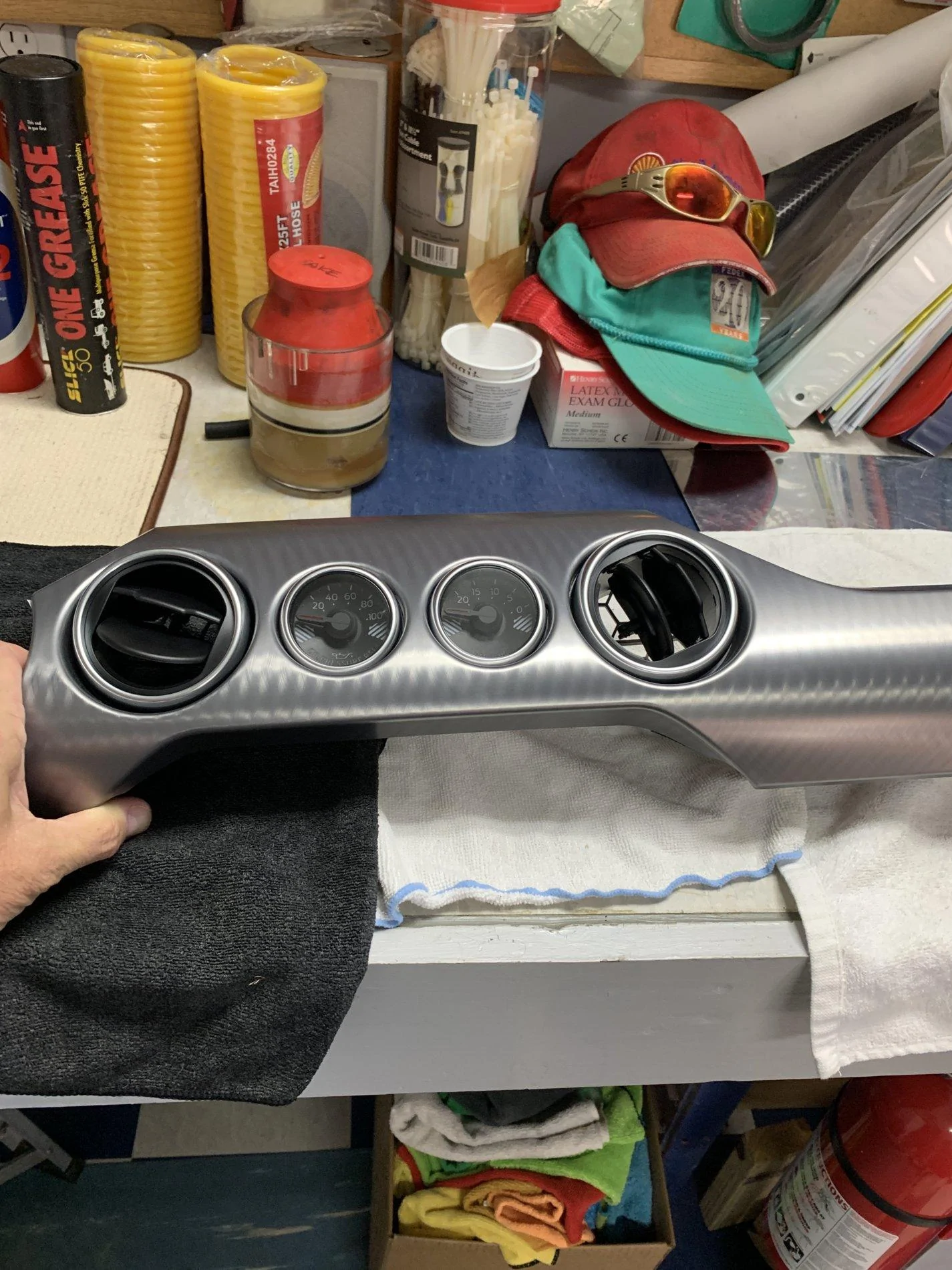

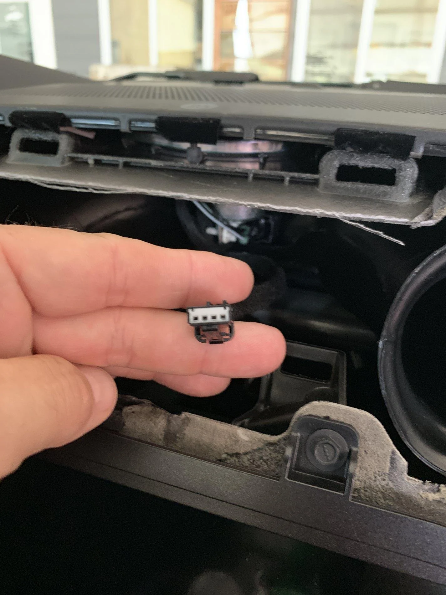

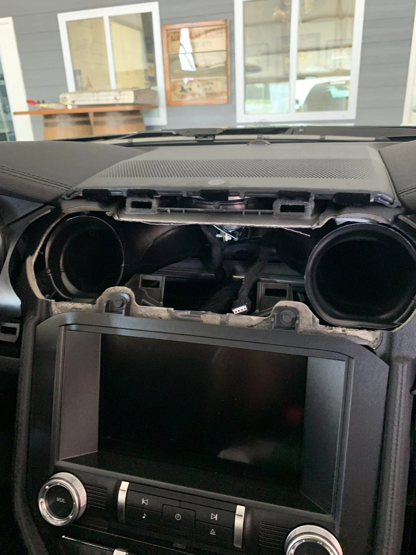

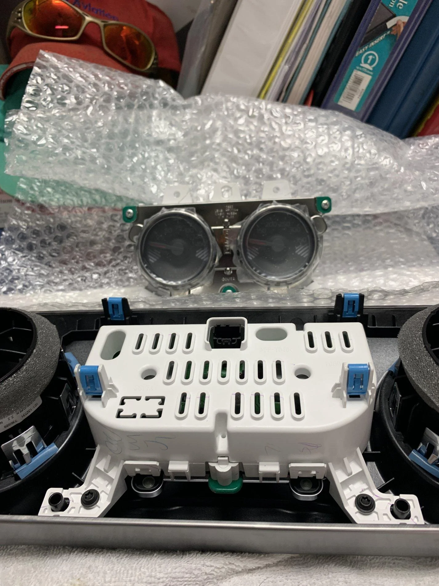

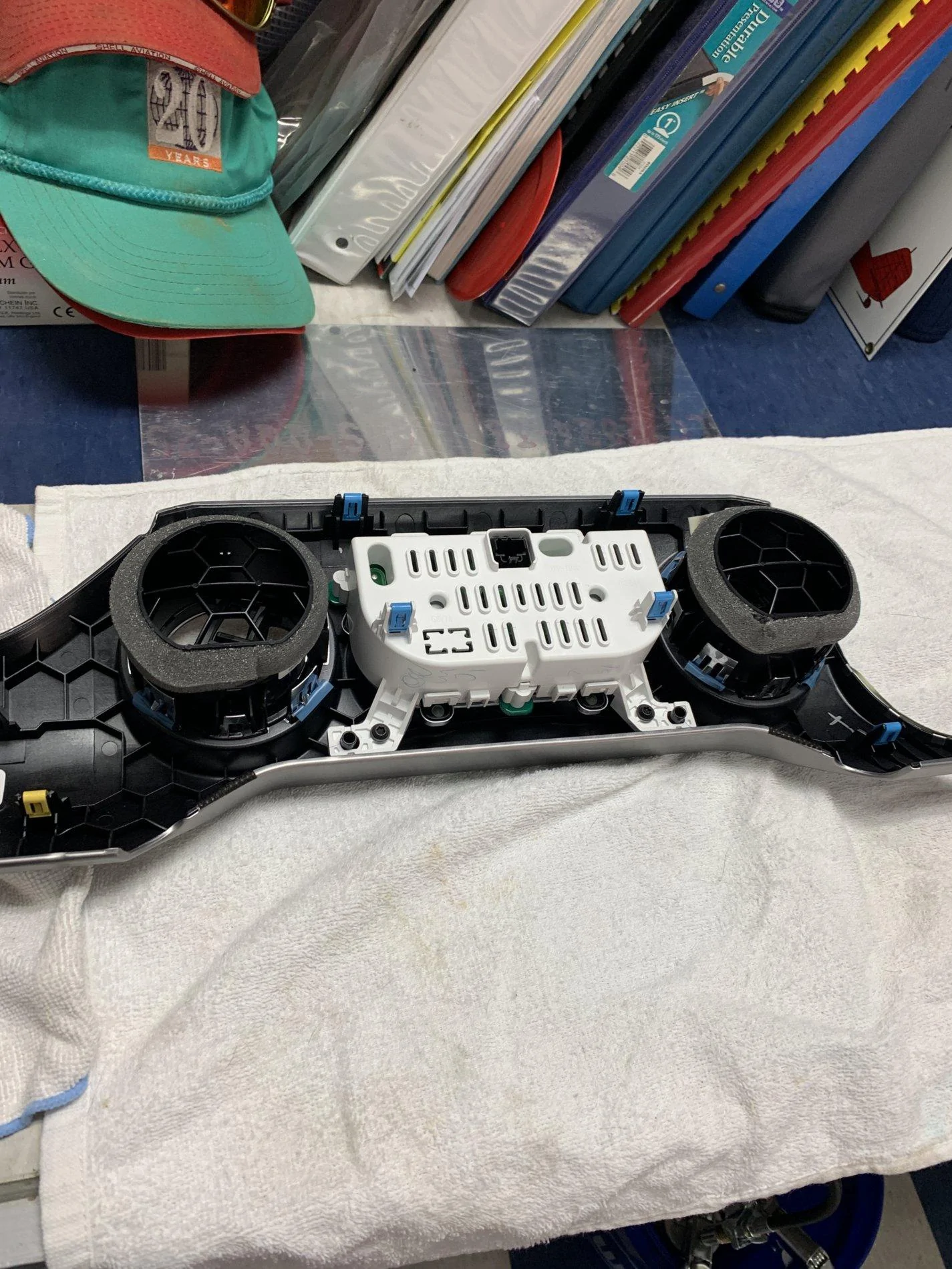

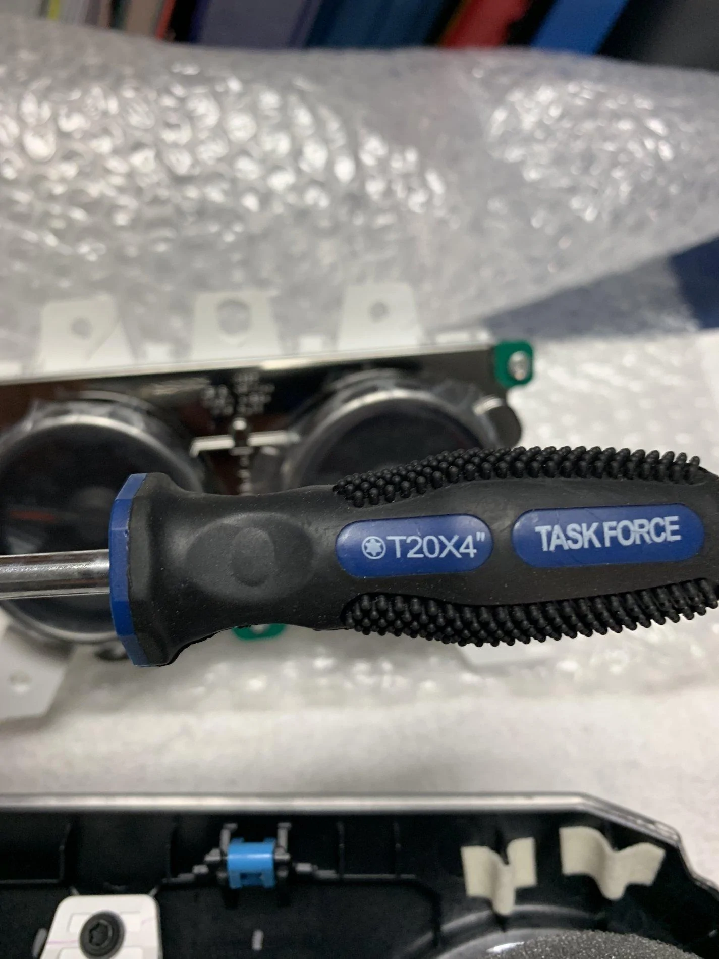

It's fairly easy. You need to carefully remove the trim, starting at the passenger's side and working across. It's all pop-clips, but some of them can be kind of snug the first time they get pulled. Use a trim tool and take your time.
The two gauges are on a single circuit board held on to the dash with a couple of screws. The harness is plug-in and it works, no coding needed (unlike the BMW, where even something as simple as a battery change requires hooking up to a computer to "register" it).
Some people also swap the chrome trim rings around the gauge faces with their original ones as well, as they think it's a better match for the overall panel. Strikes me as going a bit far, but YMMV.
OK, figured it out. The colors--in this case 'Primary Color'--only change with the lights on (in a dark garage). The gauges DO change color. Thanks.

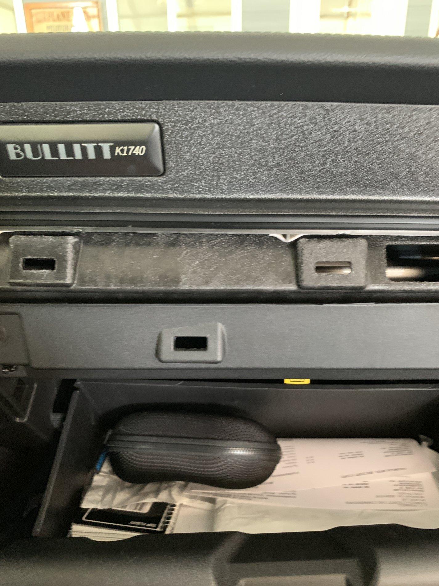

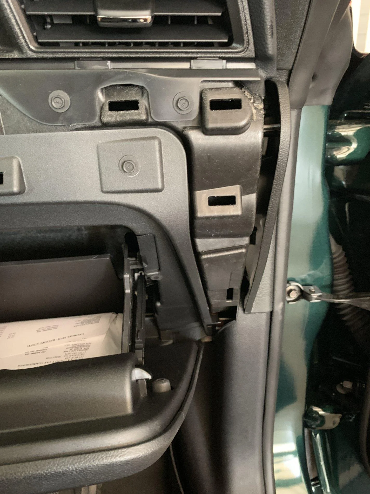

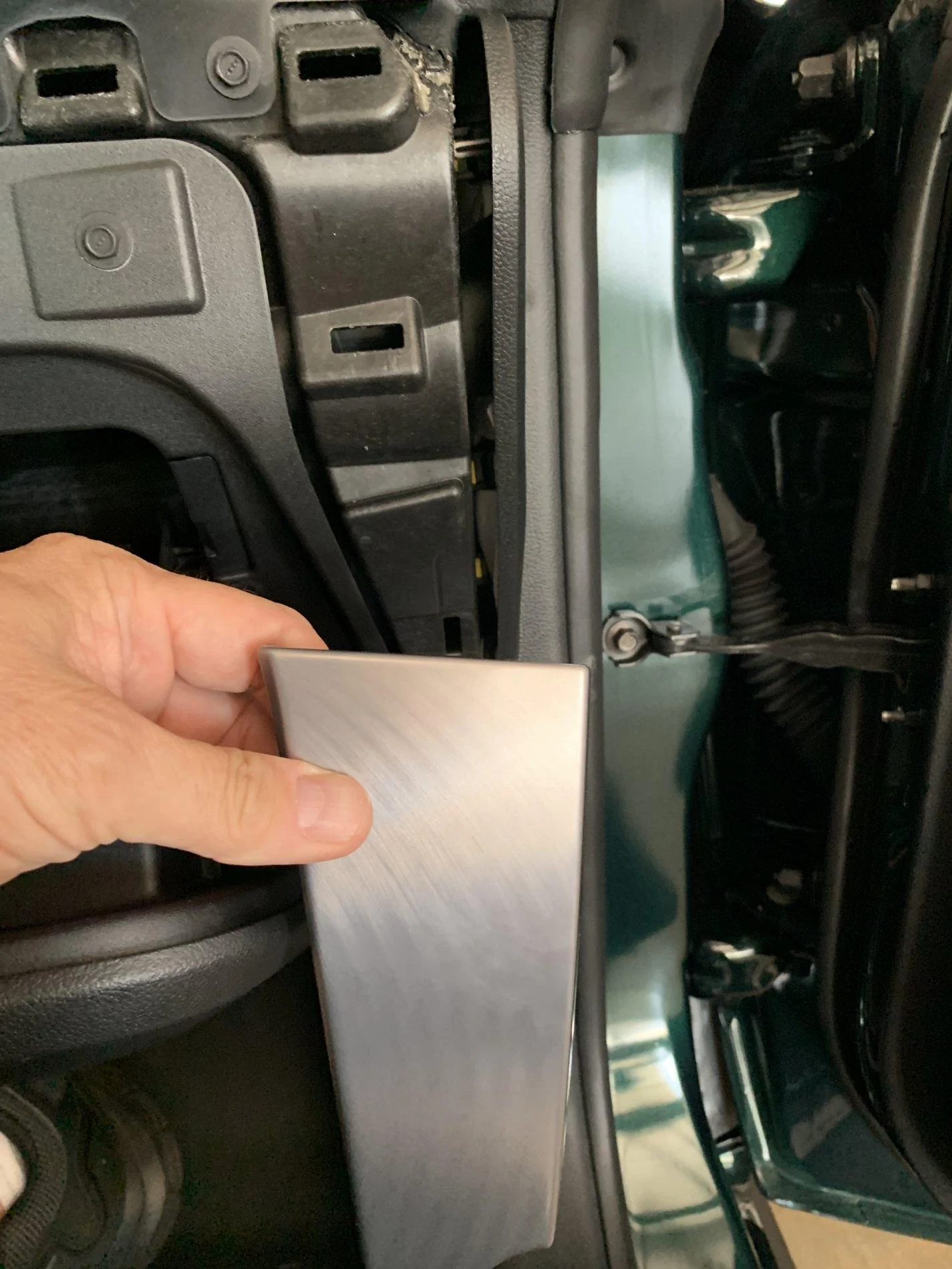

I have my GT 350 OP/OT gage waiting for me to install it - apparently I don't need 4 spare hours! Do I remove the small trim piece to the right of the glovebox first, and then gently pry the main trim piece off? I might wait to sober up [a little]; it's been a beer sampling afternoon...
Thanks Tom; no excuse for me to not install the damn thing now :crackup: I can't believe Ford had the right cluster in their parts bin, but instead chose to give us the 110% worthless vacuum gage instead. Probably the best $250 I've spent on the Bullitt.
Also, special thanks for the pics; always nice to know what I'm about the break.

yeah - open the glove box and work that small piece off. I then worked from right to left along the bottom and it pooped right off. The lock on the clip for the wires is on the bottom. Plug and Play! Let me know if have any questions! Already cracked a cold on! A Toast to the BULLITT owners and guys like you and me Aileron who suffer from the diseases of fast air and ground machines!!!
