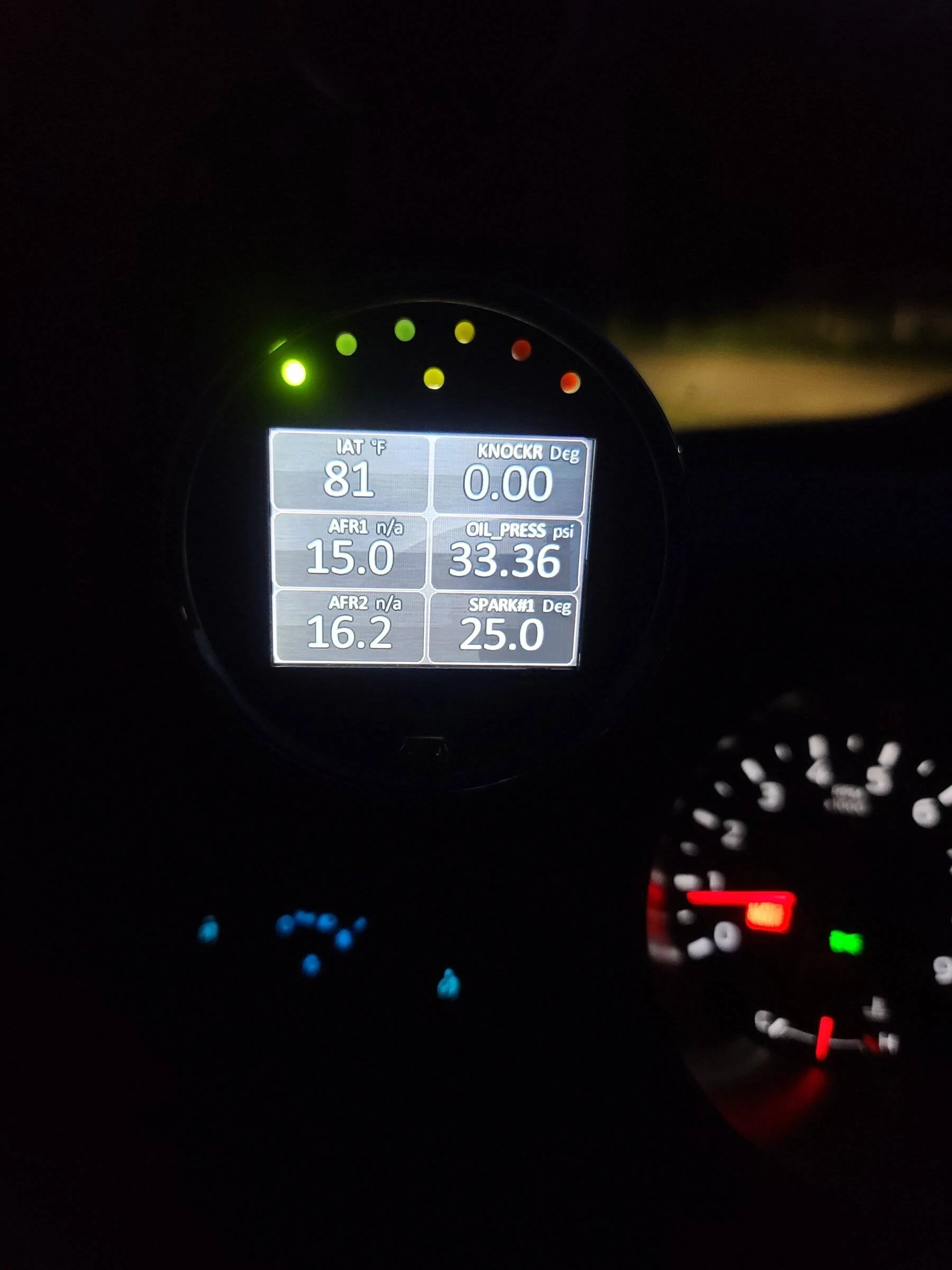

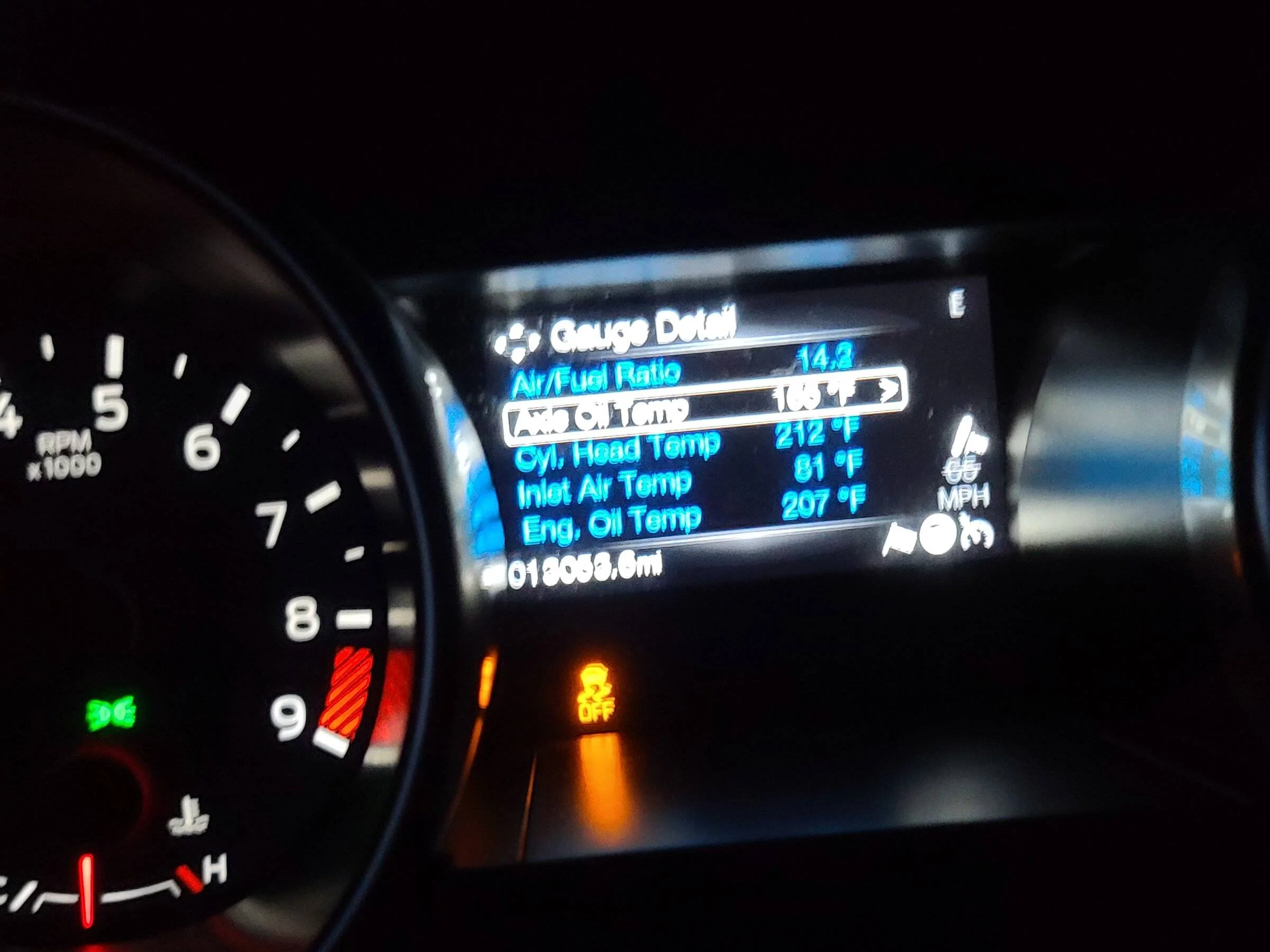

just some oil pressure reading y'all might find interesting
these are cruising in 5th at 65mph the glowshift gauges are plumbed to the back of the heads

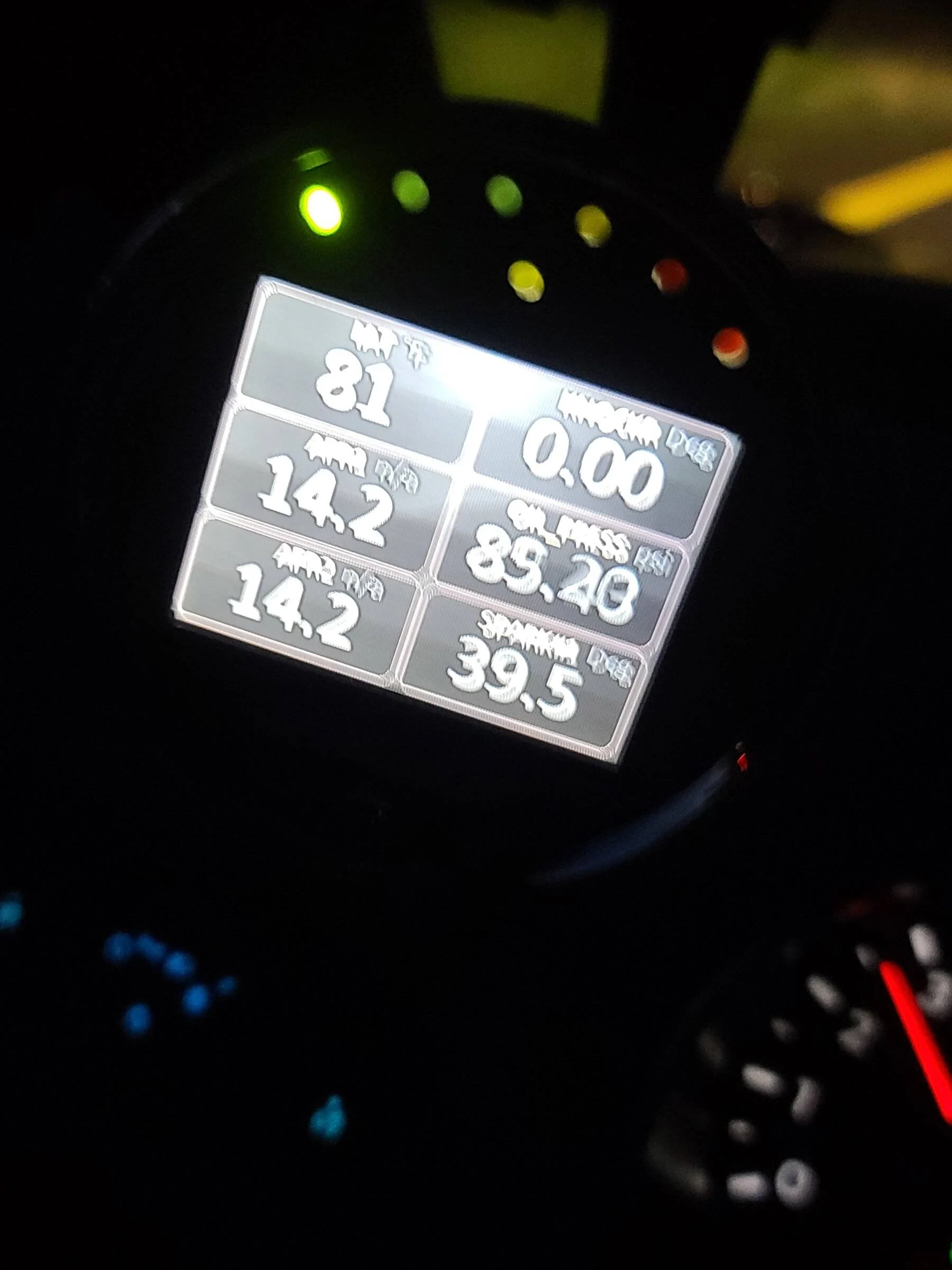

and this is at an idle oil has 500 miles on it and cold startup is always at 120 psi

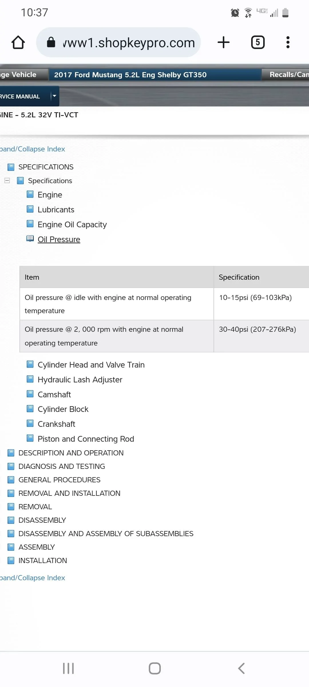

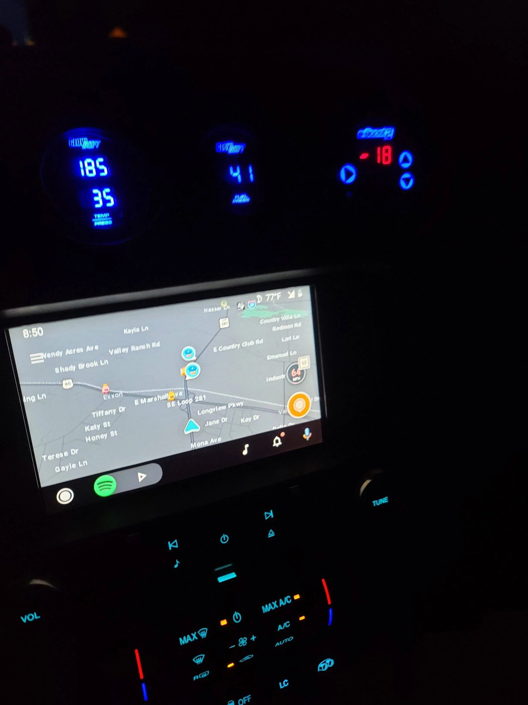

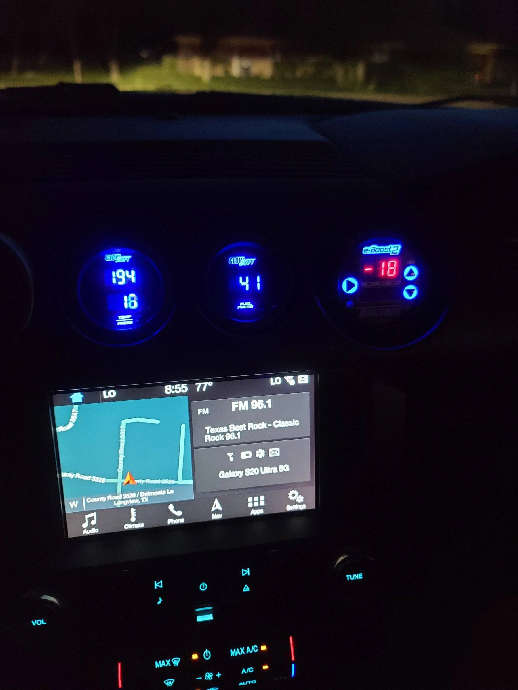

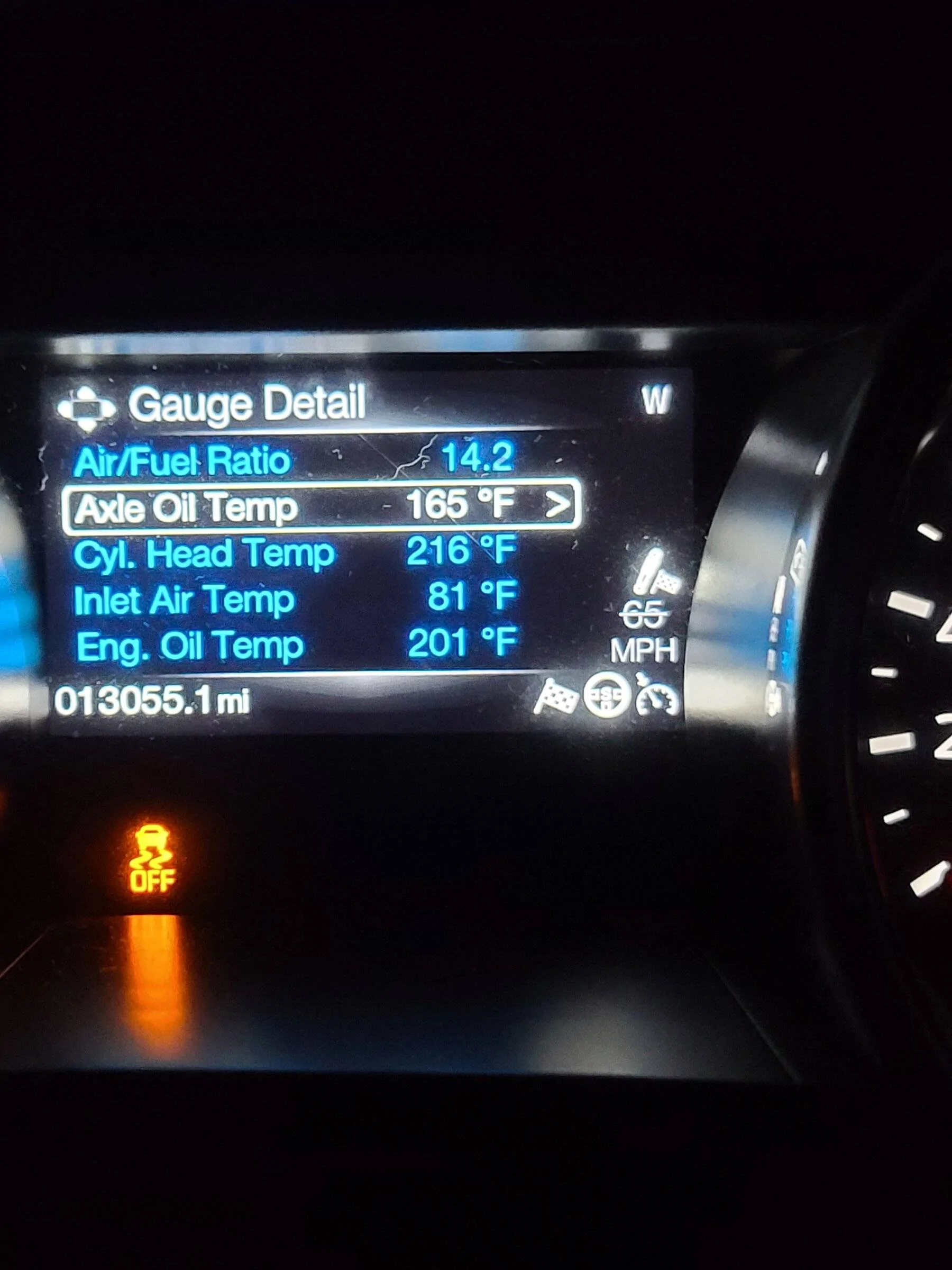

it's in spec but it's just a warning to others that if you're main oil pressure gets low you will be starving the top end you can see the pressure difference between the sensor by the oil filter and the sensors I have in the heads also the temperature difference
