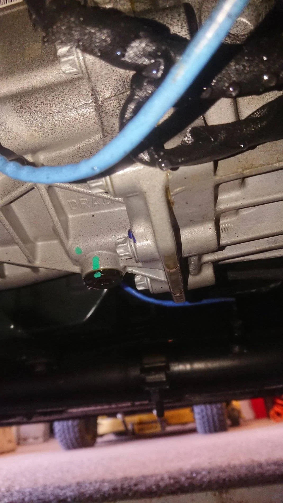

My bad luck seams to continiue with my Mustangs. My 2015 gt had a bad paint jobb from the factory, i bought it new. The half of the car got repainted. This spring i traided it for the bullitt
Now the saga continiue. The bullitt have a gearbox leakage, noticed som drops of oil when i looked under the car. Tok it to my lokal dealer today for investigation, and yes they confirmed that it has a oil leakage. Now the gearbox neads to be teard down and new gaskets put in.
O Happy days.
ATTACH=full]414858[/ATTACH

Yup the warranty covers it. But it really sucks, a new car with only 1200 miles on the meter and it neds a transmission repair. I start to Wonder what the f.. ck ford are doing. There quality control sucks.

Update on the oil leak
My Bullitt has now returned from the shop and warranty repair. It was an easy fix , turned out to be the air breather hose frome the transmission that was not properly seated. The transmission never had to be removed, the shop managed to fix it mounted to the car.
Interesting, I will have to see where this located and take a look next time it is jacked up.
Thanks for the update :thumbsup:
