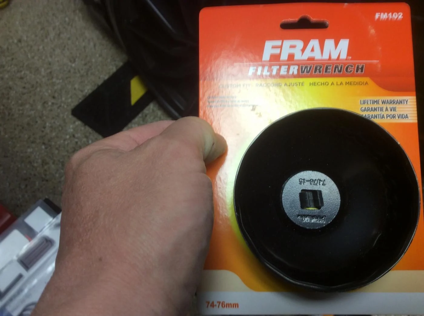

Can any repost the specs on the proper wrench required for our (motorcraft) filter?
I remembered someone posting a picture of the wrench and package but that photo is now unavailable.
I believe the motorcraft is a "14 flute".

Exactly what I was looking for...Thanks Steve!

Evercraft 776-9007 @ Napa
There are a few on Amazon as well. 14 flute, 76mm

I've seen that it is a 14 flute, 74 mm... Any input would be helpful..Thanks in advance
Jim, i think a 14 flute fits both 74-76 mm filters. This is mine and i it fits my Shelby Motorcraft like a glove.

If you have trouble gripping the filter with that style wrench to loosen the factory torque, slip a piece of paper between the wrench and the filter on one side to start. If you still have problems put paper over the entire end of the filter.

Correct Oil Filter Wrench
The Correct wrench is 74.2mm, ABN 8626. Available on Amazon for $12. No need to put anything in between the correct size wrench and oil filter.
