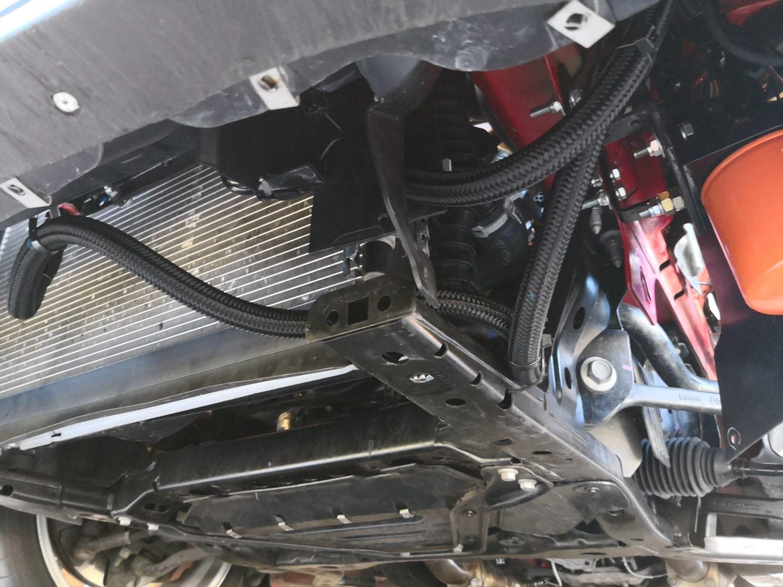

How secure are the rubber hoses at all of the fitting junctures once installed?
Only asking because it would seem to be a maintenance concern to monitor for possible leaks.

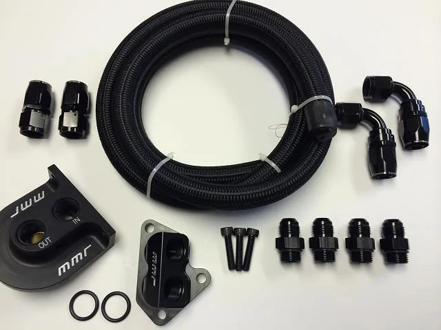

These are braided steel lines. They simply have an additional black nylon weave on the outside. Hoses like this do not require any maintenance.

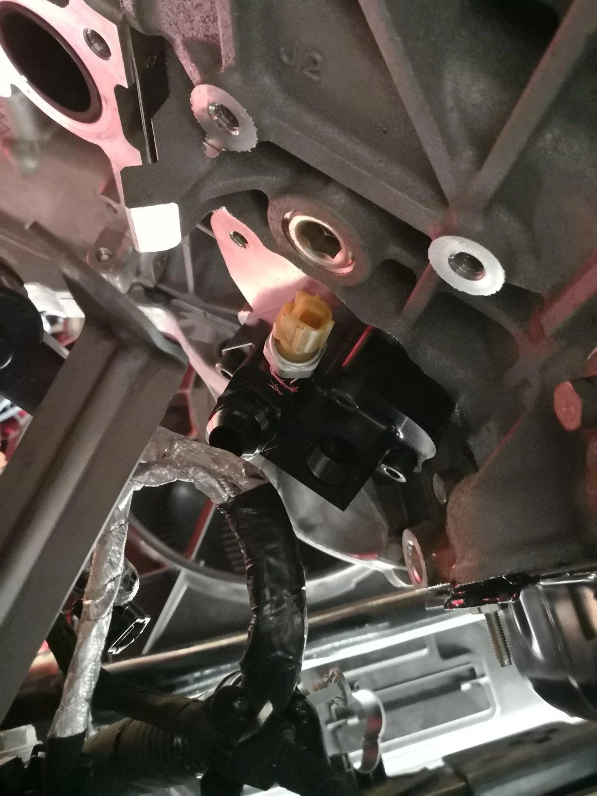

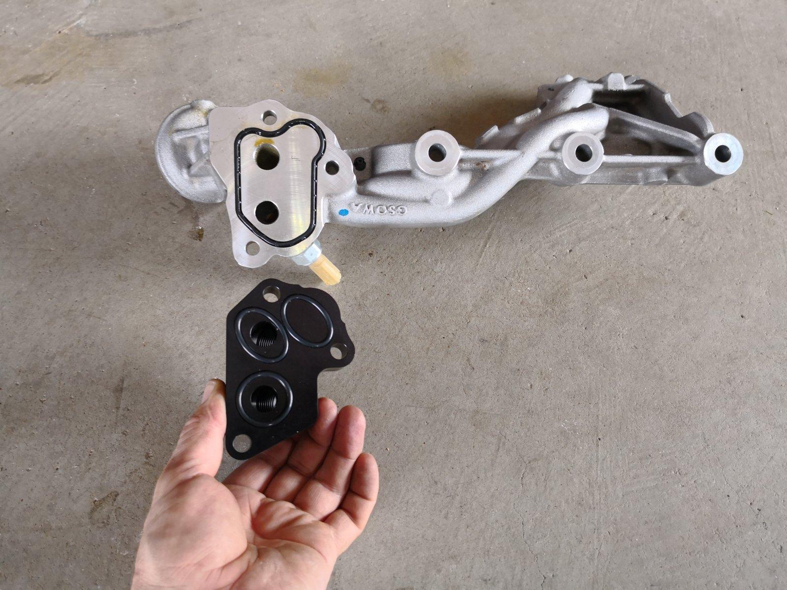

I have this kit on my eu/au mustang here in Australia . Well worth the money, no matter how hot the day is it still sits just under half temp wise. You do however need a lhs US engine mount once the factory oil manifold is removed, easily sourced from CJ's.

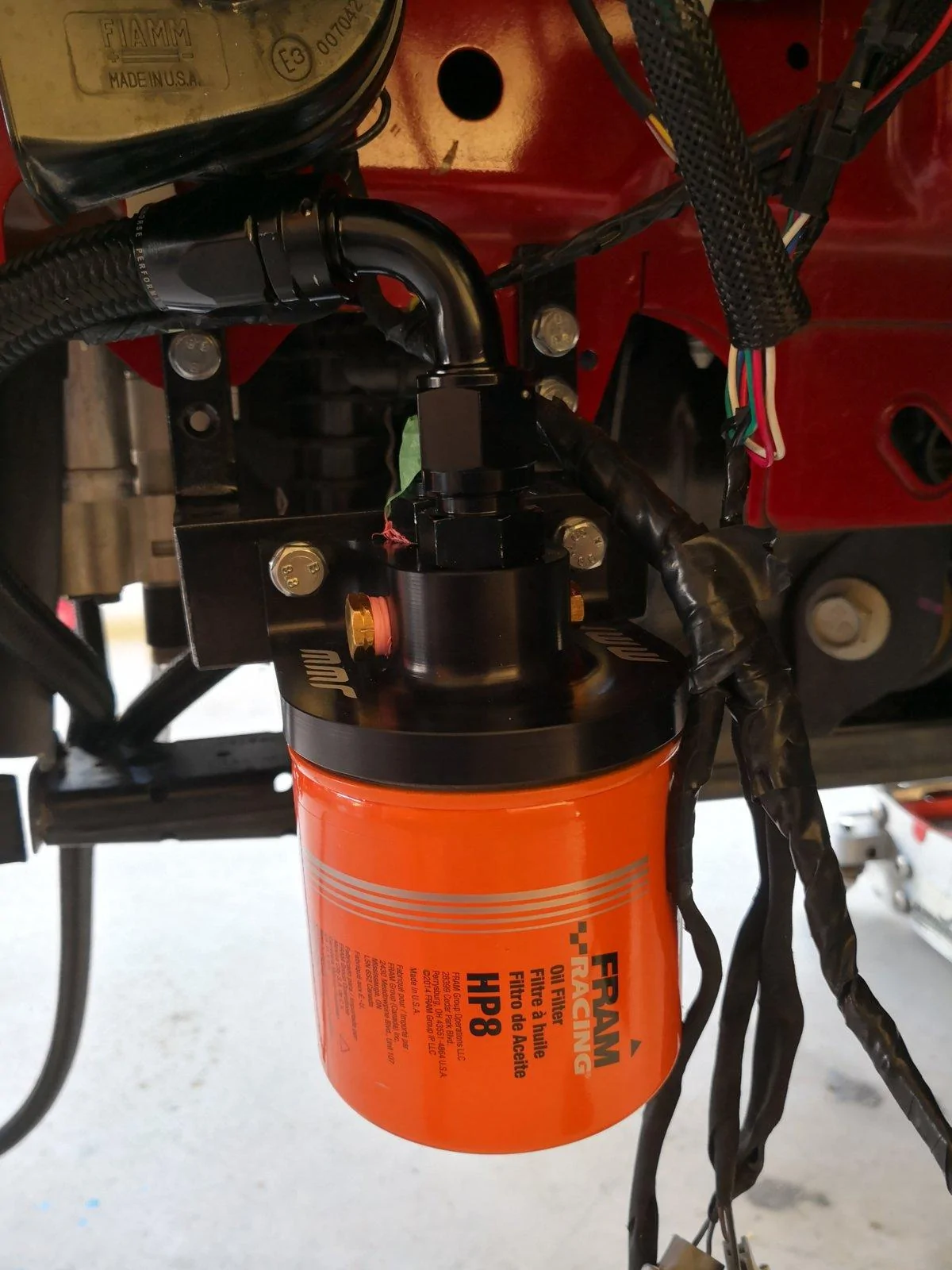

A few pics of the install.
