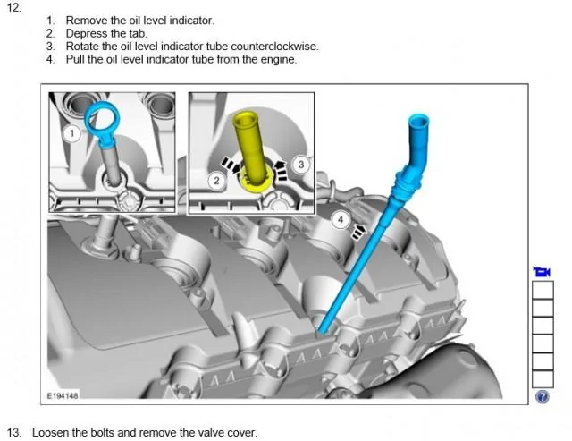

I'm posting the correct answer here - I figured it out and also later found the shop manual reference for it also. I'll post them below - whatever you do, DO NOT do what someone suggested below and pull hard on the dipstick tube - it WILL break and drop into the bottom end and the rest of your day will be an expensive and aggravating investment into fixing the damage it will do.

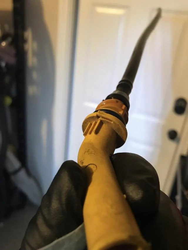

Ok - so I love the idea of sliding off my heels and grabbing hold, but I didn't want to break it so I decided to do this instead...
It's in the worst possible place when you have a fuel pressure regulator, etc etc etc in the way. All you have to do, BEFORE YOU PULL THE VALVE COVER OFF, is use a small flat head screwdriver in the top left corner of the yellow dipstick tube where it meets the black plastic area of the valve cover and twist the blade slightly against the detente you can see in the picture I took. Then gently rotate the yellow tube portion counterclockwise. It's damn near impossible to see this detente if the valve cover isn't lifted up first, but this is what it looks like removed so you can see it clearly.
That's all there is to it but it's hard to find that little nugget of wisdom online. Then GENTLY slide the oil dipstick yellow part up and out and it will bring the brittle black plastic tube up with it. When it's re installation time, just repeat this in reverse order, turning the yellow tube clockwise until it seats (no screwdriver needed obviously.)

Also found this - for a less words / more pictures representation of it.
