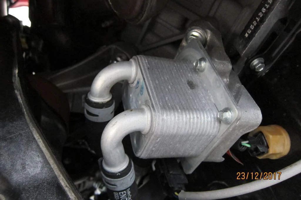

I did a service on my car today and took a photo of the oil cooler looks OK at this stage.
Do you by any chance have a wider pic of your car showing the cat and the cooler?
I could do a shot of my sept 16 car from the same angle and look for any visual differences.

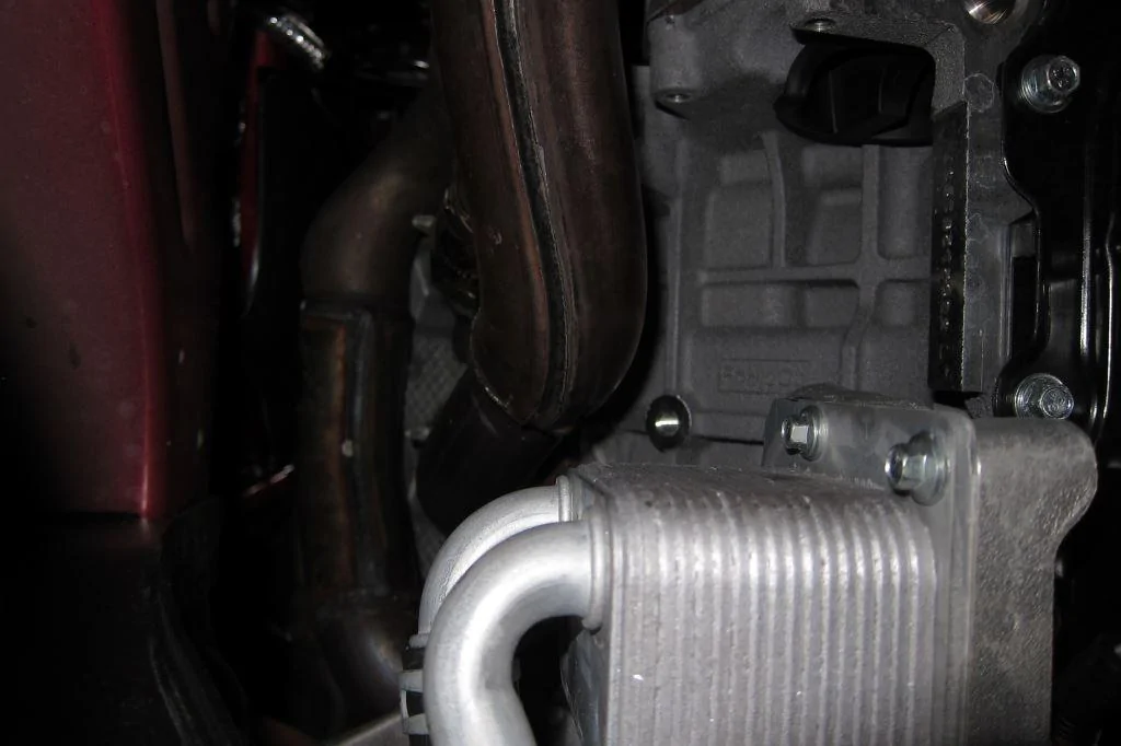

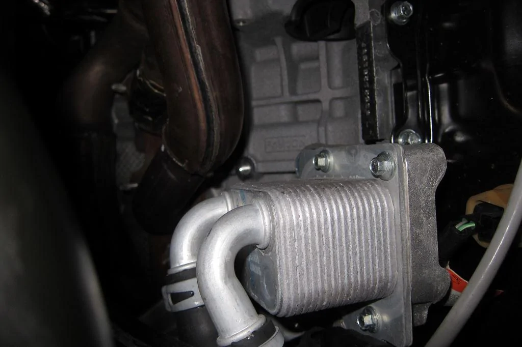

Here are the photos, hope they are some help? good idea.
