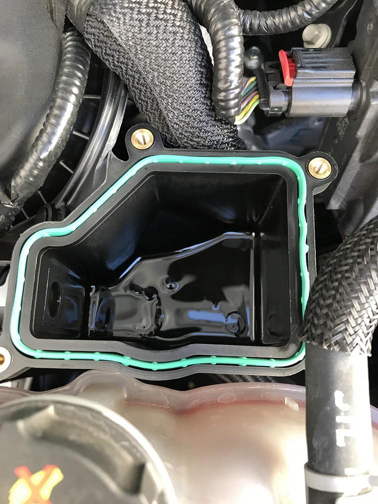

01/03/18, 5706 miles, checked catch can and oil level. Oil level still at top mark on dip stick. Thin layer of oil in catch can.
Consumption has stopped. She was consuming 1 quart about every 750 miles. Zero oil consumed in 318 miles. In theory the level should be halfway down the hash marks. Still dead even with the top hole.
Thin layer of oil in catch can after 161 miles.

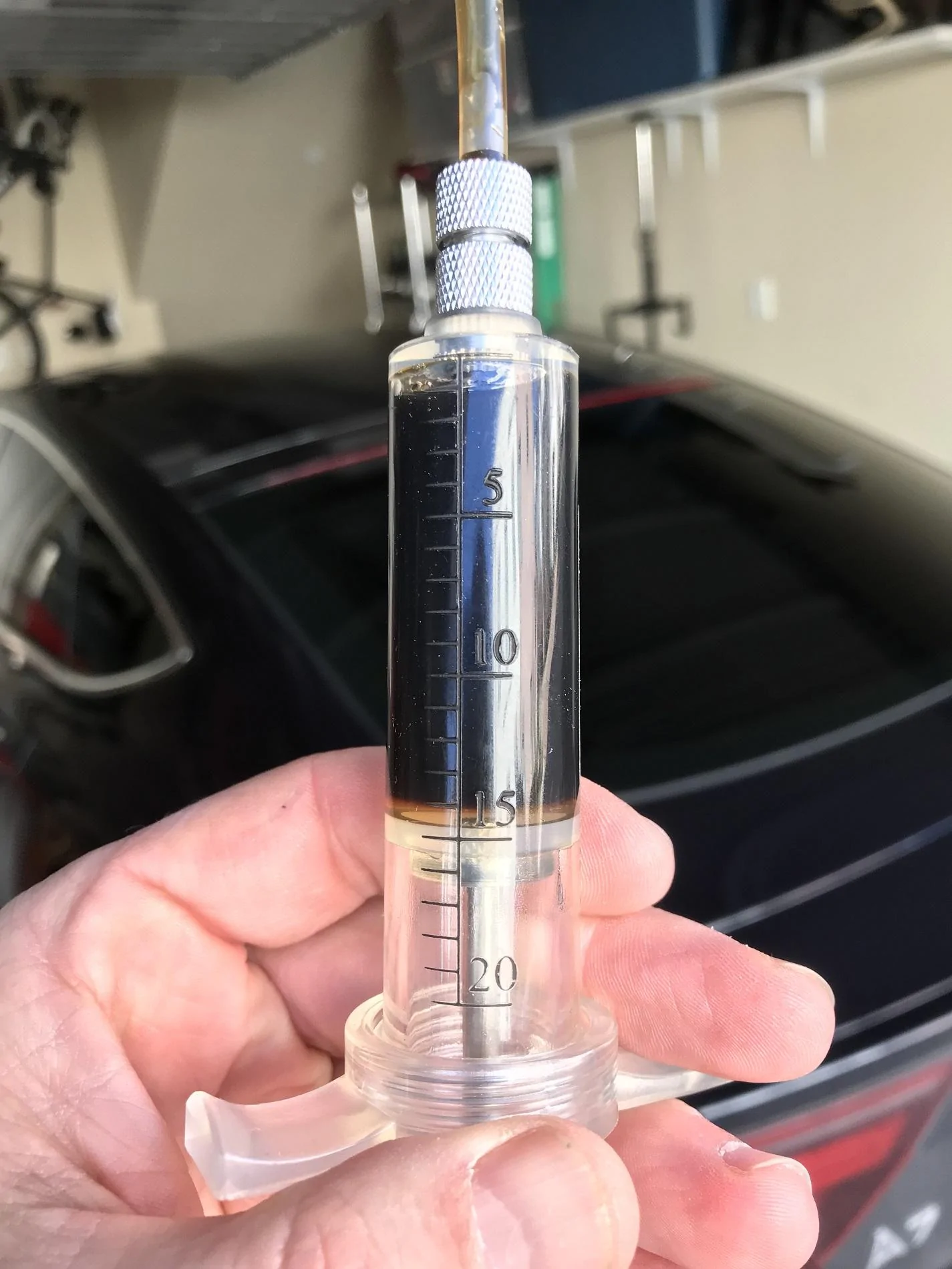

Checked the catch can today and the oil level at 6,200 miles. 782 miles since oil change. Oil is halfway down the hash marks. Right at 625 miles since catch can install. Removed 14.5 mL of fluid from the catch can today. So, normally at this point I would have needed to add 1 quart of oil. I'm sticking with the consumption has slowed.
