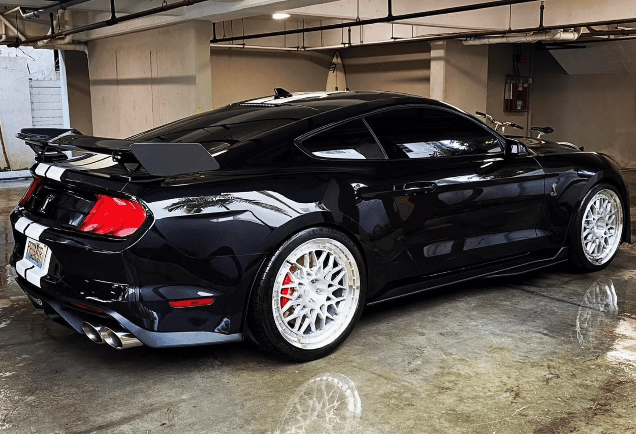

I was curious, found some sic GT500 wheels, but there a big offset difference. Will they fit a 2017 GT350?

You could maybe get away with the rears fitting with a little camber but I think the fronts would definitely not fit. Offset is super aggressive

It depends on the tires to a great extent. The fronts are 14mm or 9/16ths of an inch further out than the OEM GT350R front rims. Slap some wide tires on them with bulgy sidewalls and they'll probably hit the fender. Keep the tires narrower and they'll probably be fine. The rears are 11mm or 7/16ths of an inch further out than OEM GT350R rims, so the same situation as the front. Keep the sidewalls tucked in and it'll probably work. I say "probably" because it might not work.
