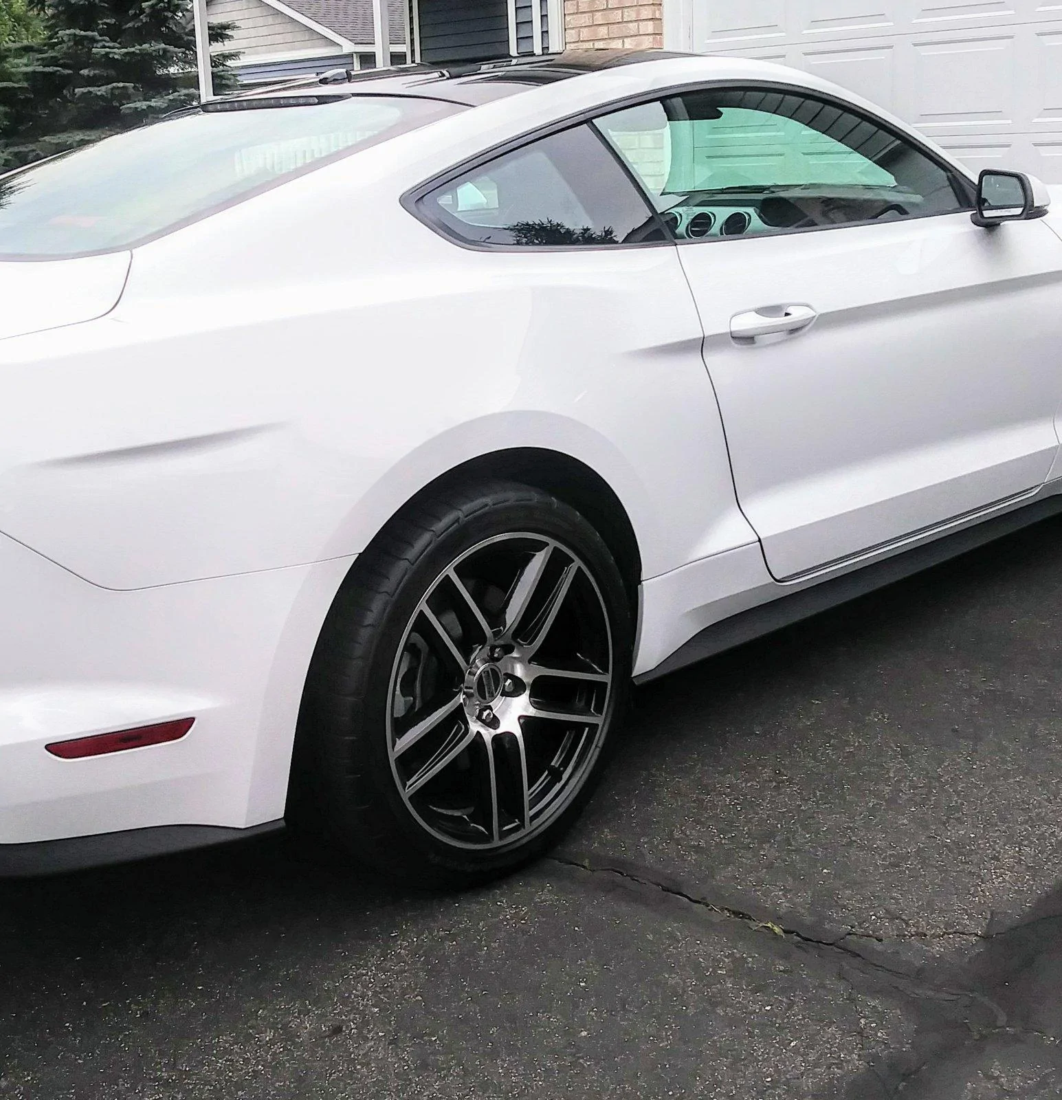

Here is a 19x10 with 47.5 offset and 285/35-19s.
