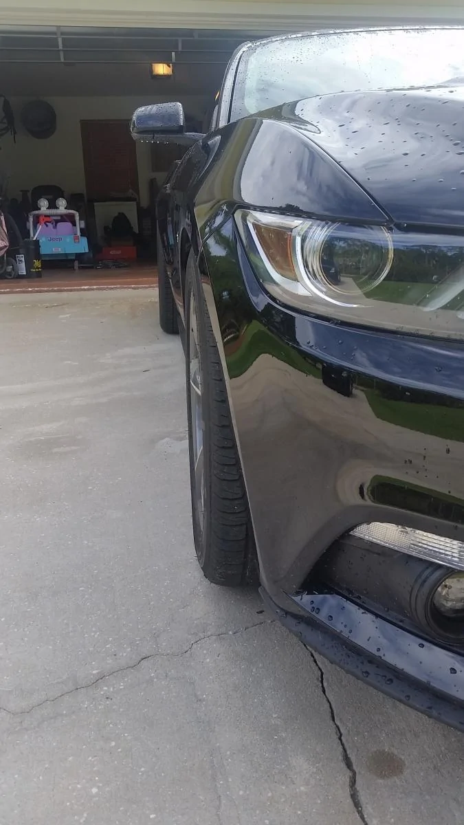

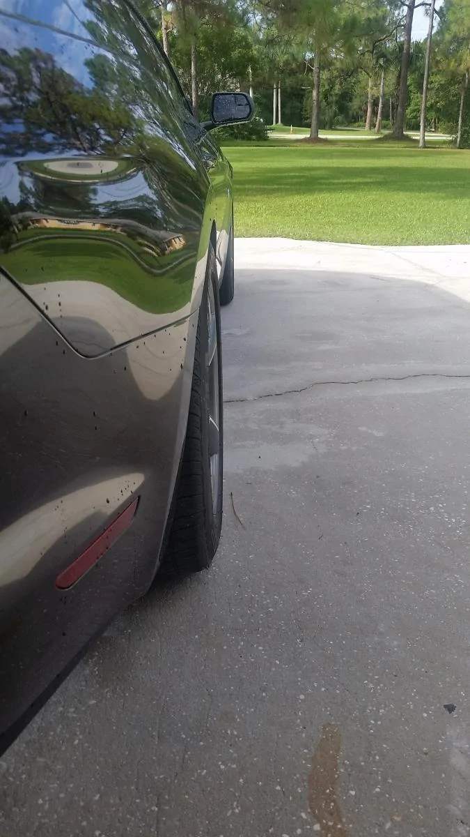

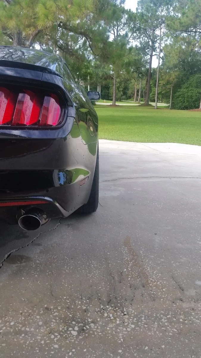

I can't seem to find what the offset is for the base 18" wheel with 235/50/18 tires...
My main question is in have a 16gt with sportlines and the wheels are to deep in the wheel wells and look bad in my opinion. As a quick cheap fix I'd like to add spacers to get them flush and maybe a hair more but I don't know what size I would need. Please help :/

If not mistaken its a 18x8 ET 48
Which means if you wanna make it flush you can do a 20-25 mm adapter all around easy.

I guess I'll go all out and give the 25mm a try. I was thinking since the stock tire is relatively flush with the wheel that I'd have to try like 10mm.

its pretty inset brotha so a 25 mm will help.
