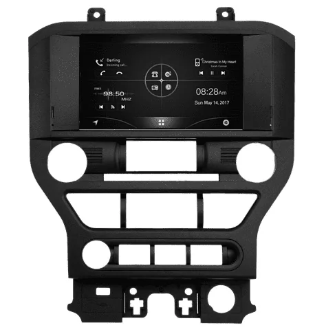

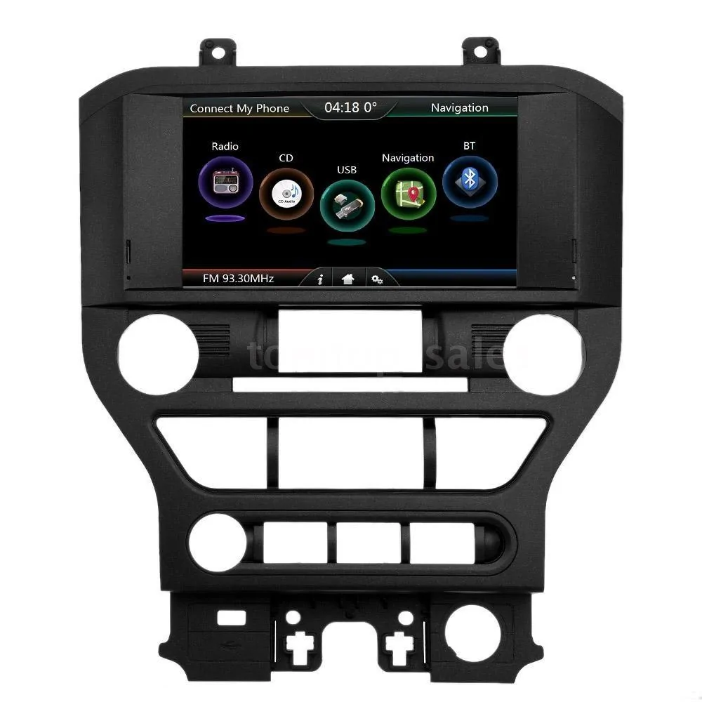

Kinda thinking the same thing...especially after hearing the "blinding" remark about the tesla style. I really took a good look at the console the other day and what I mean is I really focused and pictured the different screens...and along the lines of "blinding"; whilst the 10 would be impressive, I think it would be a bit overwhelming from day to day and the 8 would be better in that aspect. What I don't like about the 8 is that it is recessed and has those angled borders around the screen...I wish it was flat all the way across like the 10...oh well, can't have everything I suppose, lol.

I wonder if you picked up a toasted Tom top if you could switch the facia?
The faceplate is no different than the TomTop... Why would you want to do that?
TomTop:
8" Android unit
Same frame, just different hardware behind the scenes.
TomTop:
8" Android unit
guess it wasnt the tom top then, but one of those units i saw had a slightly different faceplate with chrome accents. looked kinda like the $800 raxium thing AM sells.
but ill be happy with the appearance of the 8 as shown
Chrome vinyl will make it look like the Moddiction.
