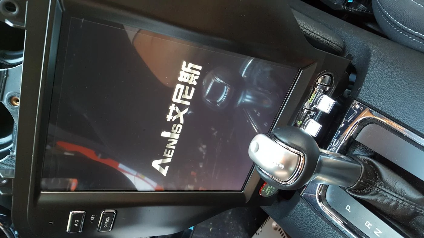

My only issue now is the front camera... cant seem to get it working :/
Update: I decided that the front camera isnt worth the hassle..
I had a lot of trouble getting the usb that is underneath the unit to stay working. The connection seemed very poor and loose so I had to improvise and melt the harness and then used electric tape to keep it snug. So far so good
The plastic is crap you have to bend it a little so its snug. once it latches it will stay.
It latched, I think. I put all the strength that god gave me to push this harness in and it still kept disconnecting. Anyway, its working now... one other thing is that the hazard button is kinda sticky. It doesnt toggle back to its neutral position after I push it. So I have to push up and down on it
