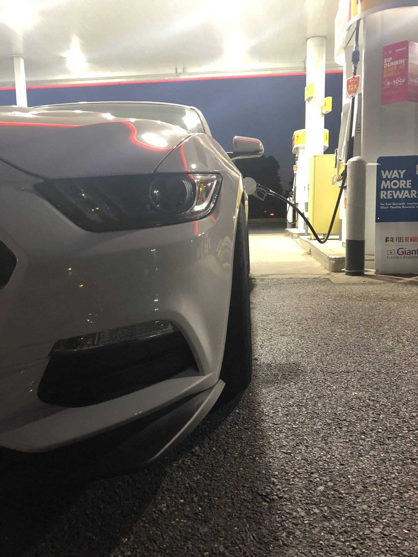

At least a 20mm. That depends on the tire you use though. I have 19x11 ec-7’s with 20mm spacers and 285’s. Clears the strut by a few mm and is pretty flush with -1.7* camber. Run anything wider and you’ll need at least a 25mm spacer to clear the strut.

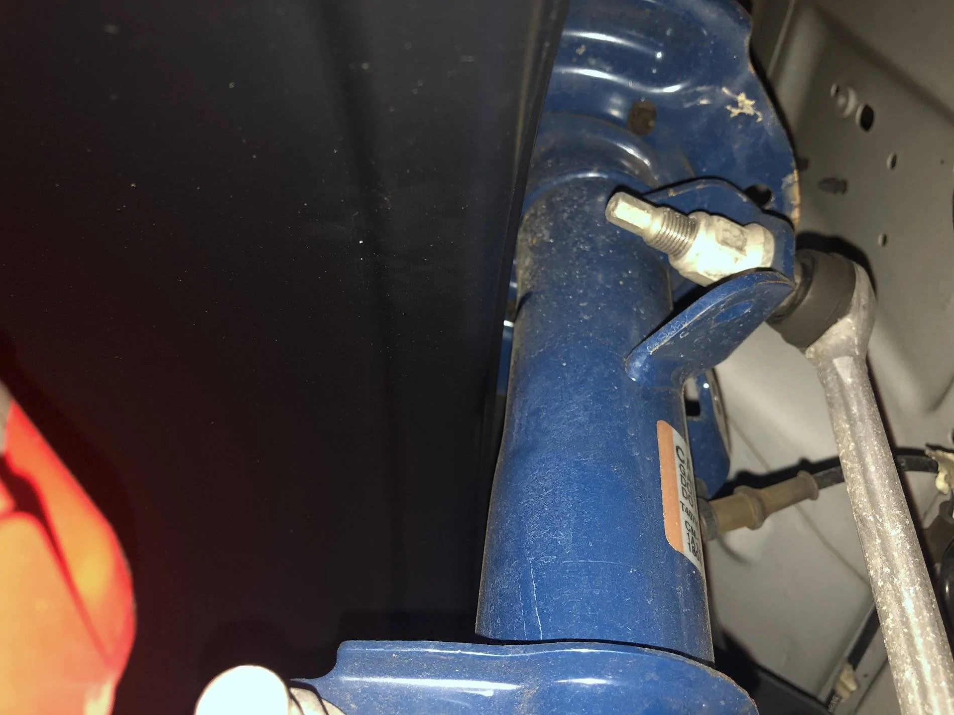

Do you have camber bolts in your struts? That would bring the strut closer to the wheel. Judging by your pics, I'll need the 25mm spacer. Being an 18 (instead of your 19) will bring it closer to the strut and I've got Magnaride shocks/struts, which are a little bigger. I'll be running 285's as well, so that's no different.
It looks sick on the car, though.
I do not have camber bolts. The camber I have is just the natural amount from lowering the car an inch. When I do eventually hit the track, I’ll pick up some cc plates, then get some bigger spacers so I can run bigger tires

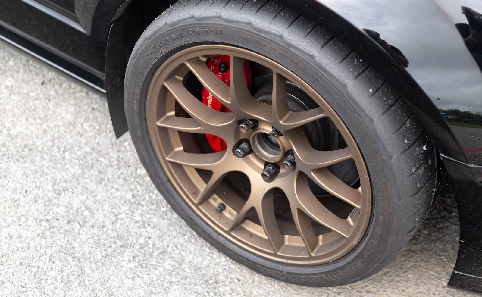

Some 3v action from Summit Point Motorsports Park a few weeks ago. I'll always have a soft spot for these cars. This ultra clean example is rocking our 18x11" square setup wrapped in 315/30-18 BFG Rival S tires with a 25mm spacer and extended studs up front.
- Cory
