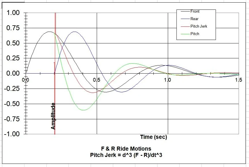

Bounciness tends to be a case of not enough damping (and more about rear shock damping), so I'm betting that just changing the dampers would clear this up. One reason you notice this more at 25 or 30 than you do at 50 - 75 is because OE "flat ride" tuning is typically aimed at keeping bounce out of the higher speed ranges of normal driving.
At 65 mph, OE springs and damping might graph out something like this first plot. The red and green traces are what you want to be mainly concerned with, and the "flatter" those lines are, the less you're going to notice any bounce.

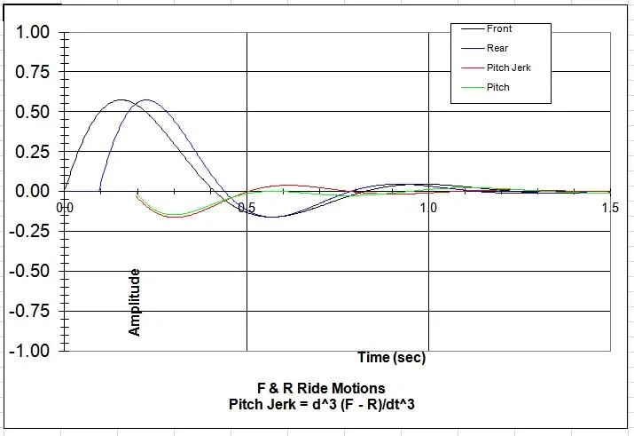

Now down at 30 mph and changing nothing but the speed. The red and green traces are "busier" between 0.5 second and 1.0 second than they were in the 65 mph case.

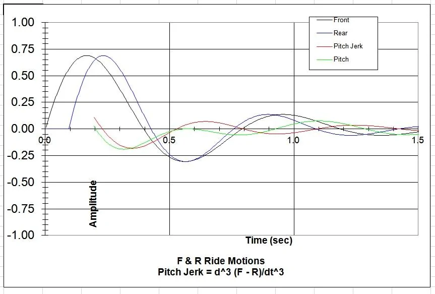

Running the damping up a bit (shown here at 65) really quiets the 'pitch' things down.
