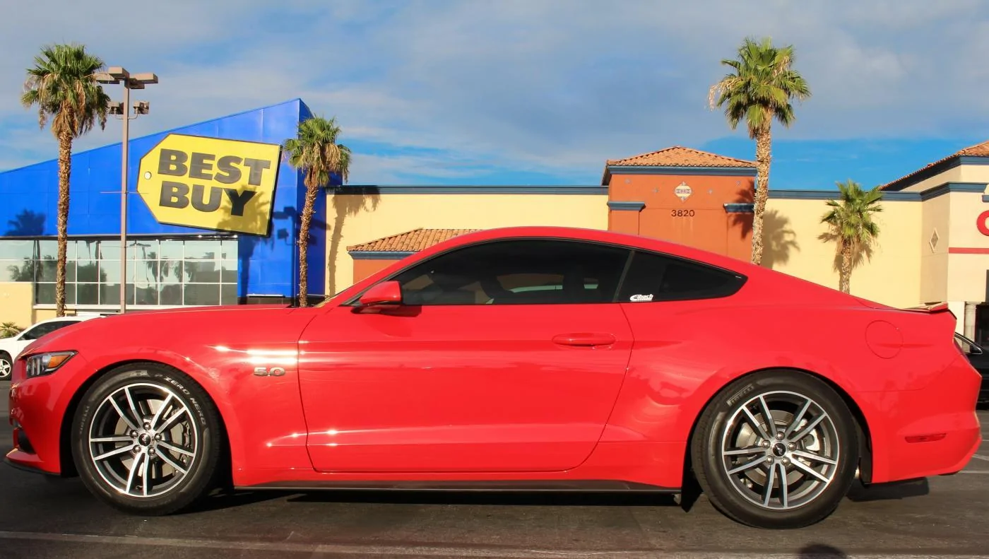

I'm looking for a drop such as this, and I have 19" wheels with 265/45 and 285/35. I would just get sportlines and call it a day, but I read the the negative camber is excessive and is bad for handling/launching?
