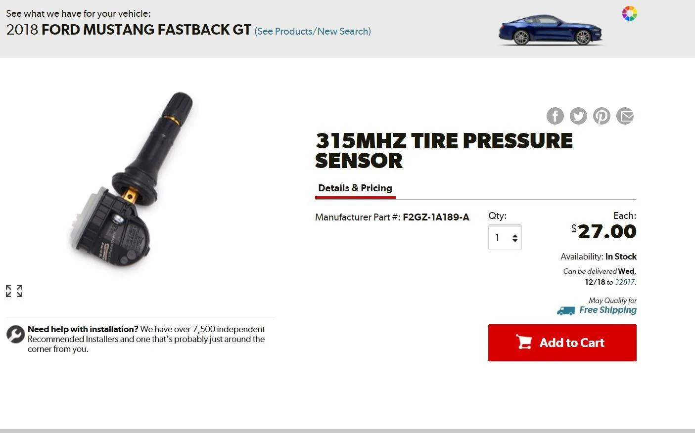

The guy at my local ford parts department must be on the spectrum. The website shows 3 different ones for my VIN (one says 350R lol).
Anyways, I called with my VIN (18 GT) and he said the part number I need is F2GZ-1A189-A (amazon part#) but on ford.parts it says that usage is 8/18/14 and the 15-20 is the one you shared so honestly I have no idea and will just tell the shop to make sure the first one works before mounting all 4 lol.

At this point, I just trust the tire rack website lol, shows the F2GZ ones for a specific 18 GT non PP1/PP2 car.

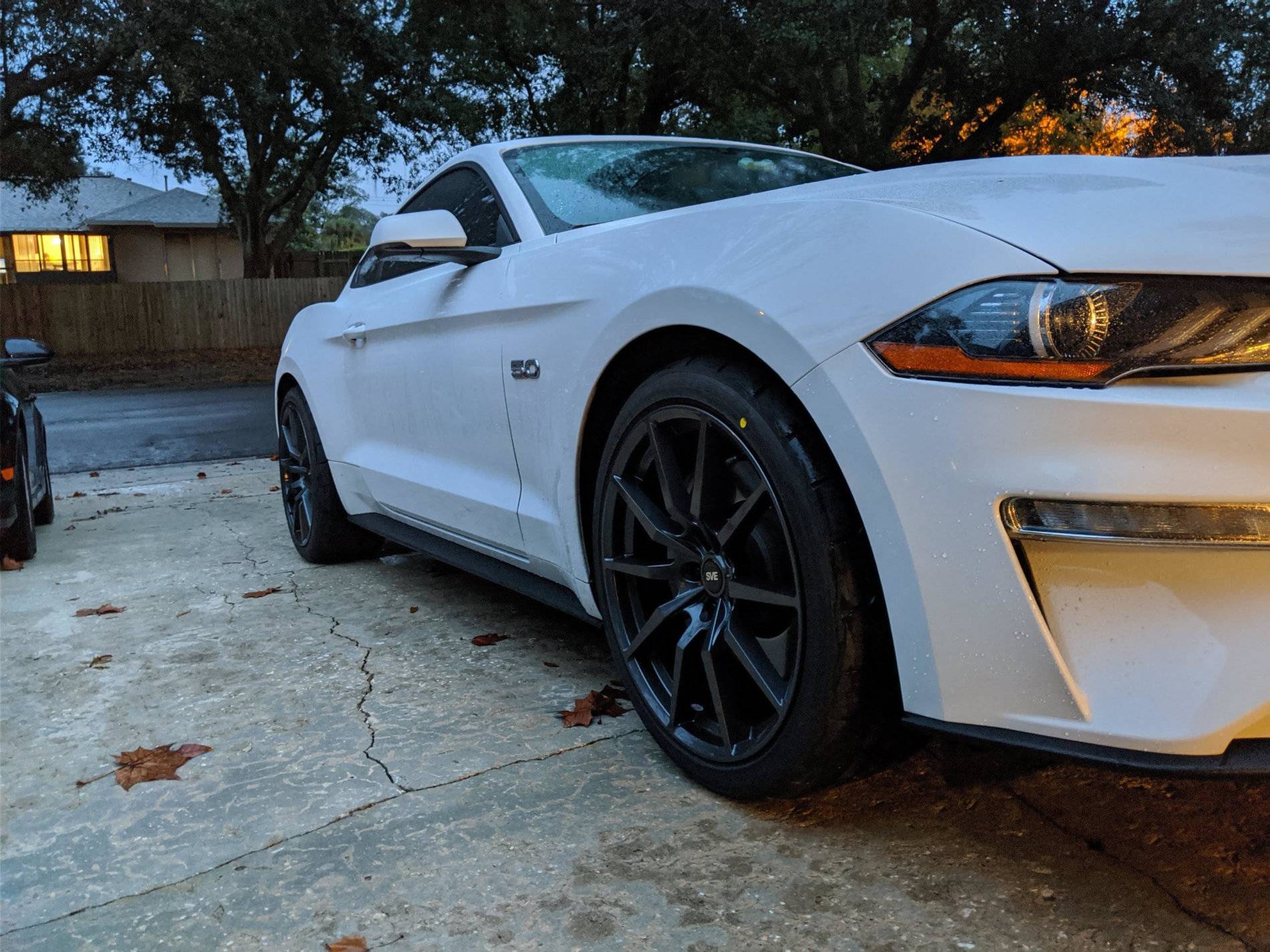

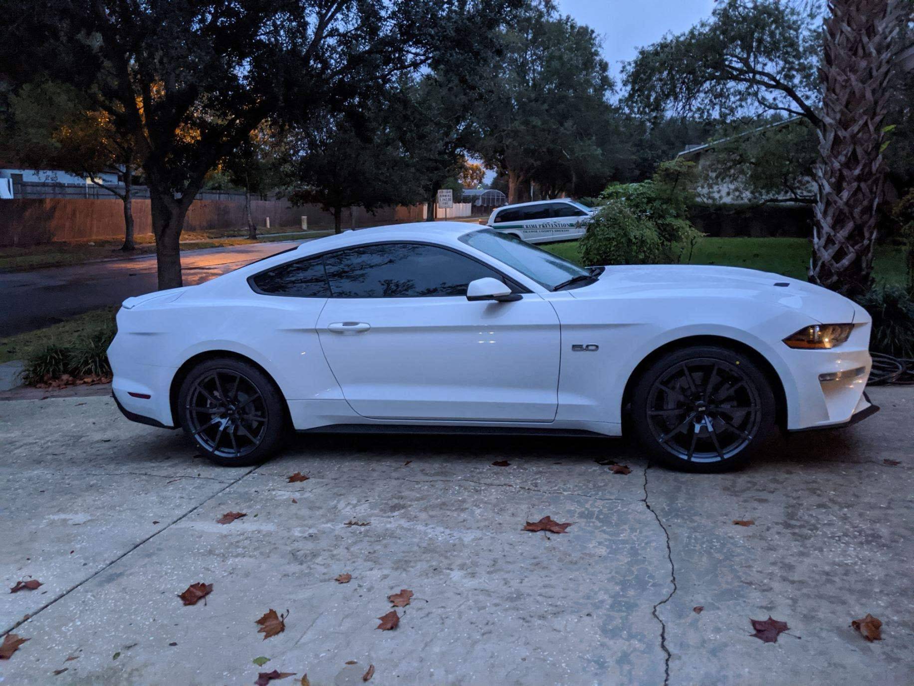

They work! Sorry for the bad lighting and rainy evening in Florida pictures.
