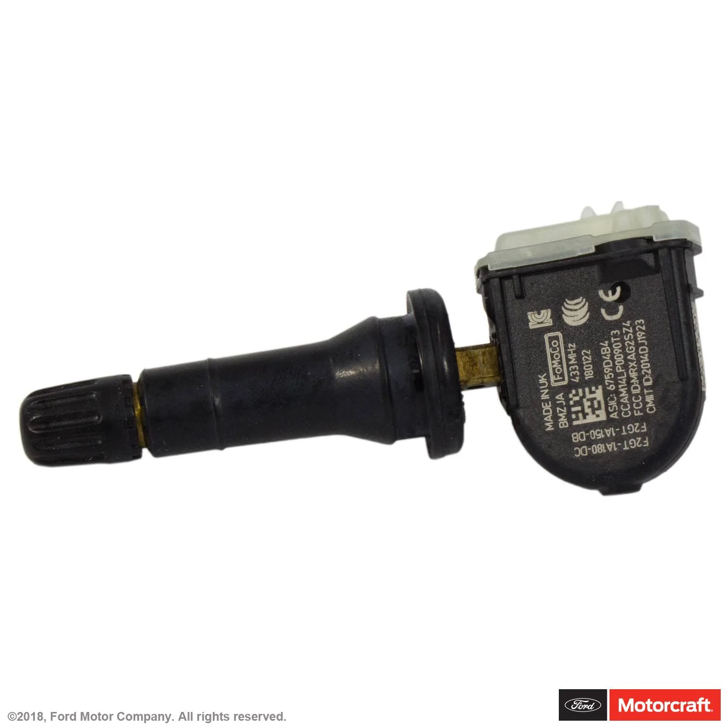

So I just ordered my set of 20x10 SVE350 Graphite Wheels for Black Friday. I need to snag some TPMS Sensors. I can get the ford OEM with the activation clicker for 155 on Amazon but I see there are a lot of cheaper aftermarket brands. Are these a popular replacement or something most people stick with FoMOCO parts for?

i got mine on amazon there ford but no clicker they set themselves after driving for about 5 miles think i paid like 100 bucks for 4. and they have been on the car for about 4 months never a issue and there spot on pressure wise

I buy OEM TPMS sensors from Levittown Ford ( forum sponsor ) . I have 3 sets of wheels and never needed the clicker. I always worry on Amazon about getting counterfeit parts . I think they were 120 for the set, worth it not to get junk.

I bought part number F2GT-1A189-AB off eBay. No issues, and much cheaper than elsewhere. The seller I got mine from has them listed for $44.95 for four OEM sensors. They were real Ford parts and have worked well.

So those say 2015-17, do we know if that matters?

Just looked them up on Rock Auto and it looks like a 2018 GT uses the same sensors.

I ended up going with the set from amazon for 46 bucks. Same serial and part# as Rock Auto OEM 18's. Will chime in after the 20" SVE350's and tires are installed.

How do you know what frequency to get? I have seen 315,433 and 868 MHz I think used by Ford for their TPMS sensors. I have a new set of wheels on their way and would like to know how to k ow you will get a set that will work.

Everything ive seen is the 315 I think..
Some will auto learn in a couple miles, some is your steps.

I bought part number F2GT-1A189-AB off eBay. No issues, and much cheaper than elsewhere. The seller I got mine from has them listed for $44.95 for four OEM sensors. They looked like Ford parts and have worked well.
Same here..Ford part #s and great price...no issues here in over 2 yrs.
